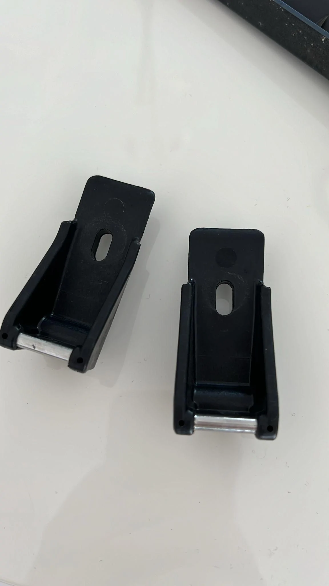

I have had the tailgate brackets on order since August and still haven’t not received them this is crazy.
#M2DZ 78515A54C
edit*
can anyone confirm if the part number above is the bracket in this image below?

Does anyone have the two tailgate latches for a soft top from a dual top bronco available? I need these 2 brackets to convert from a hard top to a soft top.
Thanks
Part number M2DZ-78515A54-C. Or (B)

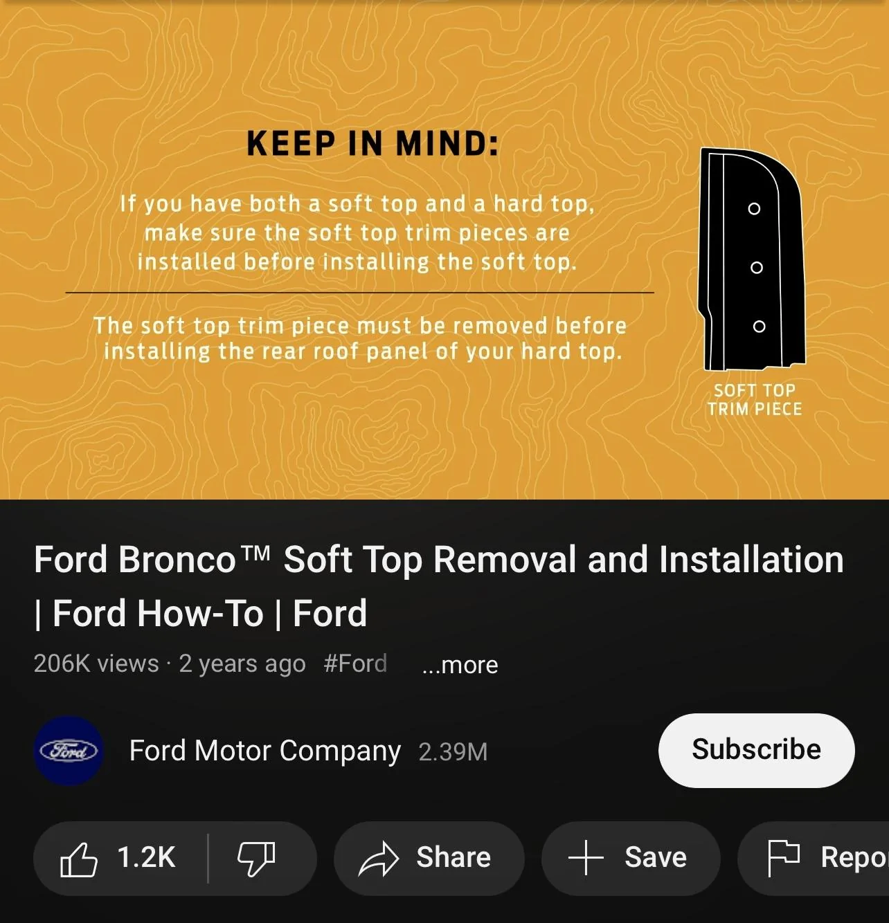

I’m going to leave the C pillar trim from my soft top on based on the posts from everyone. Sounds like it doesn’t interfere. But does anyone know why Ford says to remove them before installing the hard top?

I don't know if it's true for later dual top models but on my '21, they made contact. Maybe the shell was just "sprung" enough from manufacturing that it would push the sides out. Take the plates off and all was good. I've run the same top on the '21, '22 and current '23, all of which were originally soft tops.

Oh snap! Thank you Flip! Doesn’t hurt me to remove them so I’ll take them off. Better safe than sorry. Did you leave the bolts in the Bronco after you removed the trim?

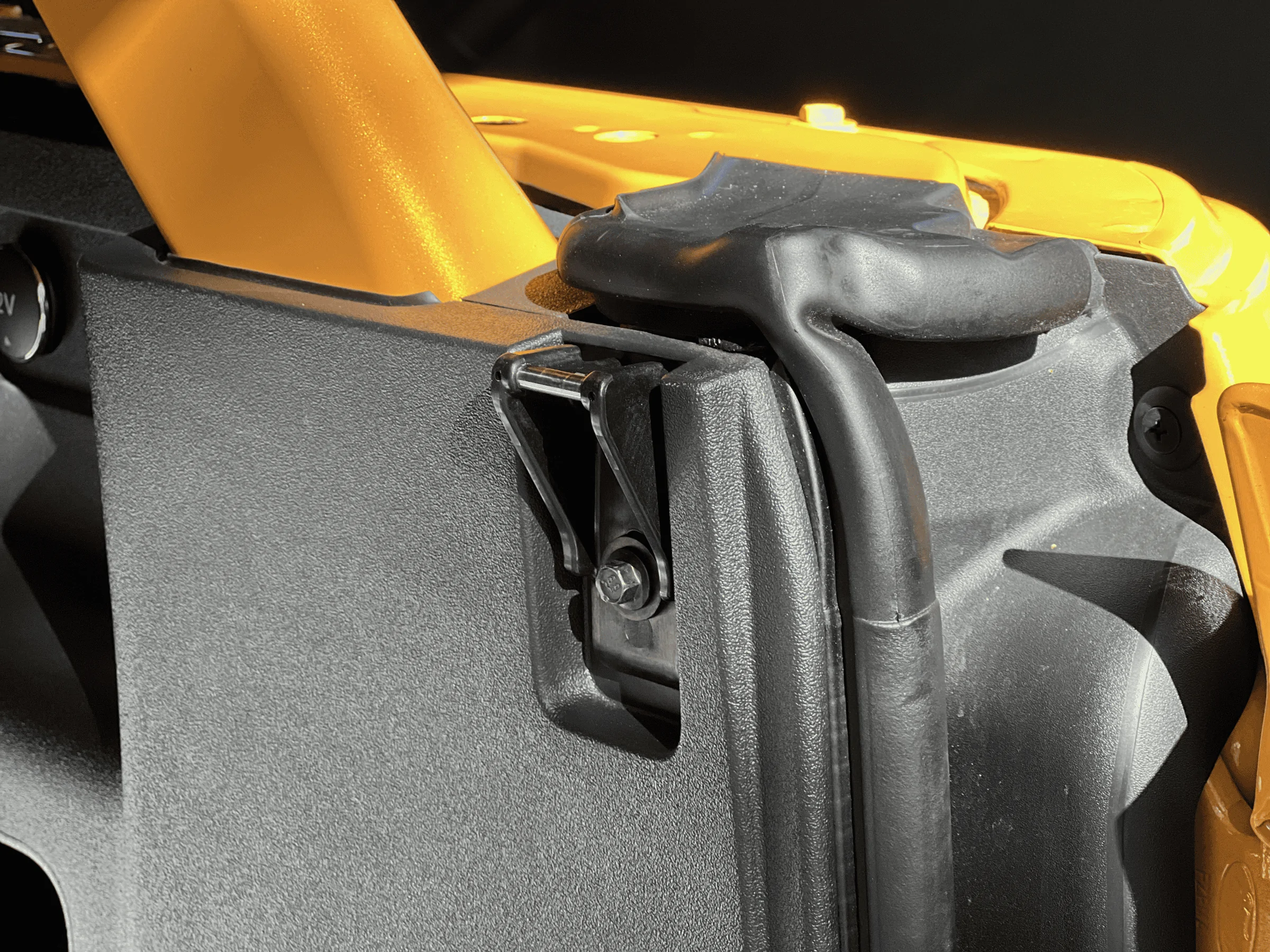

Hi All,
I’m desperate to find the rear cargo latch receivers and hoping someone can come in clutch, and they have these just laying around somewhere. I cannot believe how much ford is asking for these now. $1,000-$1,600 for this simple part!
https://www.fordpartsonsale.com/oem-parts/ford-receiver-m2dz78515a54d
Can anyone help? Thanks in advance!
Put them back in so I wouldn't lose. Soft top will go back on when it's time to sell.

No idea what the hell that is but there's a national stop sale and nearly 160 on back order. For that price I'd almost have to believe it includes the trim panels but wouldn't rule out their pricing is way off.
