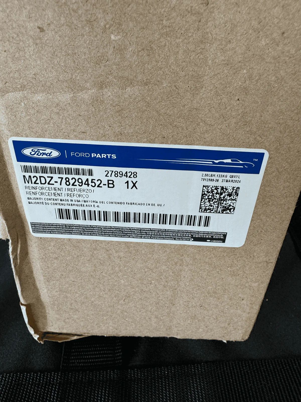

A Bit of an update on parts. I had order 2 of M2DZ-7829452-A and Ford shorted me one. So they placed the order again and M2DZ-7829452-B arrived.

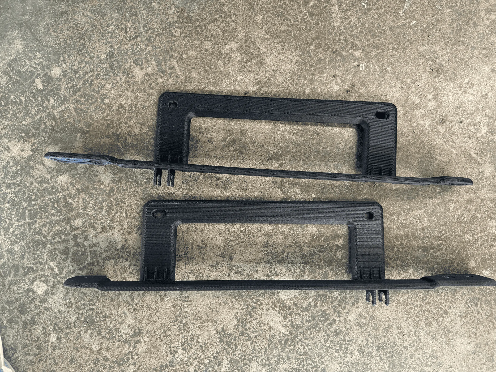

It looks like it is now a kit that include placement tools, screws, a centering pin, but it also includes 2 of the Quarter Panel Brackets... see pictures and included PDF of instructions.
The tools look to be centering installation tools. And are 3d printed.
Price for the kit was basically the same as just one of the brackets by itself. Dealer was able to return one bracket.

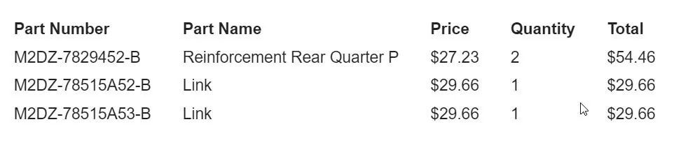

Anyone know the current status on the 4 brackets if you order from a Ford dealer? I know the rear latch receivers are $1340 LOL so I'm very happy that there is an after-market for $70, but am very curious if I'm going to be waiting months for the brackets that I just ordered.
Ford Bronco Soft Top <--> Hard Top Swap : Tips & Lessons Learned - UPDATED 1725236977523-tt
I contacted the lady that sold me the soft-top too, to see if she will take off brackets and latches for me. I didn't realize I needed those when I bought the soft-top from her for $200 brand new still on the shipping pallet. She's slow to respond so I probably won't find out for a few days if she has the dual-top Bronco, but she must if she had a soft-top sitting around in her carport. Also, she's 500 miles away from me so I can't just pop over there and take the parts off.

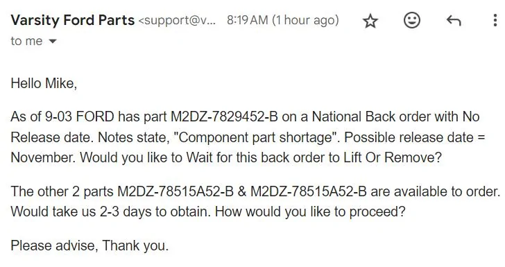

EDIT/UPDATE:
Heard back from Varsity Ford (yes she got one part # wrong but ignore that):

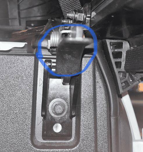

How was anyone able to get this part.....Brackets inside tailgate that back/bottom of top snap into
M2DB-S515A54-AE ......with out buying the whole frame assembly for $446??? I cant find just the Latch buy itself. Or is it just that much??
