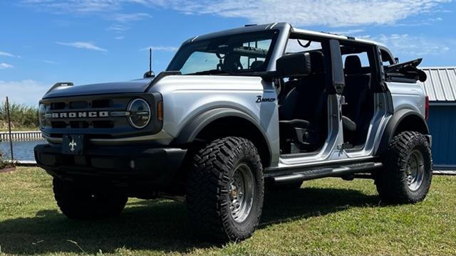

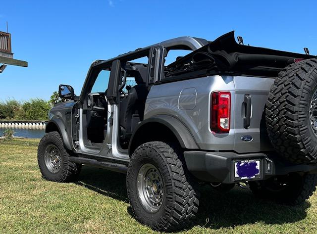

I put a 2" rough country lift (hockey pucks) on my non sas Big Bend. I am running 35's now and loving it.
They make a 2.5 inch lift that might work for you.
