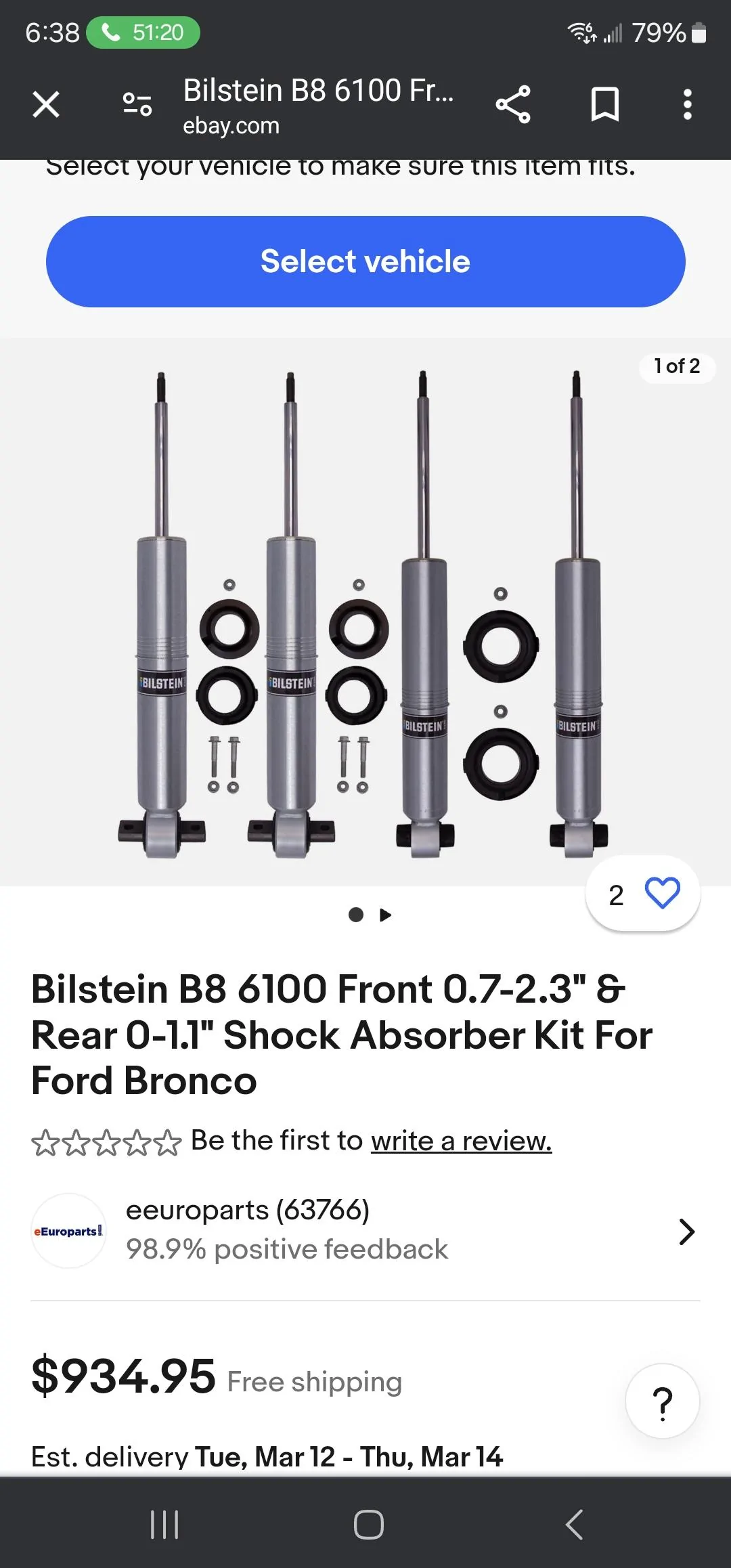

And if you are going to spend anywhere from $300-$600 on takeoffs, I'd say take a look at the Bilstein 6112's. Can find them for around $950, they work with your coil springs and are adjustable.
they are $2400 for a full set assembled :oops:

6112's?
You don't need fully assembled. Just the shocks, you reuse your springs.
Looking on ebay I can't find them. I had seen the 6100's (what I would need) for $950
Maybe I'm wrong but I assumed the 6112 reused the spring like the 6100's. If not, I'd look at other lift kits like Old Man Emu or something adter the experience I've had with Bilstein. But you can always just go with a Puck lift for cheap.

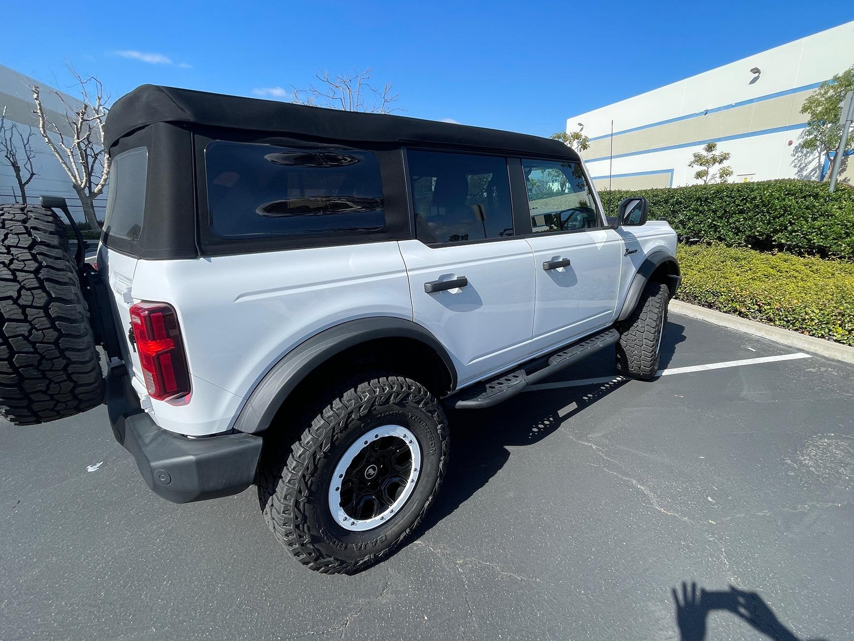

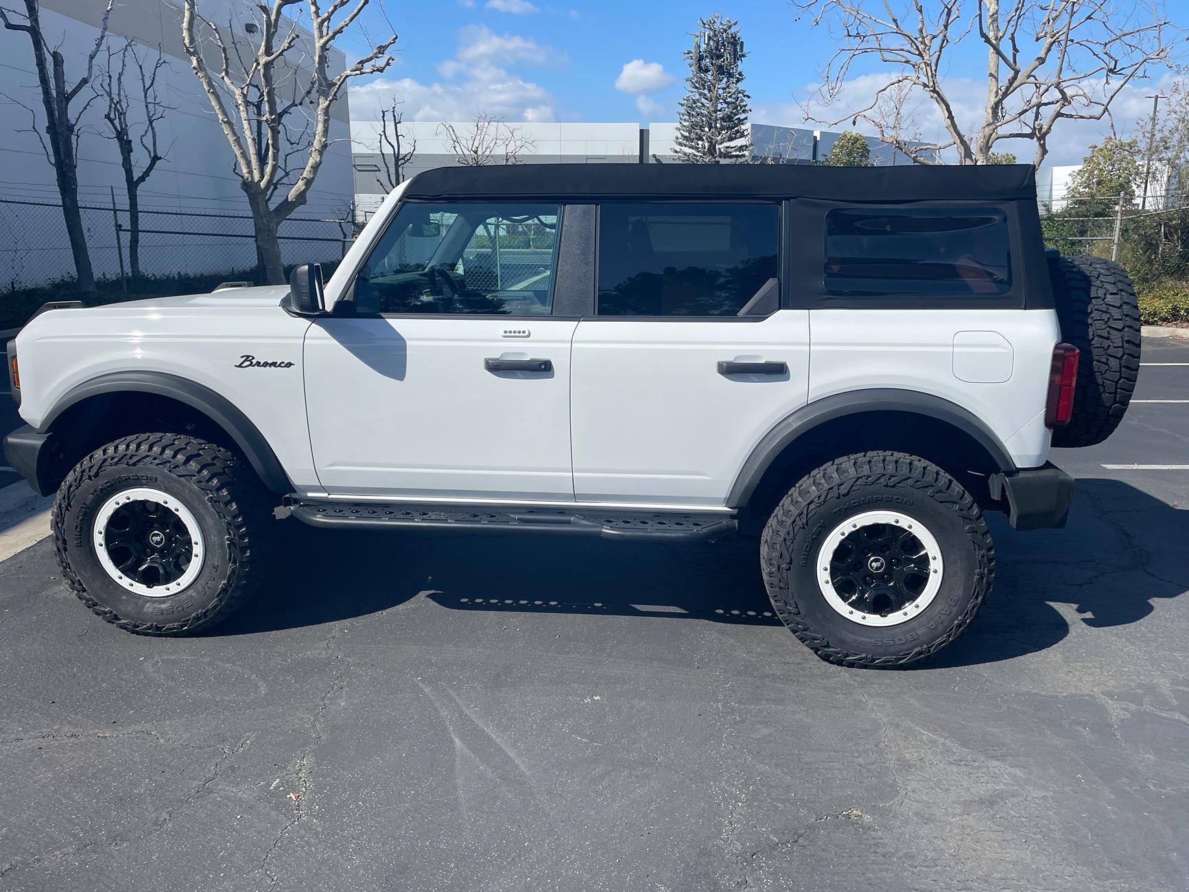

I just went with the 6112's and Icon front control arm on my non-sas Big Bend. It gave me 4.5" lifts when adding 35" MT Baja Boss tires over the old 33".
LOOKS GREAT!!!
