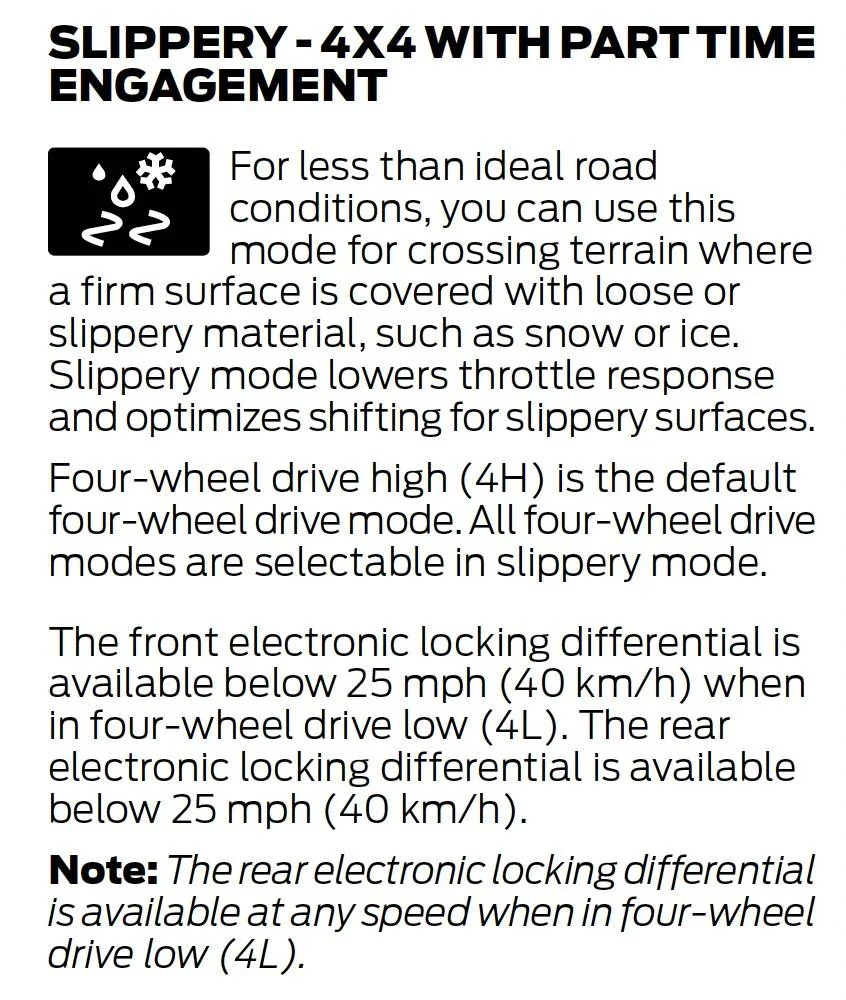

Drove in rain for the first time today. I’m new to part-time 4WD vehicles, so I apologize if this is a stupid question. I know I shouldn’t run the vehicle in 4H just because it’s raining (since turning on pavement in 4wd is discouraged). My question is, does enabling slippery mode and switching to 2H when it’s raining offer any advantages over simply driving in normal or eco mode? I know I have traction control regardless of GOAT mode, but I wasn’t sure what else goes on behind the scenes in slippery mode.
UPDATE: Sorry for the confusion, but I do not have 4A. My choices are 2H, 4H, and 4L.

I suspect (but can't prove it fully) that traction control does perform differently in slippery (vs eco/sport/etc). I have only used slippery in 4H in my F-150, but it was radically different from 4H sport mode.

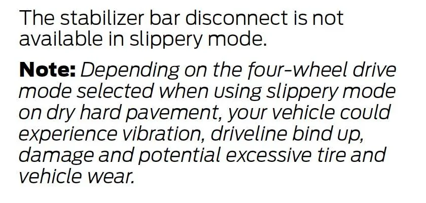

The only thing you can do to improve safety in rain is to drive slower. Someone else said you can is 4H in rain. Do not do this, do not listen to that person, never use 4H on pavement unless its glazed over with ice or snow.

When it’s slick, yes some people lose their minds. I followed a full size Chevy truck up a hill on asphalt (chip and seal) this afternoon shortly after it rained and Just maintaining speed at about 50 mph the back end almost came around on him. If you’ve never experienced how slick it can be, you don’t know. The guardrail in that same stretch of asphalt has been replaced about 20 times or more in the 20 years. I’ve been here. 4H or AWD makes all the difference in how planted a vehicle feels in rain. But can also make someone over confident.
