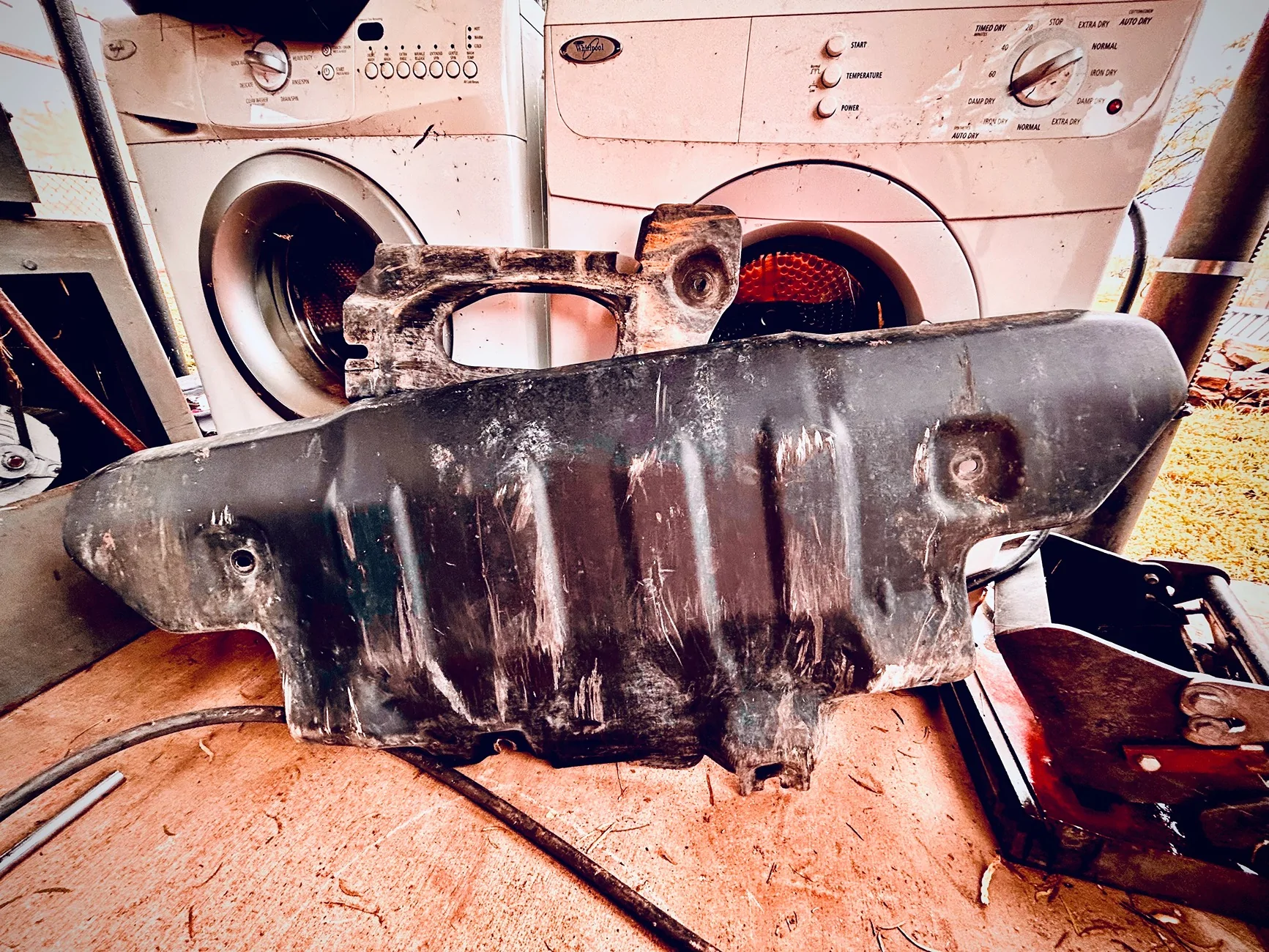

For anyone looking for a decent set of skid plates that won't be challenging anything, go OEM. It's cheap and they work well enough. I whacked mine pretty hard many times before replacing and they stood up just fine. If you have the gas tank skid already, you can probably sell the spare easily enough. The aftermarket there isn't great.

I dunno, people talk about "thin" but honestly most people don't need structural strength, they just need the rock not to rip into their shit. The OEM does that just fine and it's not that expensive. YMMV.

here's my redneck 2 cents - people should know if they need MORE than the ford skids. if yall's wheeling spots have decent sized fixed rocks that the bronco literally lands on, probably need something more substantial. if it is just incidental contact with crap then ford is probably fine. I was out with a buddy with a badlands yesterday and the ford gas tank skid is pretty solid. he gouged the crap out of it and it held up fine. However, had that rock been on his centerline I'd be concerned.
Short version, if you end up bashing rocks buy something else. but you know when you're into the shit, if you aint, ford should suffice
