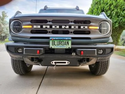

Follow up: I did install the factory steel engine/front axle plate in lieu of the stock plastic one and installed a Ford transfer case plate with a homemade brace for under $200. I retained the plastic front 'bash plate' with my Blue Ox tow bar mounts in lieu of the factory tow loops, tow loops could be retained however.
I have since installed the Rough Country Hidden winch mount which comes with a nifty bash plate/fairlead mount. I had to modify the RC bash plate a bit for my Bule Ox set up but would work without mod with the tow loops. I also mounted sections cut from the stock plastic plate to fill outboard of the RC plate.
I had stated before that there was nothing important behind the stock plastic bash plate. But in fact the intercooler does hang down below the bumper a bit and I have seen photos of it getting trail damage. So I guess I'm glad to now have a metal plate.

Appreciate the update! The RC bash & hidden winch mount looks great.
