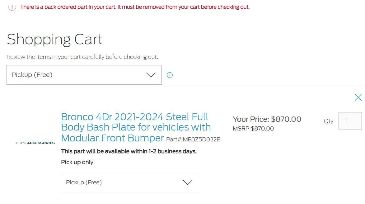

Bummer!!! Back order, can't do it!

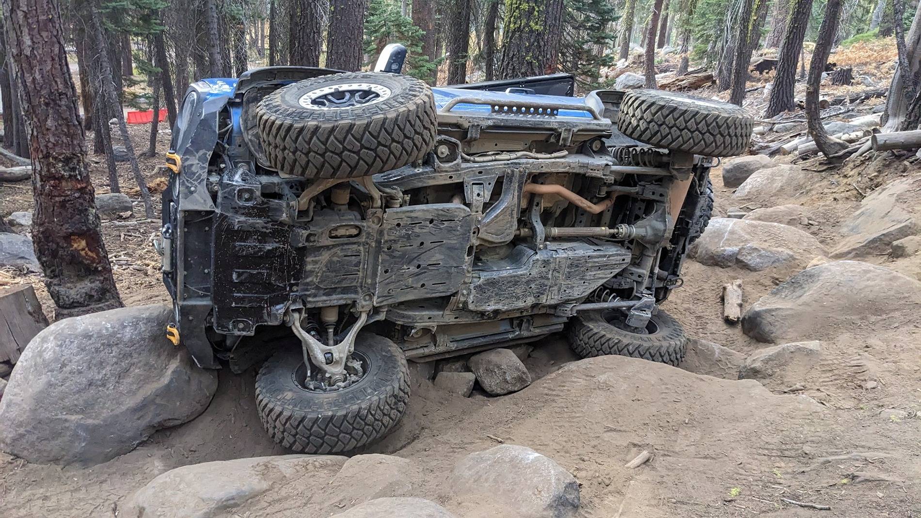

Check local classifieds for an OEM bash plate and engine skid, people take off perfectly good skids all the time for upgrades. Then buy whatever flavor of trans skid that tickles your fancy.
Here's a great view of my skids, all OEM except the trans which is a cheap Mabett and the DV8 shock skids. That's the essential set, you can get LCA and diff skids but they are a waste IMO. These will get you through 7 rated trails all day.

25% off (652.50) is a great price ,since cost is $609 -- since i work at a dealer i ordered one beginning of Oct,cost plus 10% =669.

That picture was without/ before the discount.
