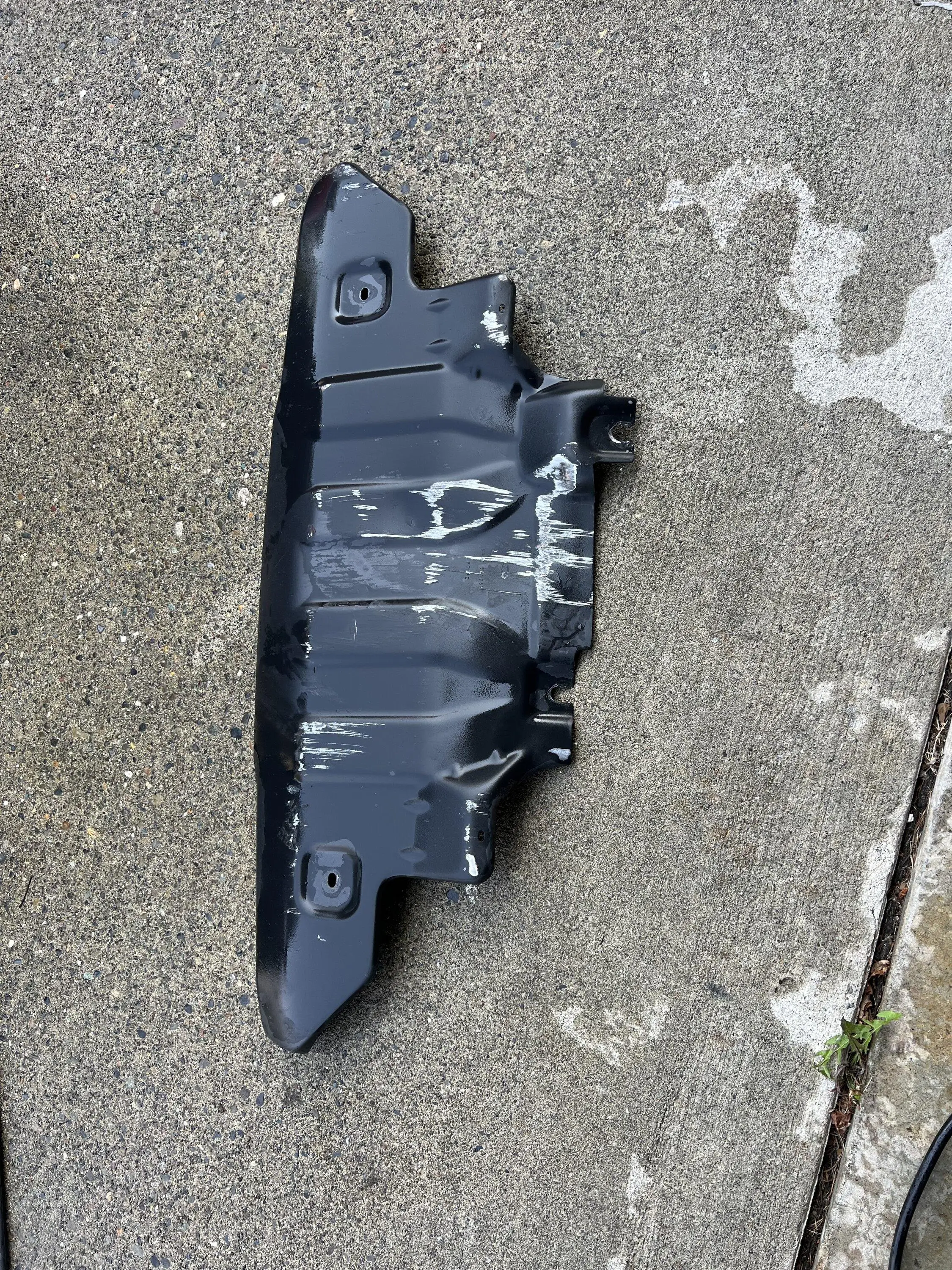

It's missing the 2 bolts (red) that tie it to the front bumper. And I dented the brackets behind the green circled bolts before punching a hole in the factory plastic skid. I wouldn't call this an improvement, most likely going to damage the intercooler if you hit something to hard.
Fyi- The factory steel skid does not use the two front bolt locations like the stock plastic one. It only uses the middle and back pairs.
Yes and when the middle brackets fold you get a nice dented intercooler. If your buying a skid plate don't you want it to work?

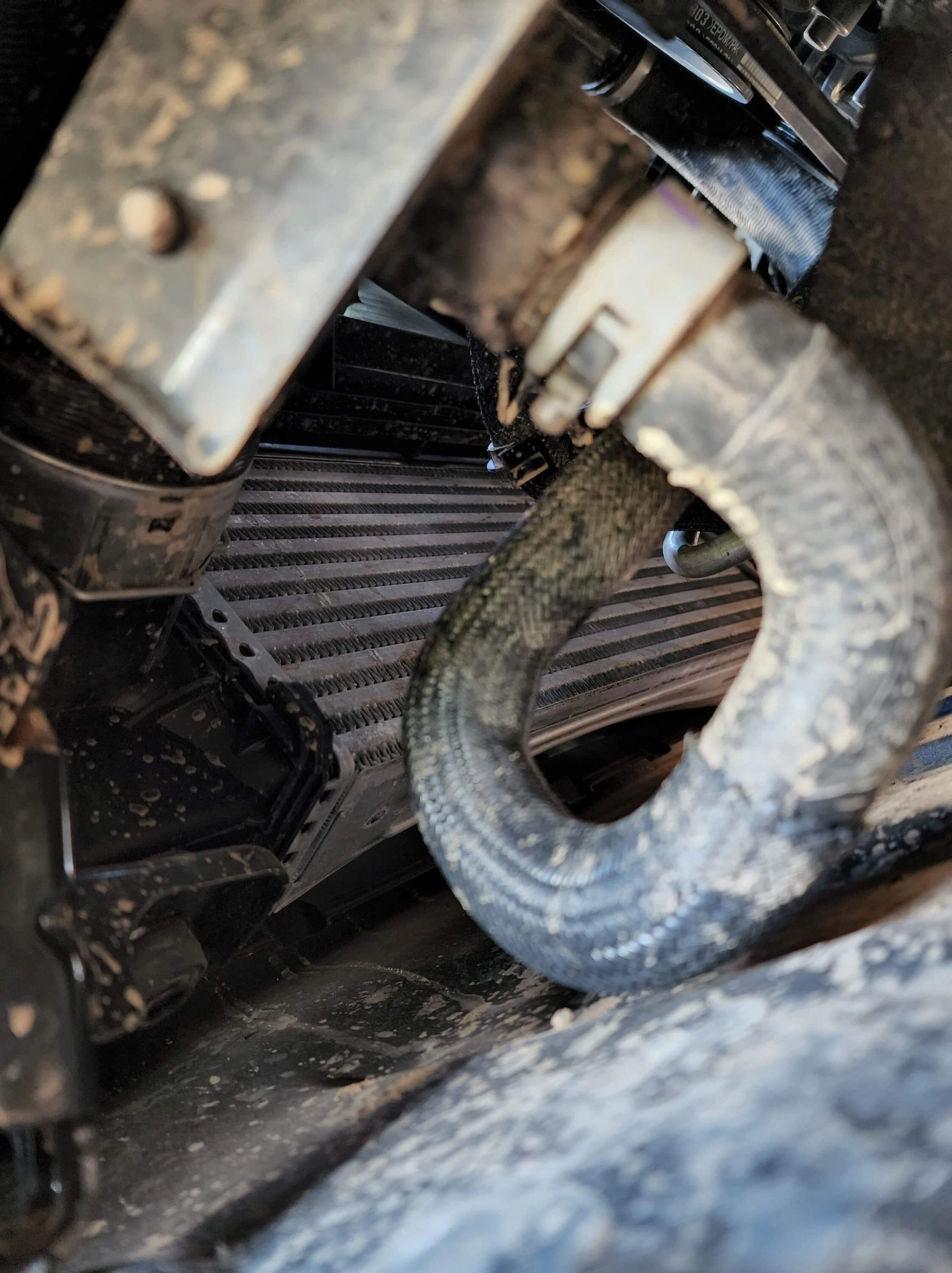

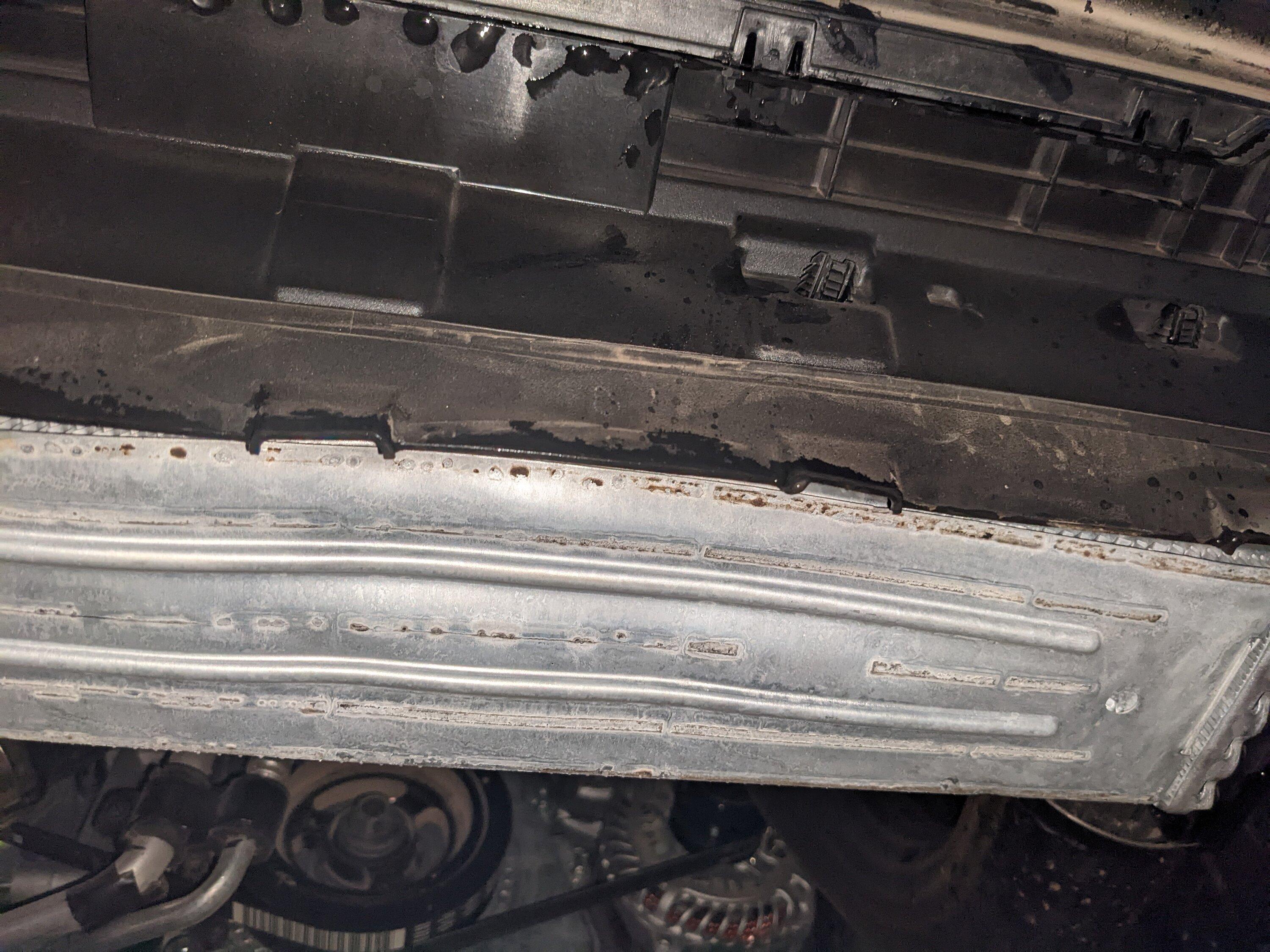

Metalcloak doesn't have/come with a bash plate, I was running the factory plastic skid. I am also not sure when I dented my intercooler, the middle front skid plate brackets crunched in. Wish I took a picture... I only found out after I tore a hole in the plastic skid and took it off to melt the hole closed.
Ford Bronco Amazon Skid Plate 1664375920365
To stay on topic, the green mounting points are weaker than the factory plastic skid. When they crumple you will damage your intercooler that is why the red mounting points are so important.
