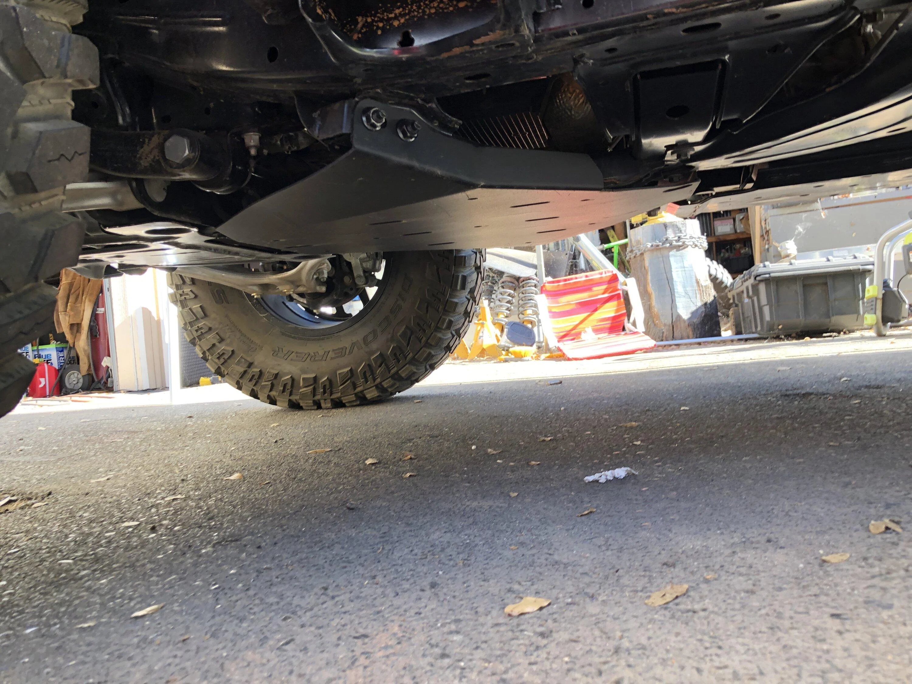

I installed the LOD transmission skid. Works fine with the stock skids. Replaces the sway bar skid on the Badlands. A few months it was the only one on the market. I am sure something else has hit the market.

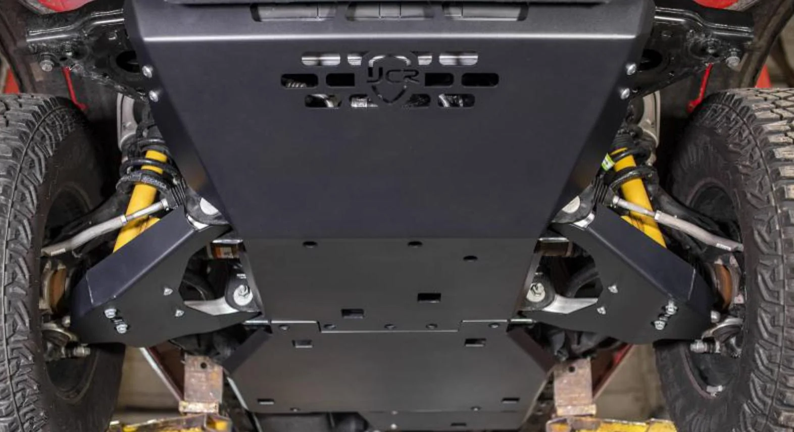

JCR does.. If it doesn't someone please tell me because I'm about to buy them :)

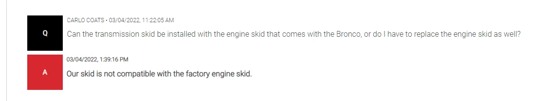

I almost ordered the JCR today until I saw this in the FAQ.

To clarify - they say this transmission skid does NOT work with OEM stock skid.

It fit my 21 Badlands 2.7 auto perfect with factory skids. 15 minutes to install no modifications at all. Covers from sway bar to transmission cross member.

LOD mounts to the V6 support bars so make sure you don't have a 4 cylinder or your in for issues.
I have seen the above Bronco in person and would trust the skid, just wish it mounted and covered the transmission cross brace more.
Thanks but I think that's expected. Unlike many other systems, there's comes with the front engine skid so of course you would not be able to put it over top of any existing.
In my case I don't even have one, except maybe that plastic air dam. The only thing I don't like is that I lose my front recovery points because they replace the brackets. However I'll be buying a front winch bumper soon as well and that will have recovery points.
