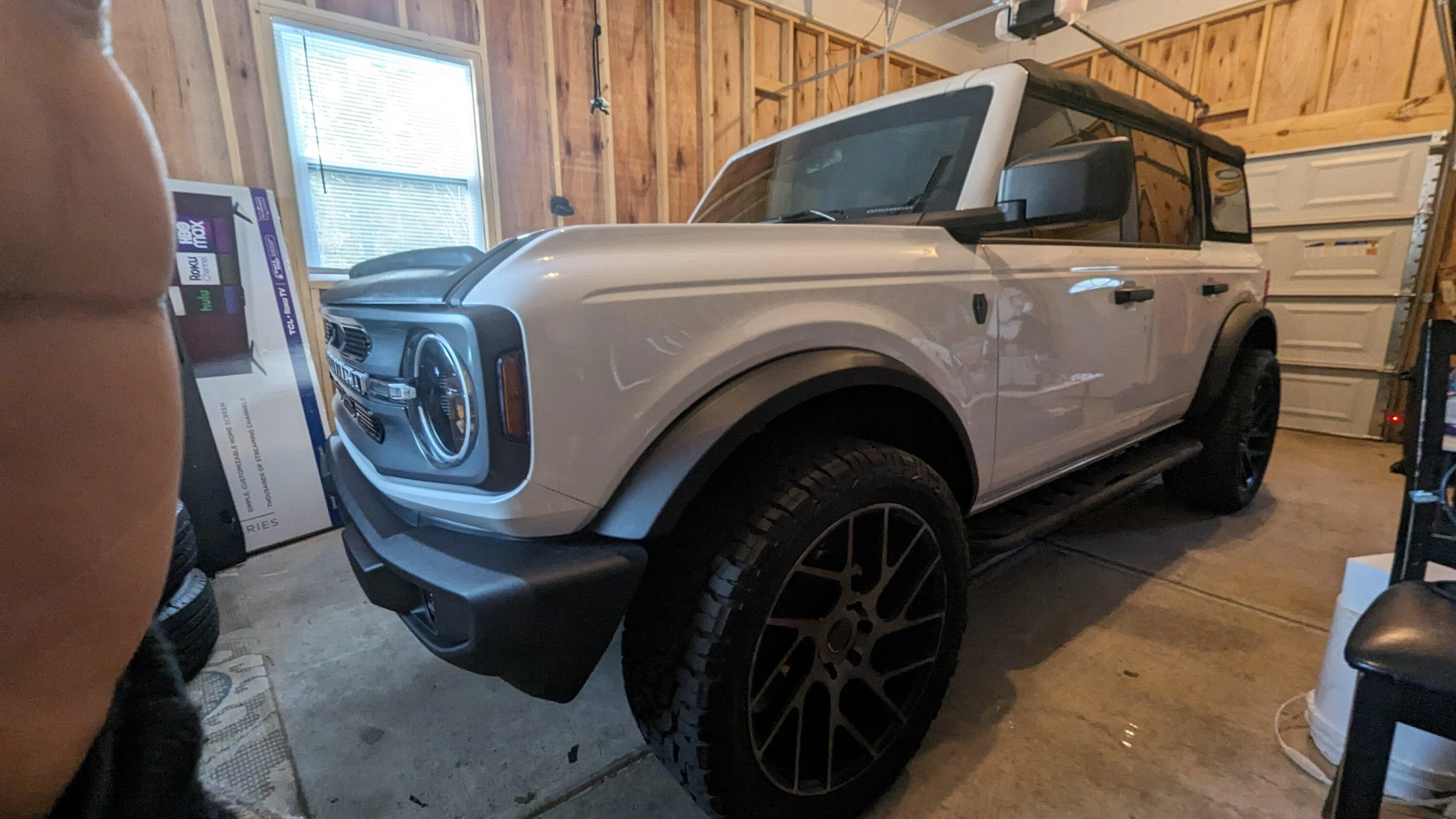

Here's my truck with the 35x12.5x17 on 17x9 -6 offset wheels. Your tire would be 1" narrower so 1/2" less poke and the 0 offset would be another 1/4" in so that would be 3/4" less poke than mine. My tires stick out 1-3/4" past the flare so you would still stick out 1" past the Sas flares like I have.

There is some spray but not as bad as I thought it would be. I do have some mud flaps up front and my truck has the hoop steps which actually block a lot of spray/debris.

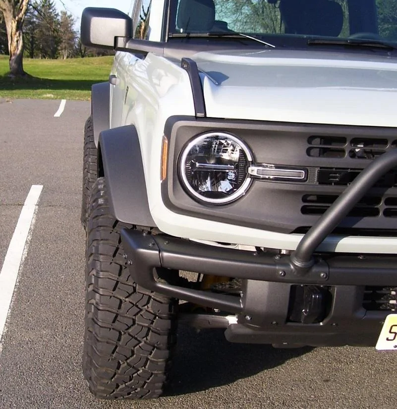

17x9.0 -25 non-sas fender
With that being -25 offset, the 0 offset would be around an inch more inward than this but that should give a good idea that the 0 will still poke a bit.

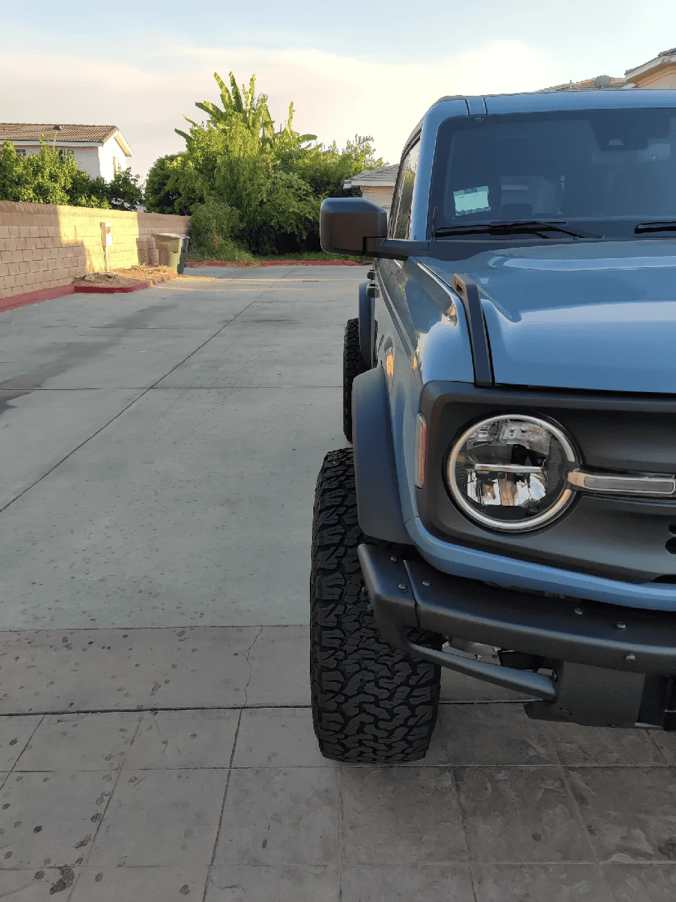

Zero offset KMC wheels, stock tires on Raptor. Just about what I wanted for poke.

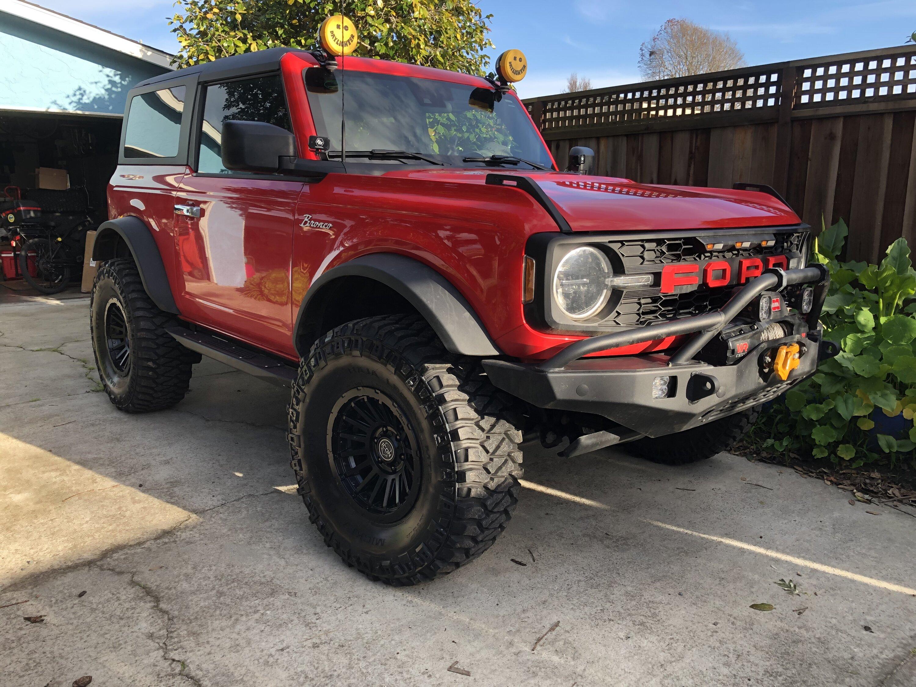

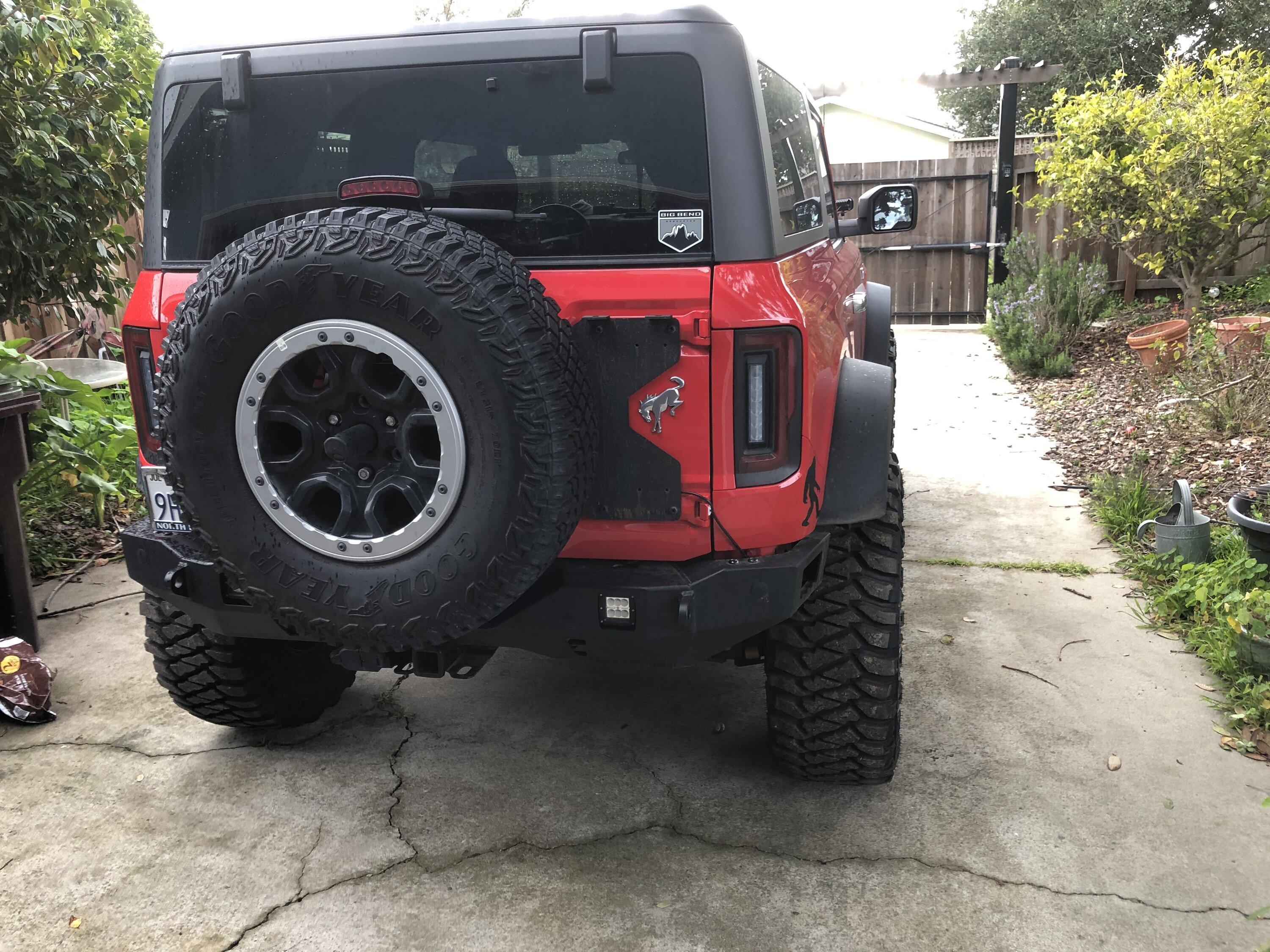

Zero offset Icon Rebound pro 17x8.5 0 offset wheels, MT Baja Legend 37x13.50r17 tires, Zone 3” lift…little more than I like but livable

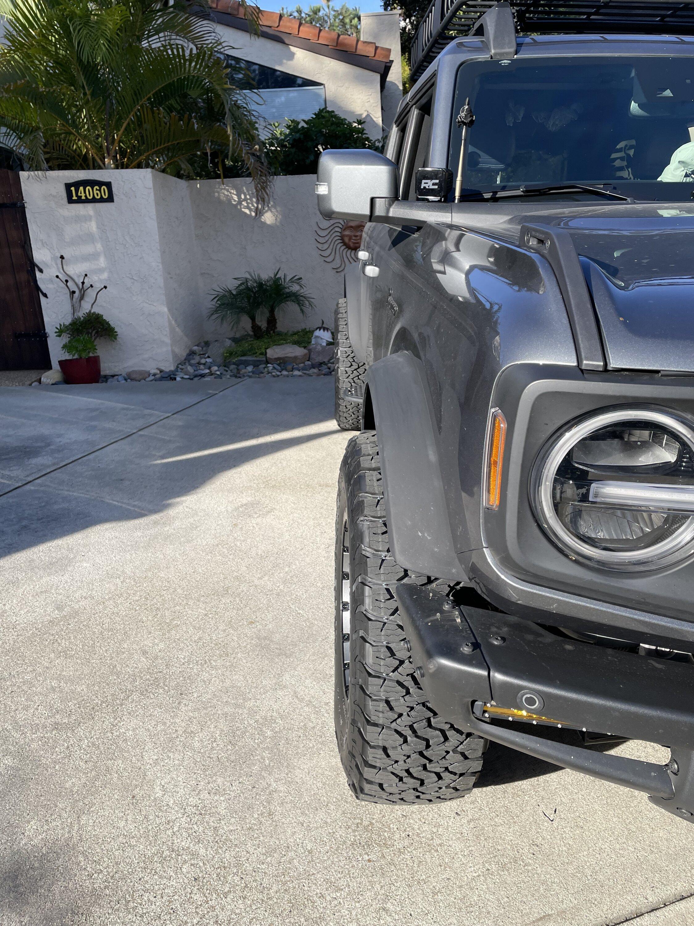

My ICON’s with 0 offset
