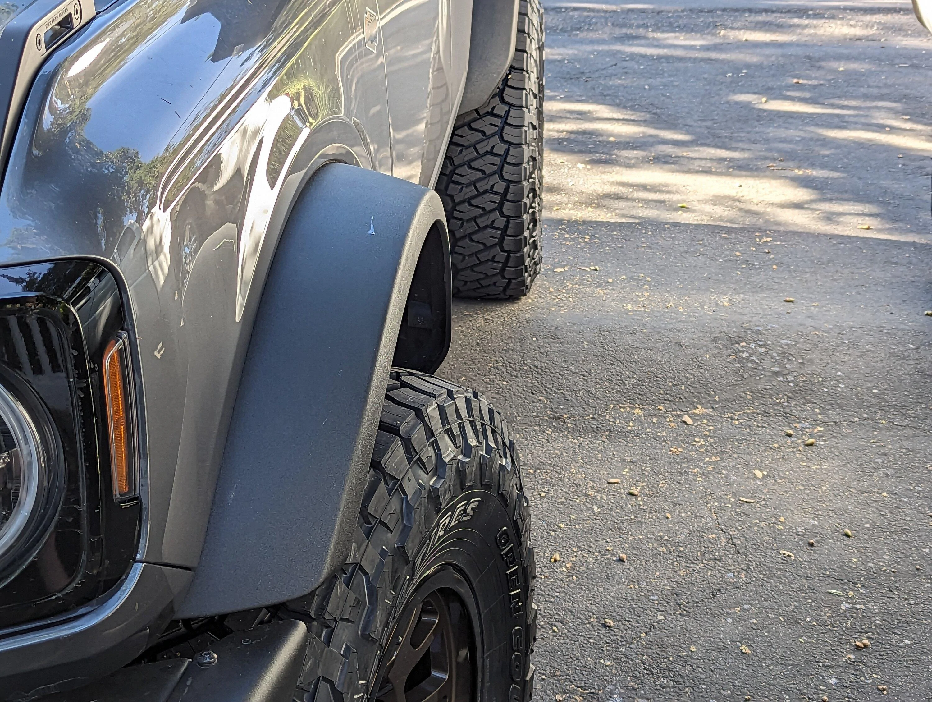

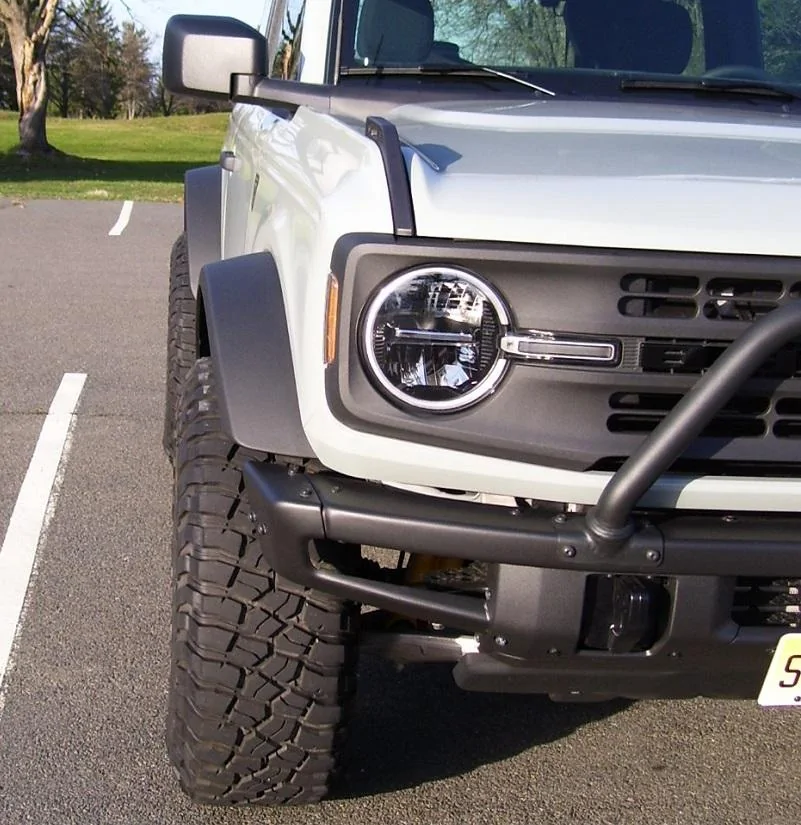

Here's a couple of pictures I grabbed off here showing some 17x8.5 with -10 offset which is just 2 mm less offset than the wheels you're looking at. They poke out a bit, even with the Sas fender flares.

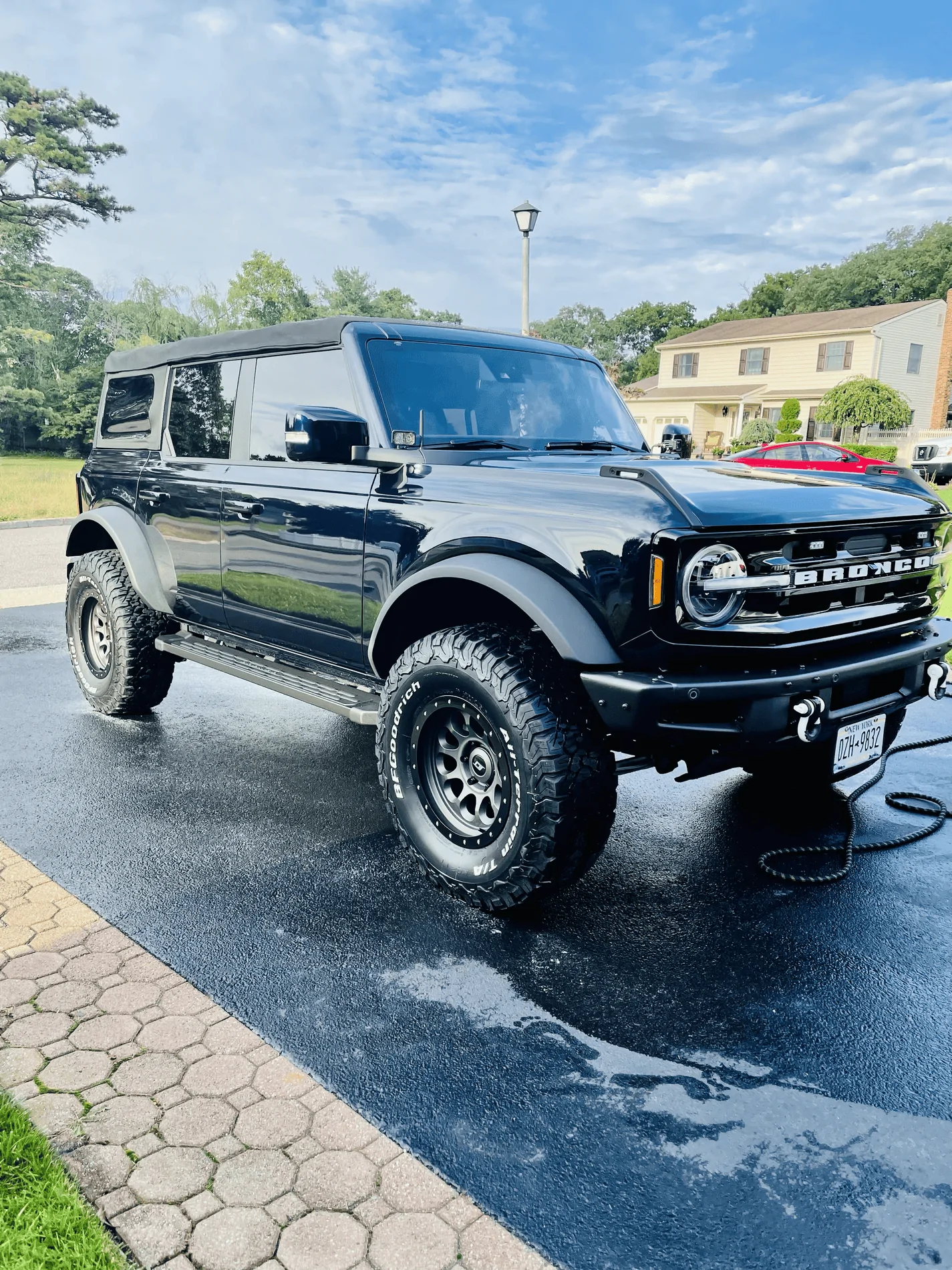

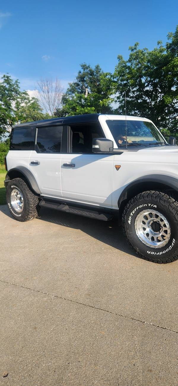

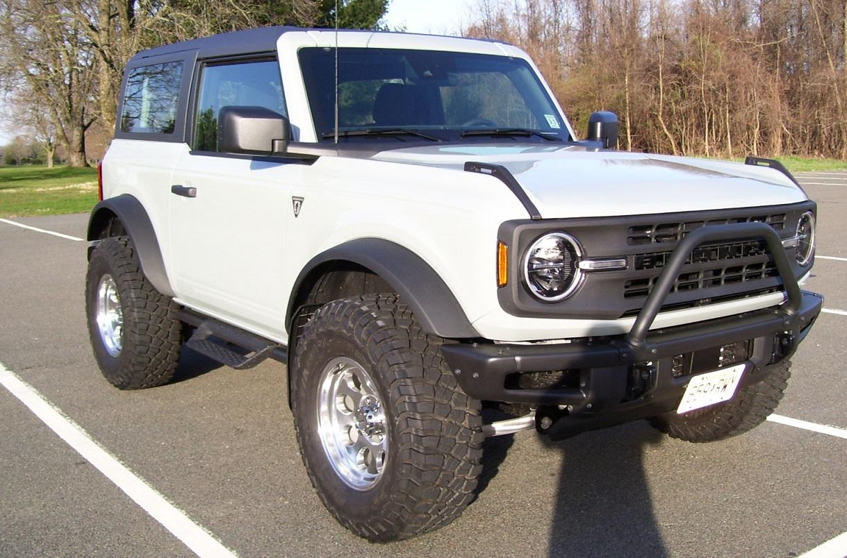

That's not my Bronco, just some pictures I grabbed for reference when I was looking at wheels. Offset/backspacing/wheel width all work together to determine how much "poke" you will end up with. That's why it's always good to ask questions about different combinations. I do have pictures of several combos I saved if anyone needs to see. My Bronco has 17x9 with -6 offset and 35x12.5x17 tires.
