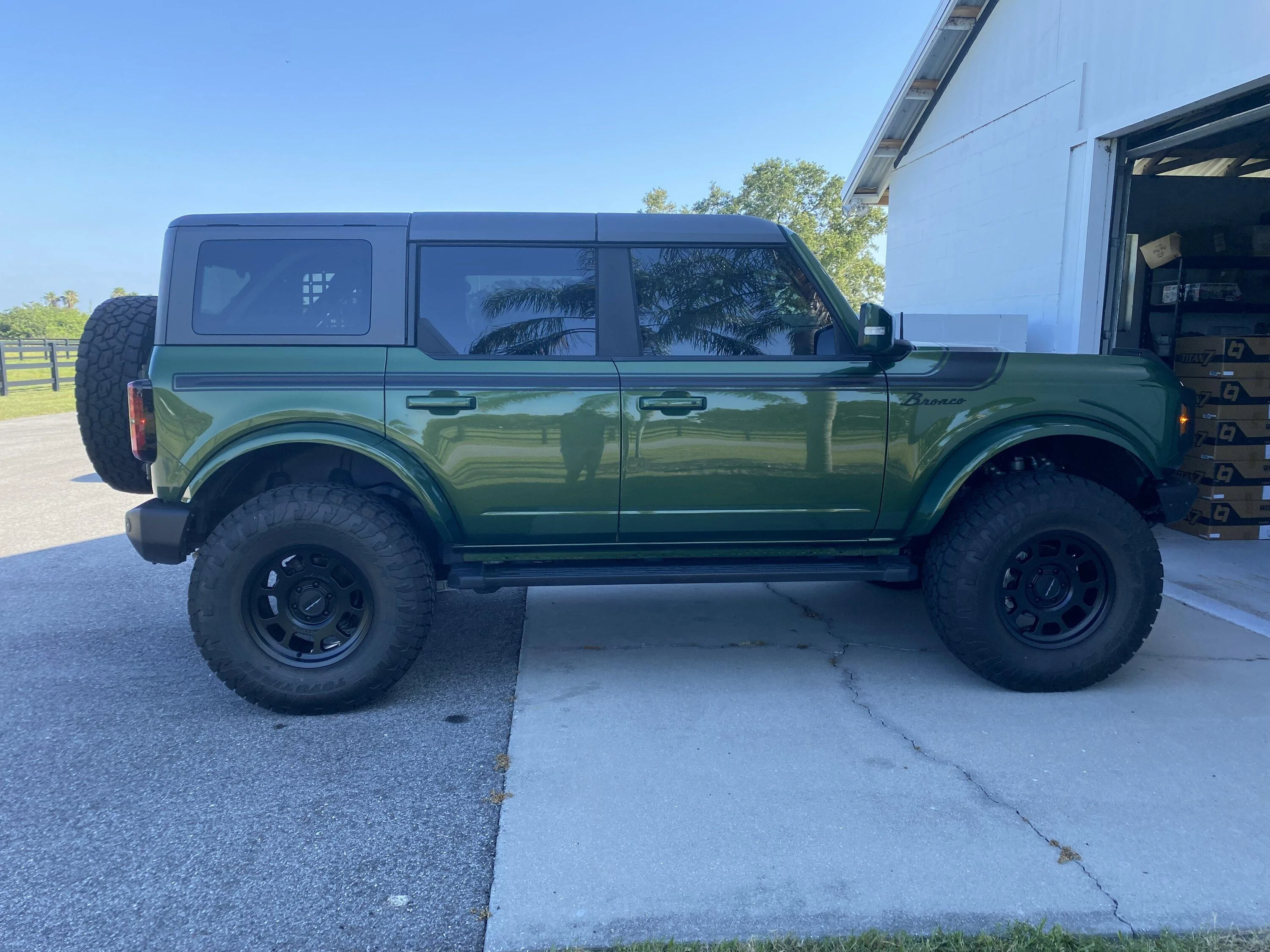

Icon Billet stage 8 here with 37s. No rubbing issues what so ever.
No max clearance kit.
Cut 1" off front of side steps. Was close, but actually did not touch before.
18x9 Wheels with +18 Offset.
Not close to the Front Bumper.
Ford Bronco Sanity check IMG_0726
