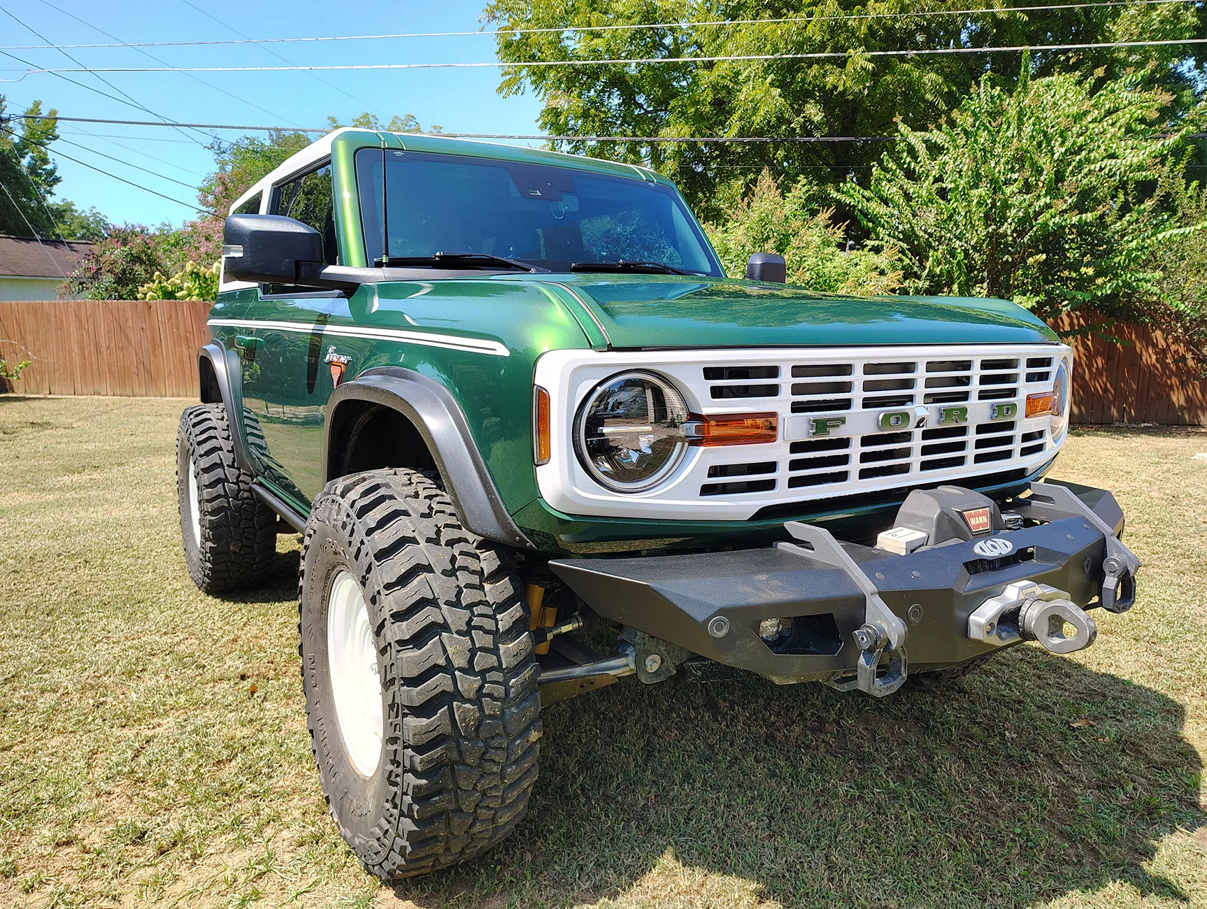

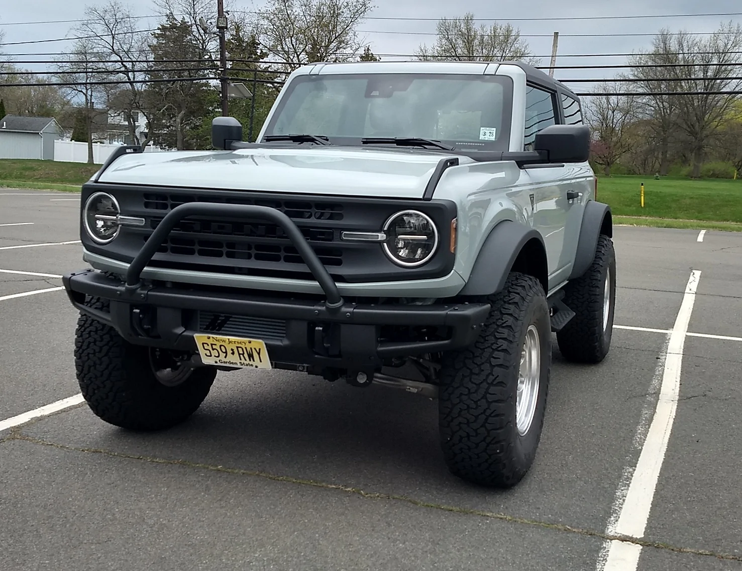

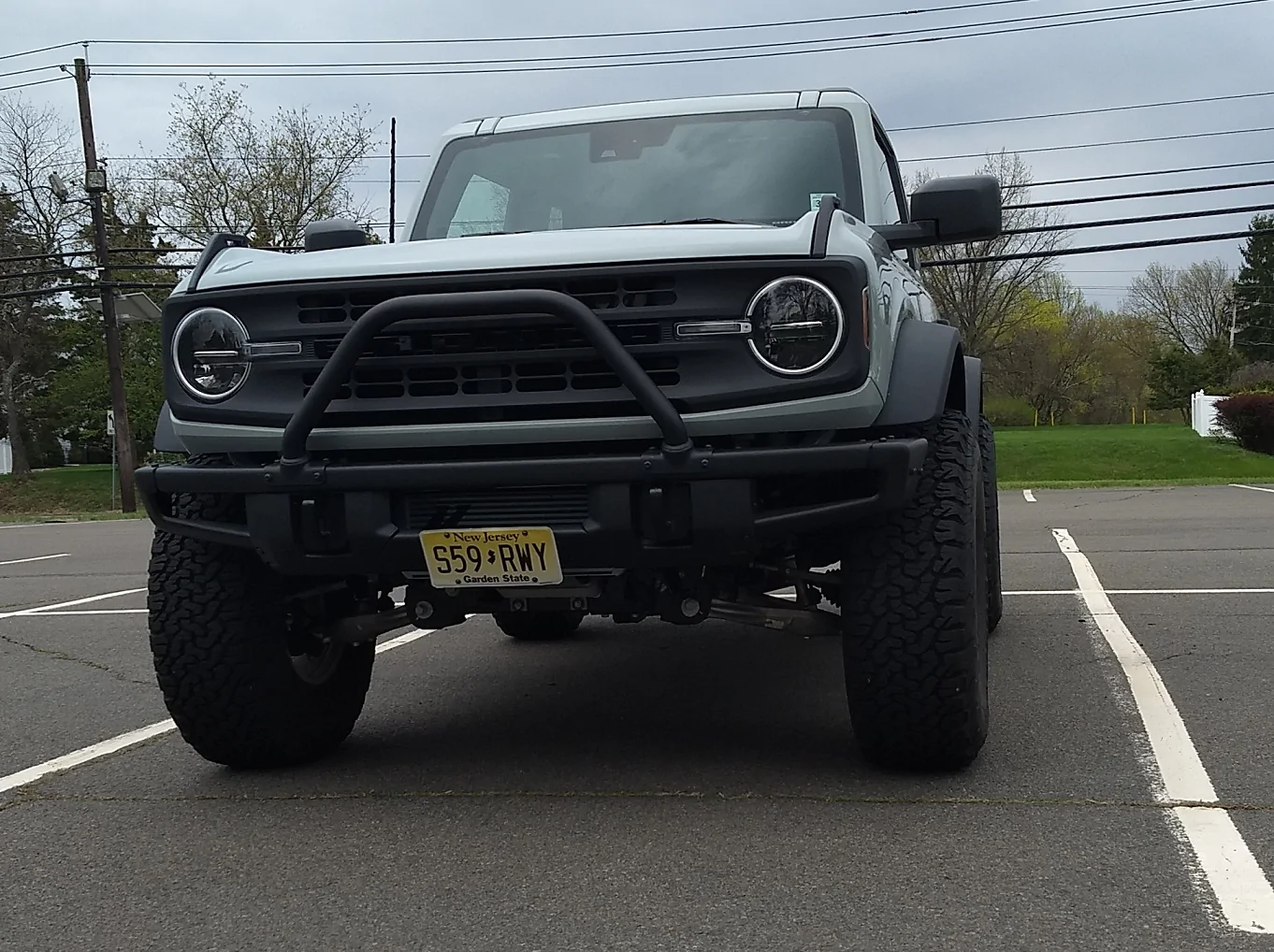

I have 17x9 with -6 offset so those would be pretty close to the same poke. With Sas flares, they will still poke out a bit (3/4 to 1"). The stock Sas wheels are 17x8.5 with +30 offset.

Thanks, makes sense. BTW, looks great! Love those wheels.

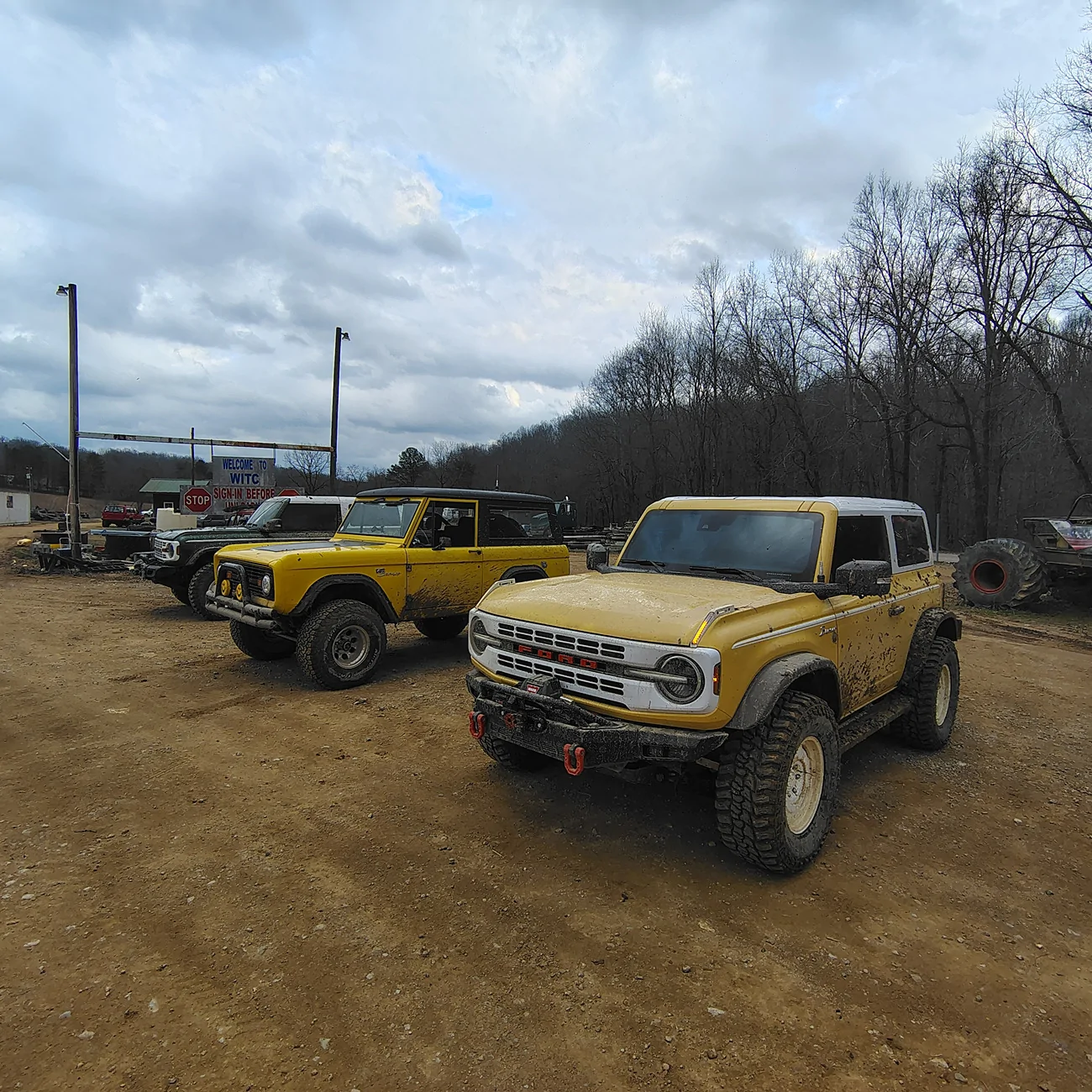

Just for future reference, I've been using this site for 20+ years on everything I decide to change the wheels/tires on and it's been very useful!
https://www.wheel-size.com/calc/
Both my wife's Bronco and mine have the same aftermarket wheels, 17x8.5, 4.75" BS, 0mm OS and mine look like they stick out a lot, but you have to look at my vintage flares. Her HEL flares pretty much cover all of her tire.
