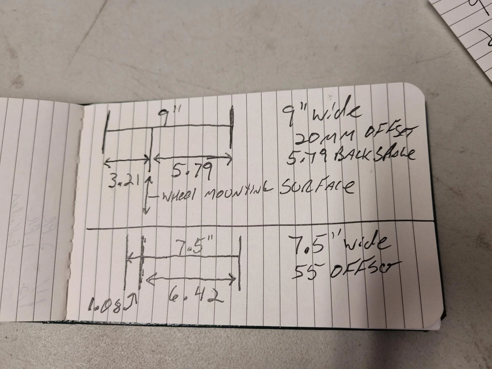

OK...I get what you are saying. So if I went with my "plan"...basically the tire will be a little more outward by 2 inches per side. If I also then put on the Squatch fender flares....I would be legal on tread coverage. Do you see any mechanical issue in doing this? It would be easier if others made 55 Offset wheels....very few that I and others have found.
Thanks for your math and the links!!!!

I see that the stock wheels on the Bronco are 55 offset. I have a base Bronco on order and want to put on 33” tires with the Fuel d557 wheel with a 6 offset. It should push the tires out about 2”. Does anyone think this would work ok?
If you aren't getting Sasquatch, you may have an issue with the all-important "crash bars". But don't even think about removing them because you will IMMEDIATELY DIE and your passengers will too if you don't have them. (Even though Sasquatch doesn't come with them.)
That higher offset effectively increases the radius arc of what the tire will contact at full-lock.

Are those back-space numbers accurate and confirmed or a guess? If you change the off set and wheel size...does backspace still apply ? (I ask because the wheel calculator I used above did not utilize the backspace figure at all).
I guess I am too confused at the moment. This calculator using my data/choices....shows 1.38" further out

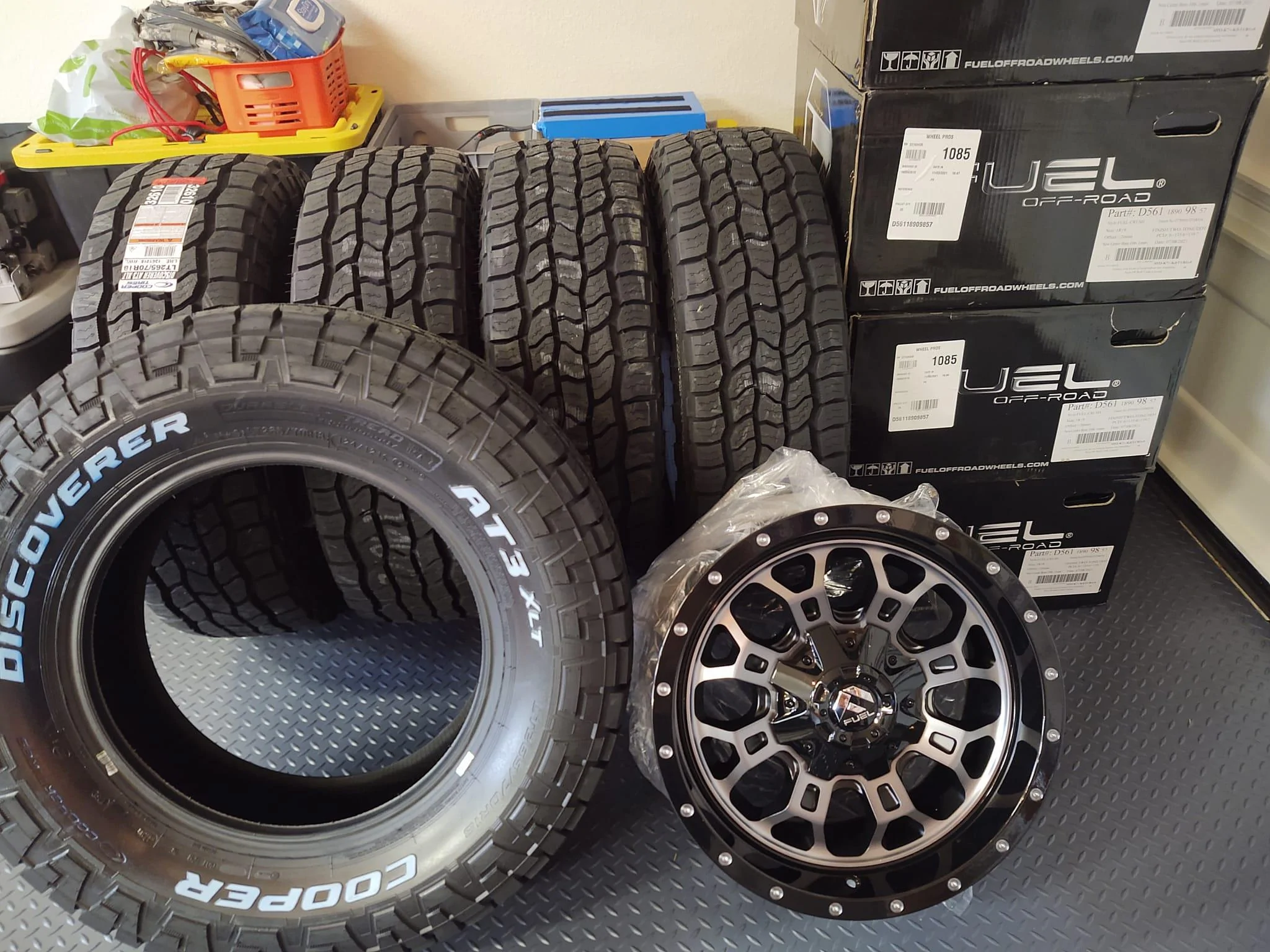

I have these wheels and tires waiting for my Bronco. Who knows when it will ever be built
Ford Bronco Fuel Wheels D557 6 offset WheelsTires
