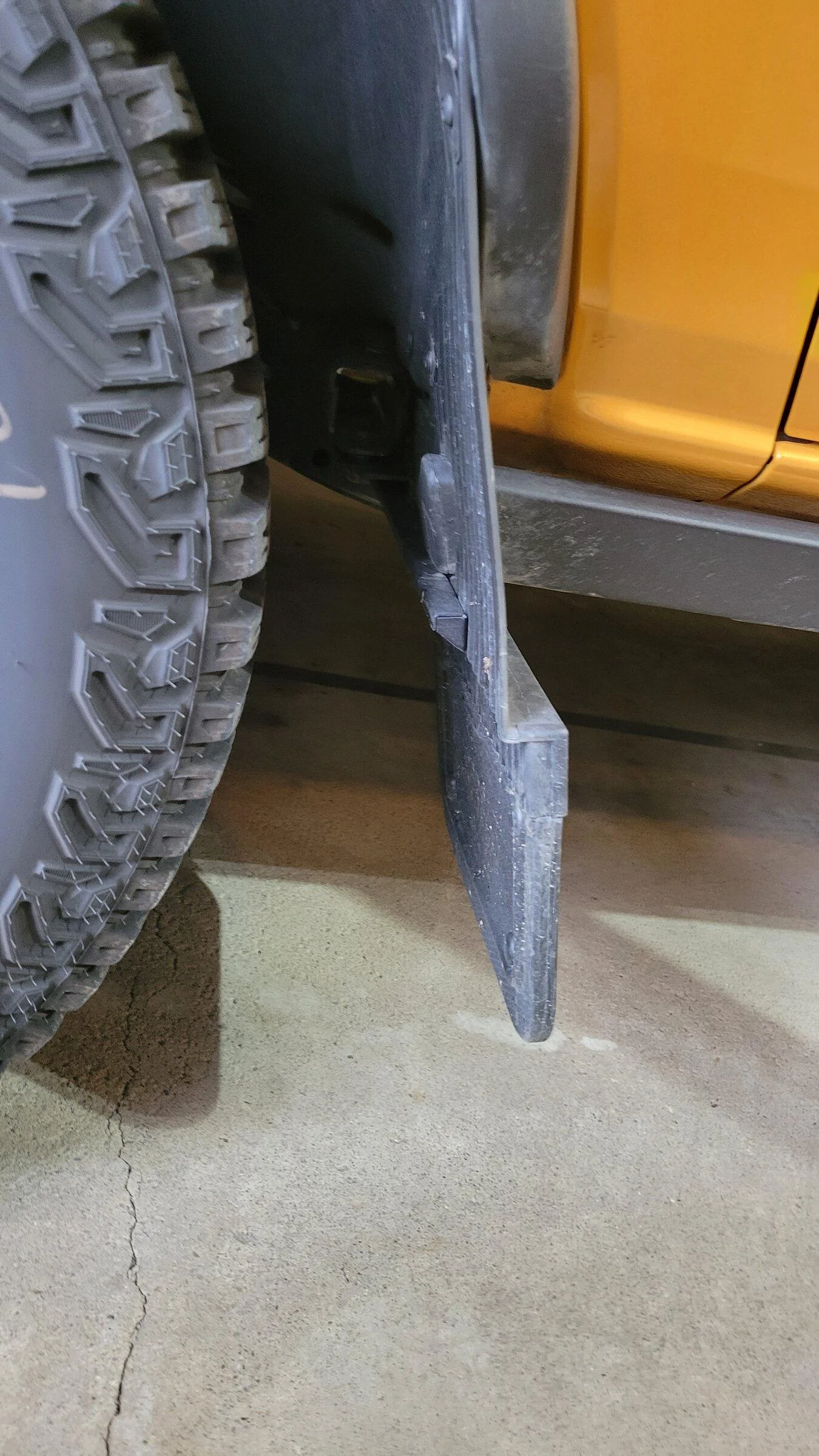

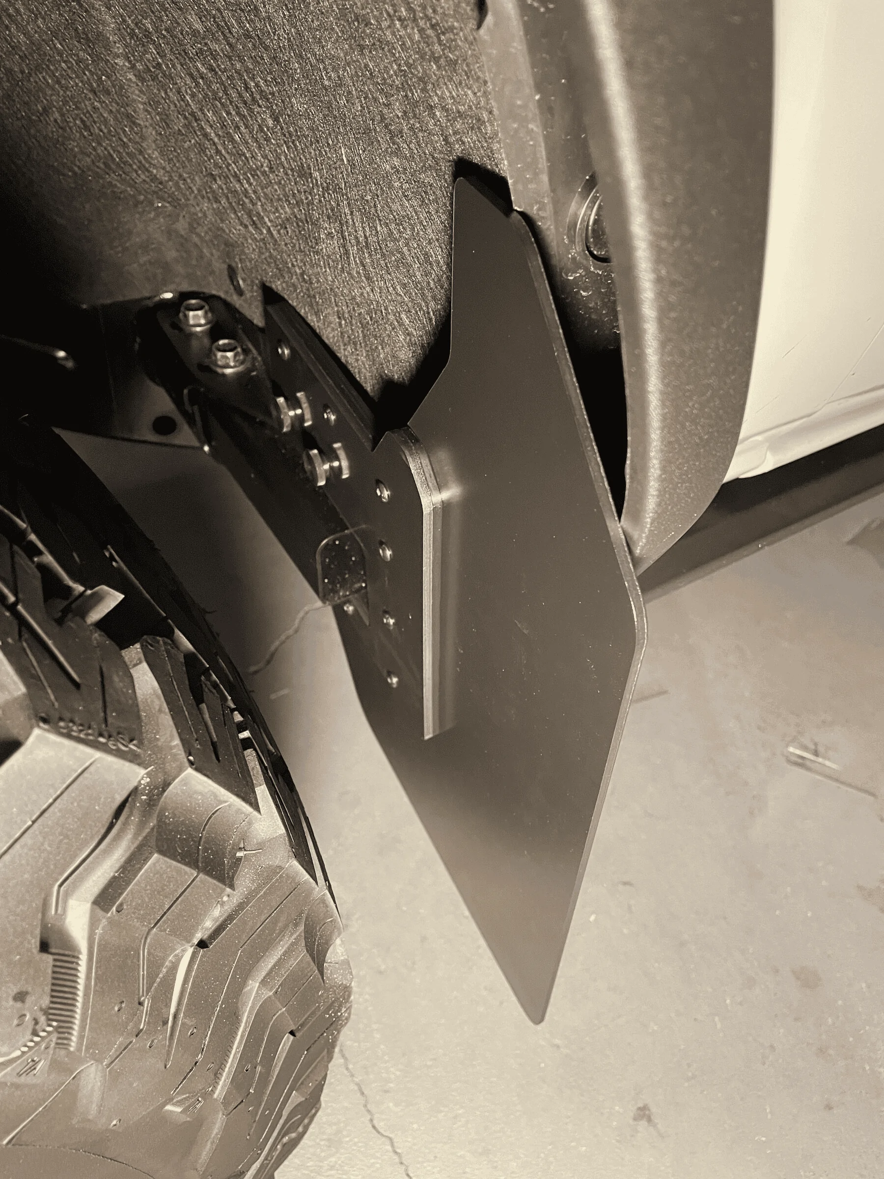

The front flaps are not adjustable, SAS uses a different bracket and flap that is wider to line up with SAS flares. The angle of front and rear can not be adjusted unless you are willing to relax one of the bends on the rear brackets. The front flaps are at 80 degrees, the rear are at about 72 degrees. The bend is circled in the third picture. There is plenty of clearance for the flap tot he rear bumper to straighten it.
Quality reply especially in measuring angles. Thanks! Hopefully they tweak some, at least the front hardware so edge aligns. Thanks again!

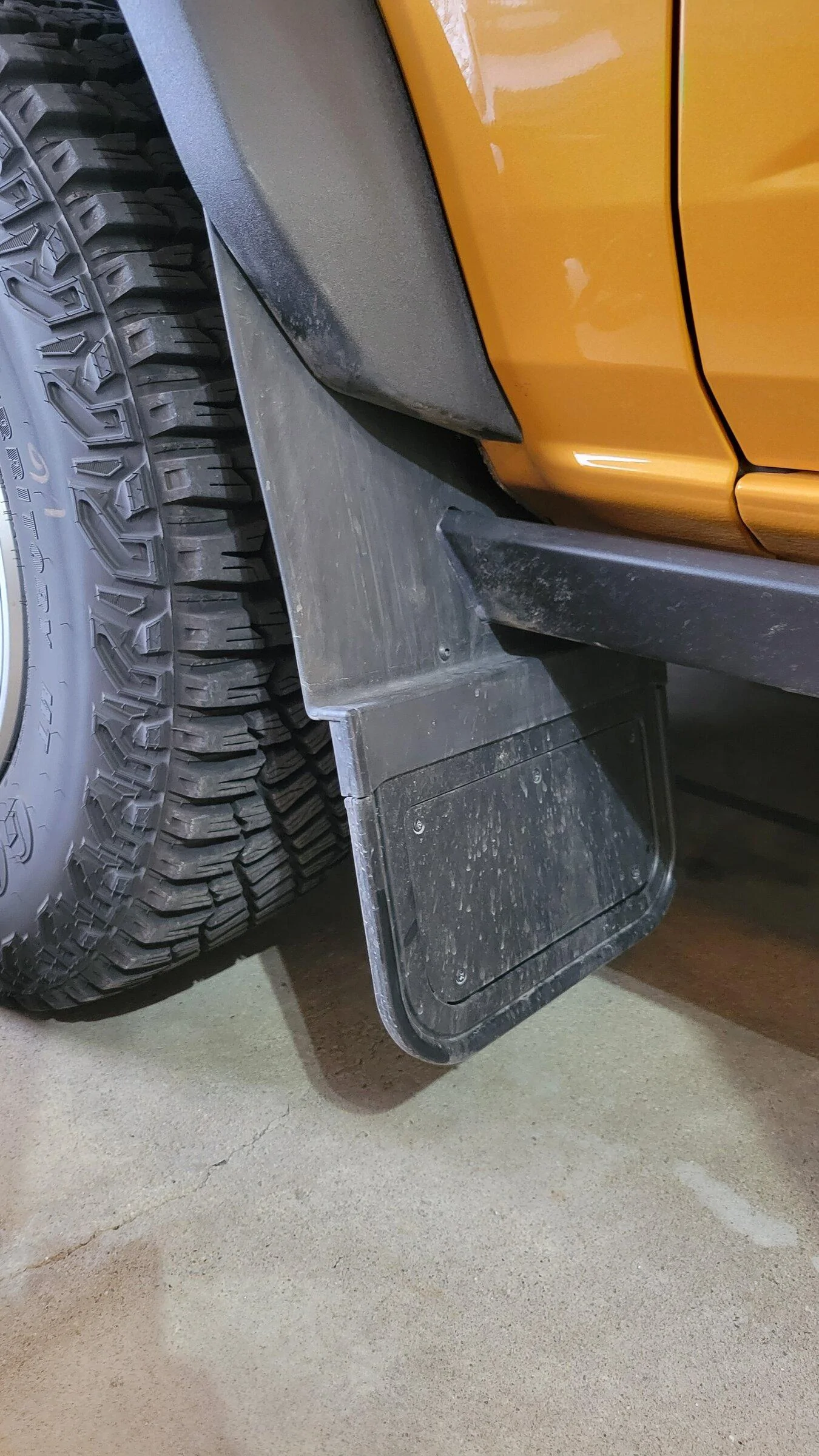

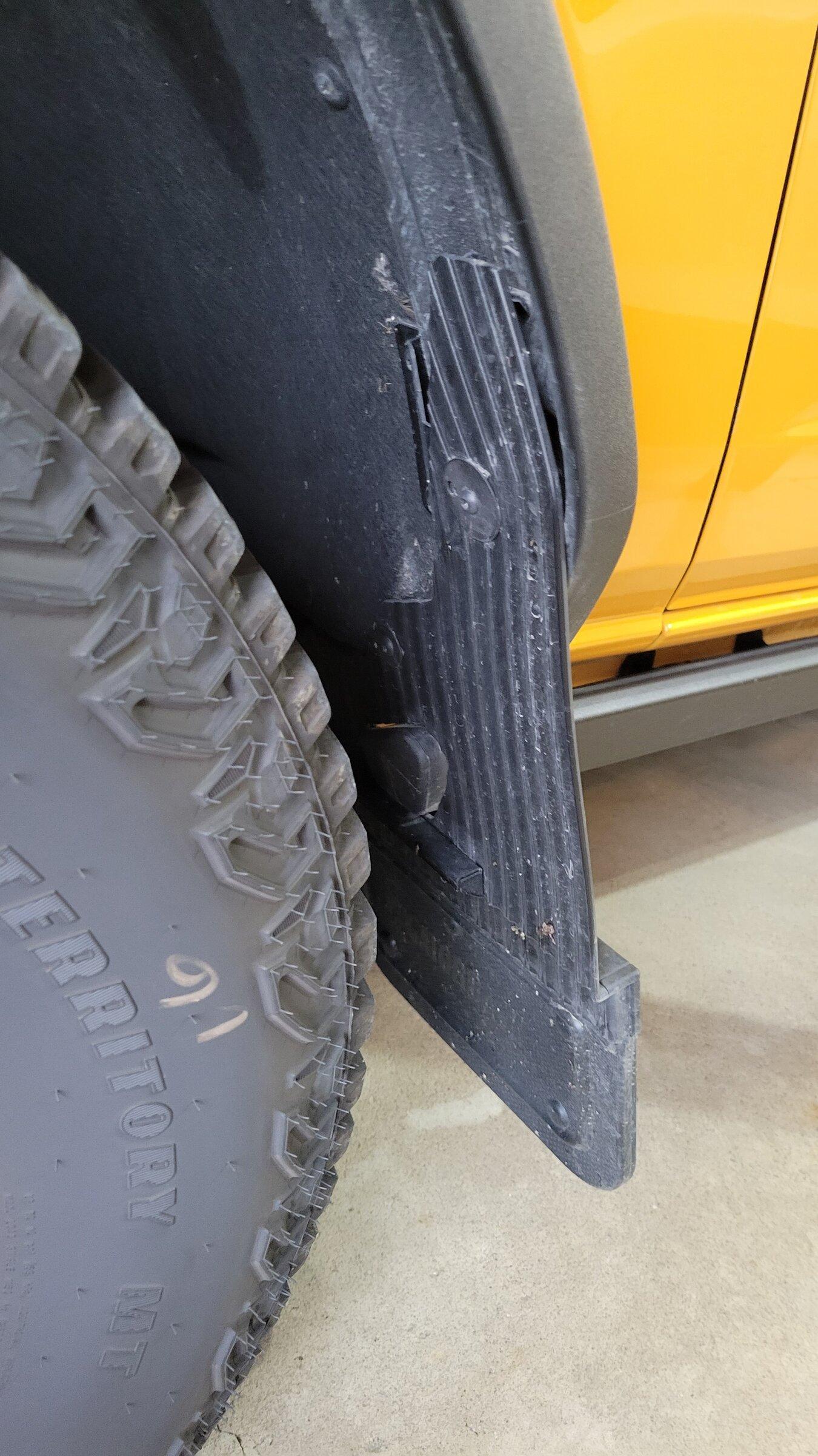

Second issue is the clearance for your tire. Less than an inch at a certain tire angle. The screws on the bracket are already in contact with the wheel wells so can’t really push it more towards the wheel wells. Could be an issue. See picture.
Third issue is the fitment, it doesn’t really sit nicely against the fender flare. That’s mostly esthetic, not a functional issue. See picture.
I have feeling this product has not been tested well (on Sasquatch that is, their website and instruction shows a non Sasquatch with different bracket).
I will update this post once I get any new update from their support. Hopefully they make it right.
