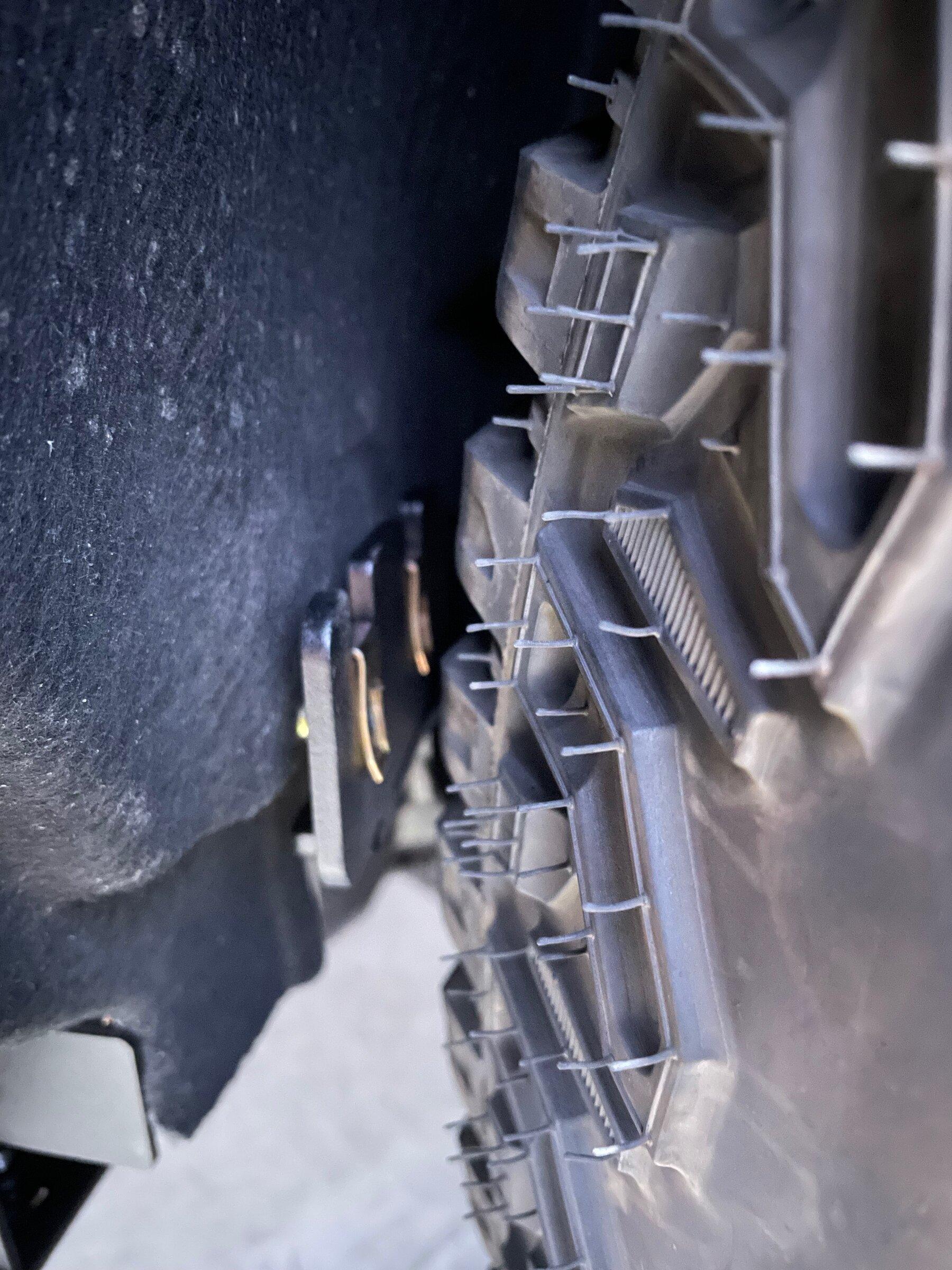

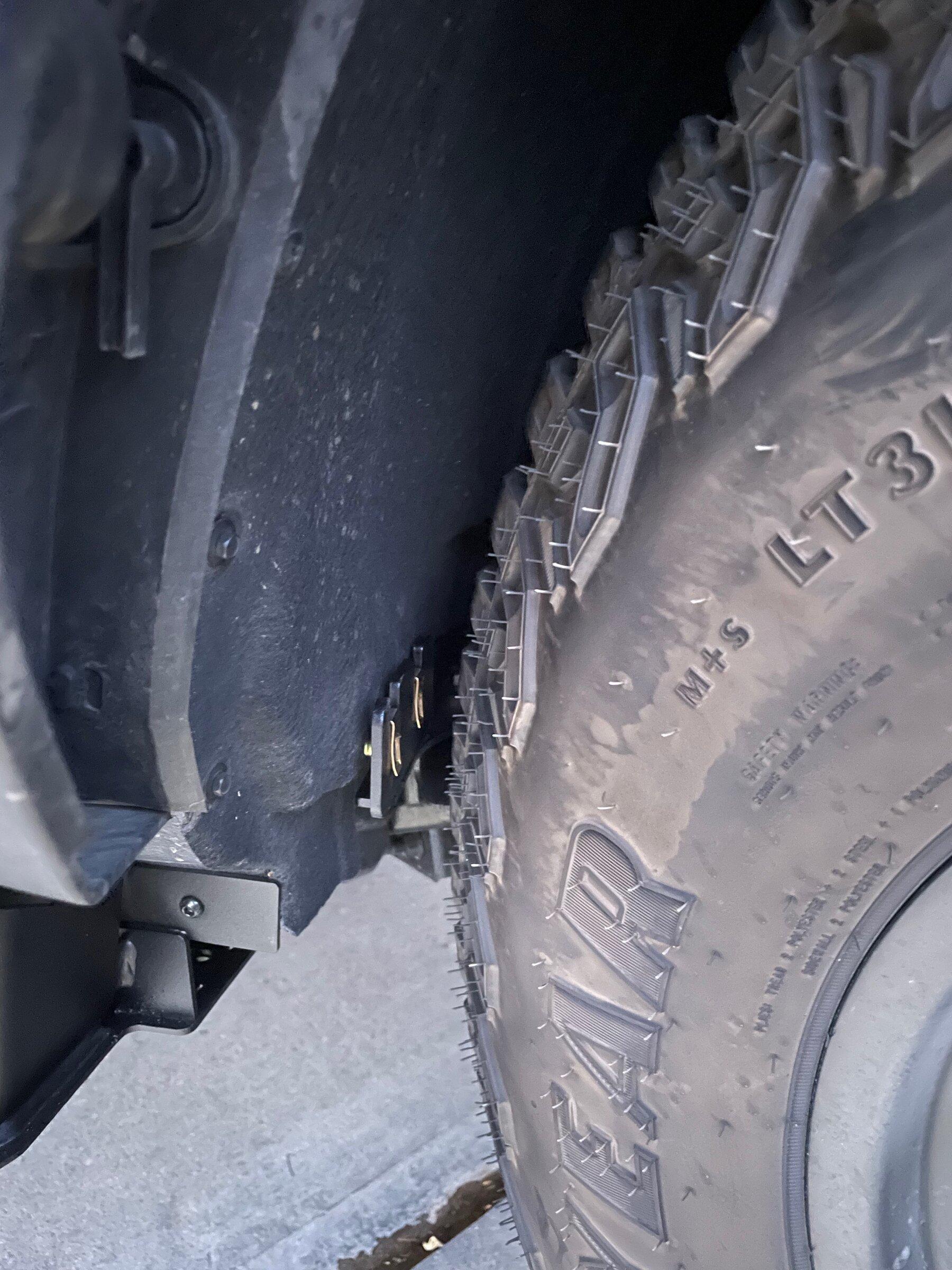

I too received mine quite a bit later than projected. But they look to be the part. I installed them this weekend being particularly careful to get them seated as far back as possible because I have the Sasquatch package. I read the online instructions and watched their video to make sure I was doing it right. And that didn't seem to help. As soon as I backed out of the drive way the front passenger tire started to rub on the thumb screws. I tried again to move the mounting bracket as far rearward as possible, pushing hard on the wheel liner, but it doesn't seem to help. Every time I crank the wheel hard to the right like when parking at the grocery store, or in the Home Depot the wheel catches the thumb screw and has torn gone of them completely apart.
I sent an email to Rok Bloks last night about it. Hopefully they have a fix for this. They're far too expensive of a product to have this kind of issue. :( Here is two photos showing that bracket and how's actually pushed all the way into the liner. Also show how the stock 35 Good Year is super close to that bracket even without the flap or thumb screw. Not sure how that can be right/.

You may have stock tires but those are not stock wheels and I'm guessing you have an offset change.
0 offset wheels? That'll cause the rubbing. You are technically not stock. They do fit with no rubbing with stock tires AND wheels.

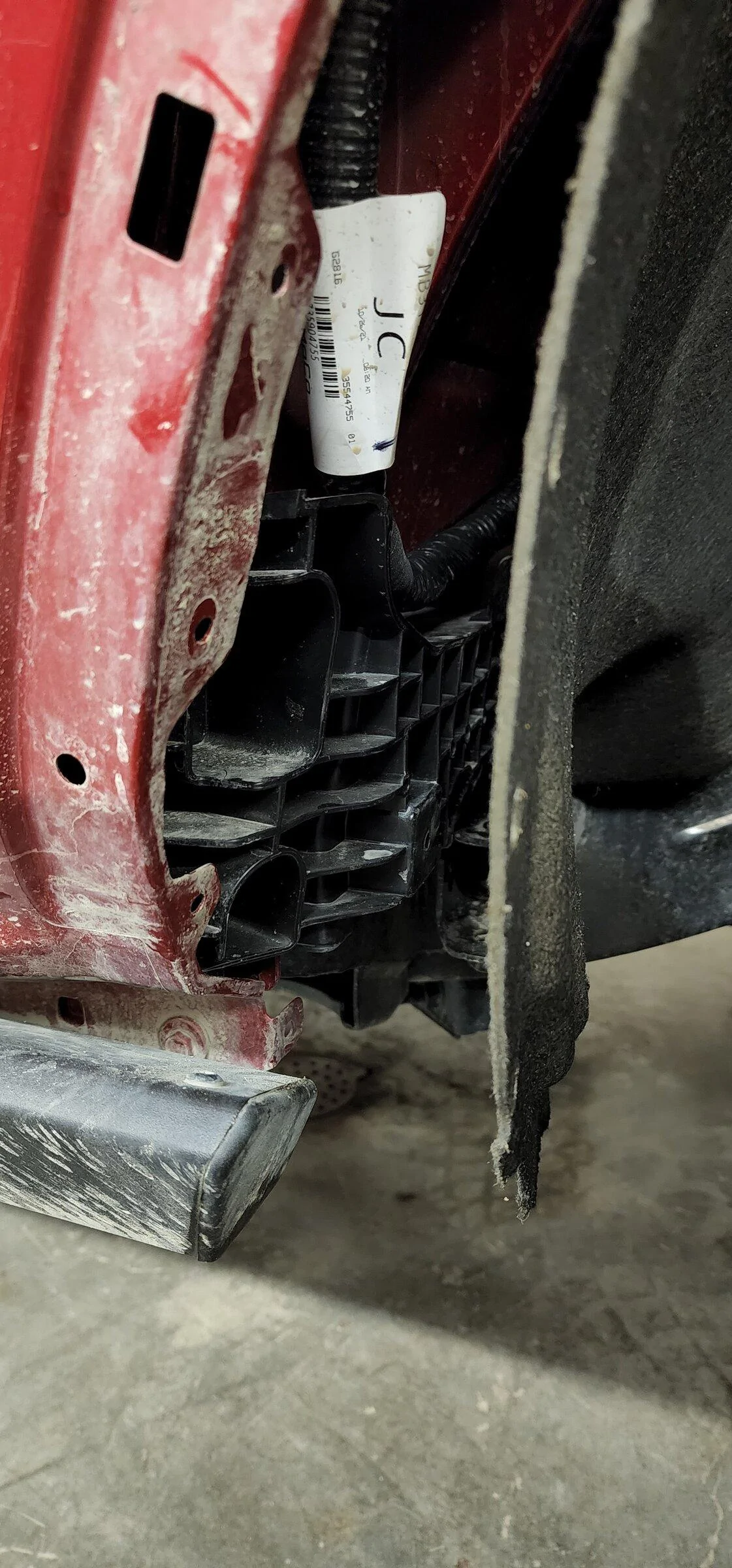

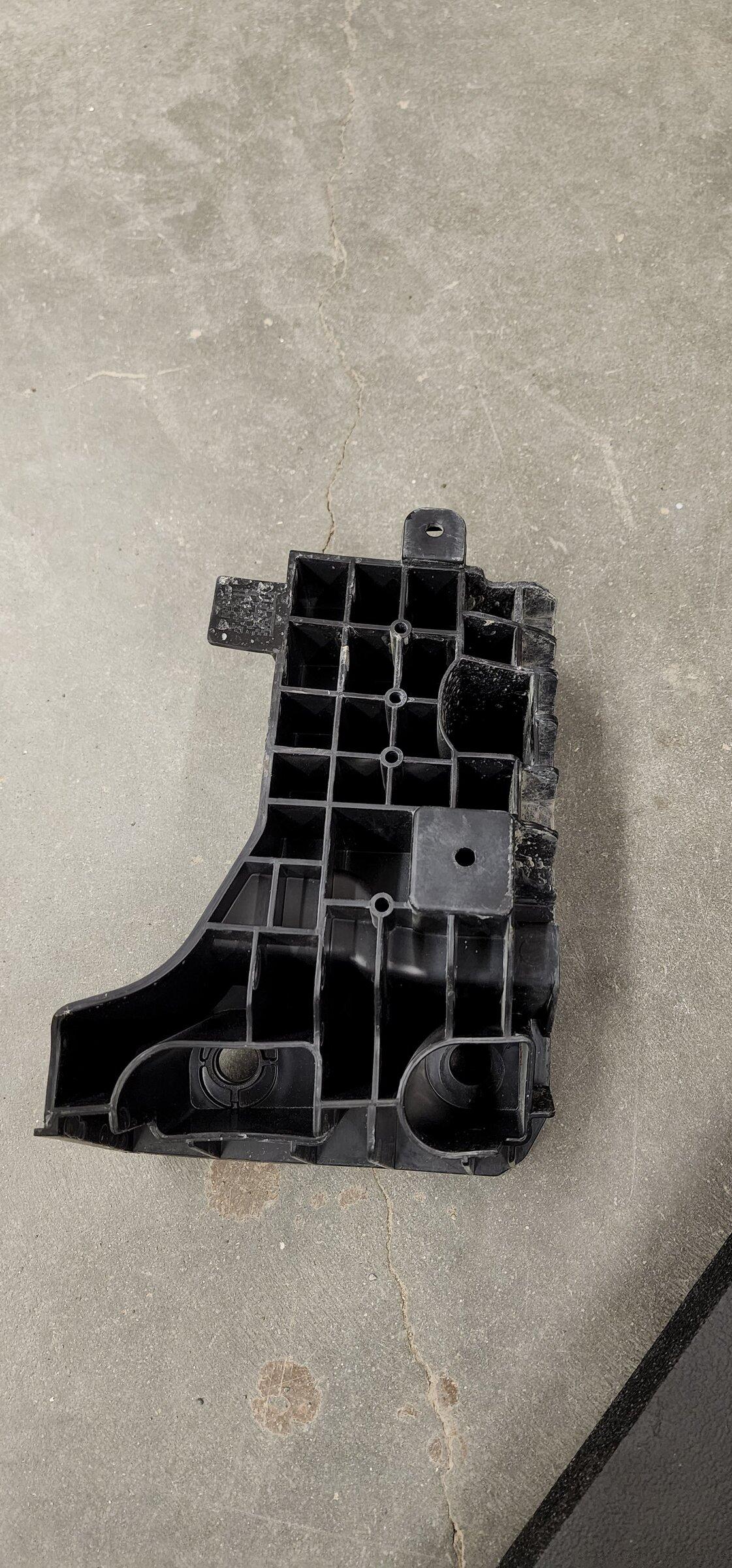

There's a big plastic block behind the fender liner that prevents the RB bracket from actually using its full adjustment range. It seems to be there only to provide a mounting point for a few of the liners push pins. It's basically filler.
I went into detail in another thread about what I had to do to get the RB flaps to fit my Sasquatch/rock rails/0 offset equipped ride.
