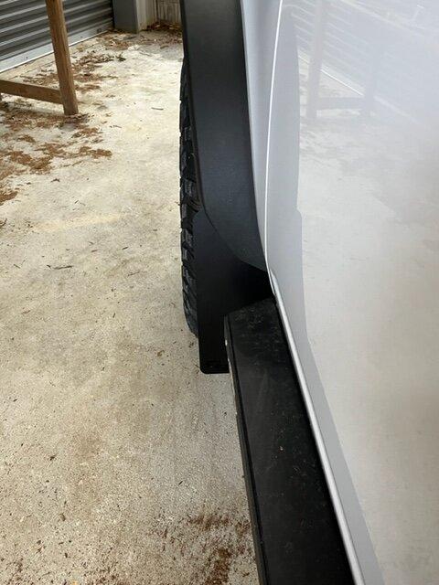

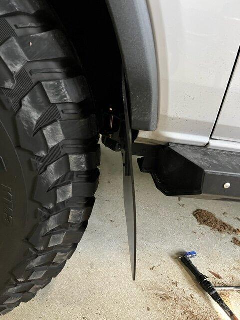

I posted this on my build but thought it may help more people who don't follow my build.
I did this with the tires on by just turning the wheels.
So the MudFlaps came in. (I ordered the XL Black on Black)
https://rokblokz.com/products/ford-bronco-2021-mud-flaps?ls=SKxP7FWzSLqbst5vCqv_4w
Video on how to install.
You will need to watch this video to see how I did mine for 37s or just more room. I didn't pull the fender liner all the way out just the ones for the back to get the 3 bolts out that out that hold that plastic fender piece. I also took the fender flares off. @7min+ shows taking the 3 bolts out.
I bought the (Max Tire Clearance kit) but after looking at what I was working with I decided not to use the kit on this project just think its not needed being the mudflap bracket holds it back.
https://jksmfg.com/collections/ford-bronco-2021
At a later date I will be installing the front part of the kit but I want to take it out like it is first and post back the results for people not willing to cut the crash bar. AKA with 1/4 spacers vs I won't need them anymore once I install kit.

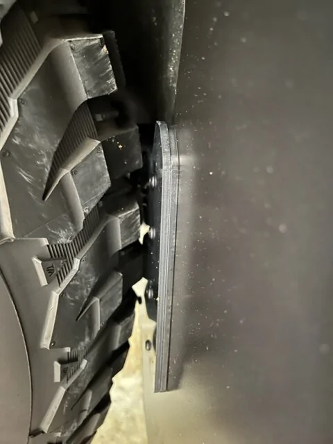

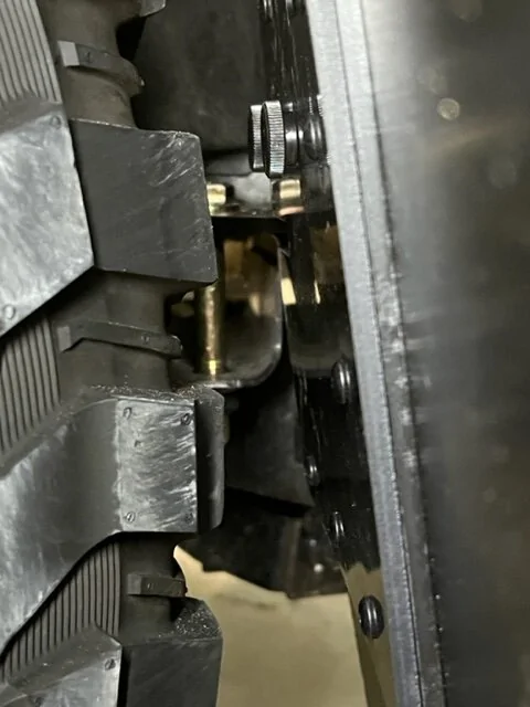

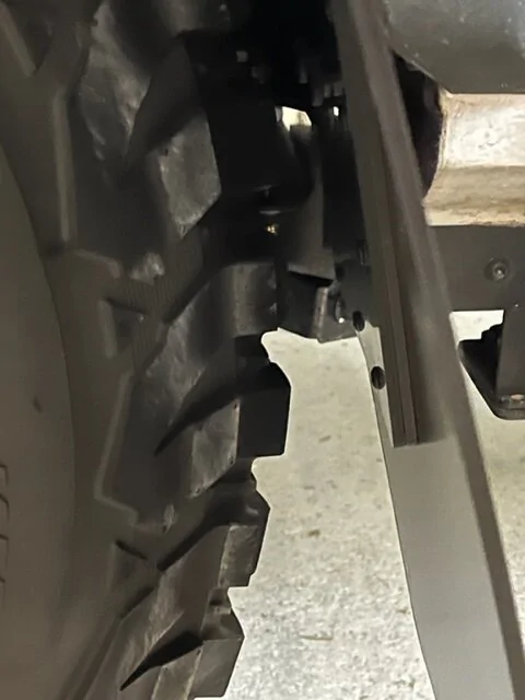

This is a pic of results when I installed without removing the plastic piece behind the fender liner. 100% rubbed never even went down the road. To be clear I knew this wasn't going to work already.

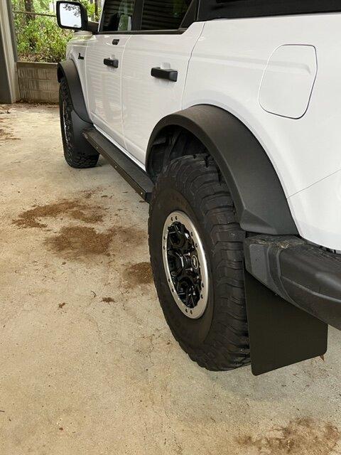

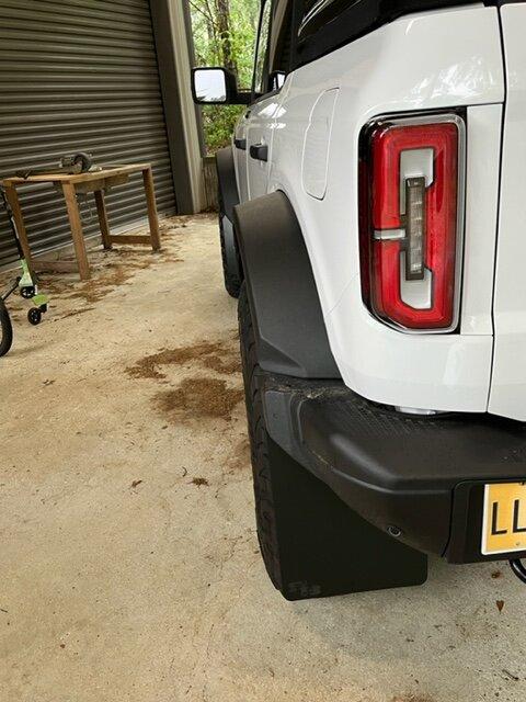

Next, I did what I said above. Pulled the fender flare, pulled the fender liner to get to the large plastic piece, removed the 3 bolts and removed, next I reinstalled the fender liner and fender flare, Installed the mudflap with the bracket and all put together, now when installing the 2 big bolts I pushed the mudflap back as far as I could and tighten while holding it back. This way I would get max distance from the tire. Personally I like it, I think the rockslides help keep it looking better.
I most likely will keep the back ones off unless I am pulling my boat or something, But maybe not I dot really think they look that bad. (Also the rear are pushed all the way in. They can be pulled out about an 1in or so)

So I tried this mod with my Falken wildpeak 37x12.5x17 -12mm offset and still were going to rub unfortunately. I’ll see about wedging them behind the crash bar mount and splash shield next
Any luck? I still have the stock 35s but I want to upgrade to 37s one of these days. I do love my Rokblokz and would like to keep them when I eventually do upgrade so really curious how this worked out for you.
Nope. Definitely rubbed unfortunately. Right now I have no mudflap solution. I’d consider smaller 37s if I were you. My Falken’s are true 37s and almost 13” wide

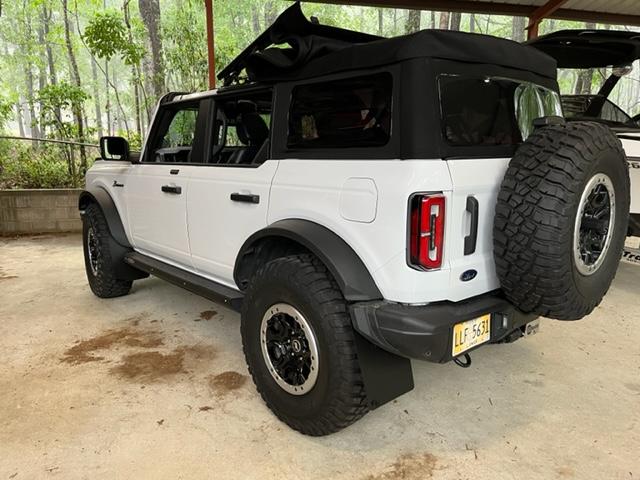

See post 64-72 At this point I can run 38s with no rub. Now hardcore Off-roading I have to take them off but thats it.
