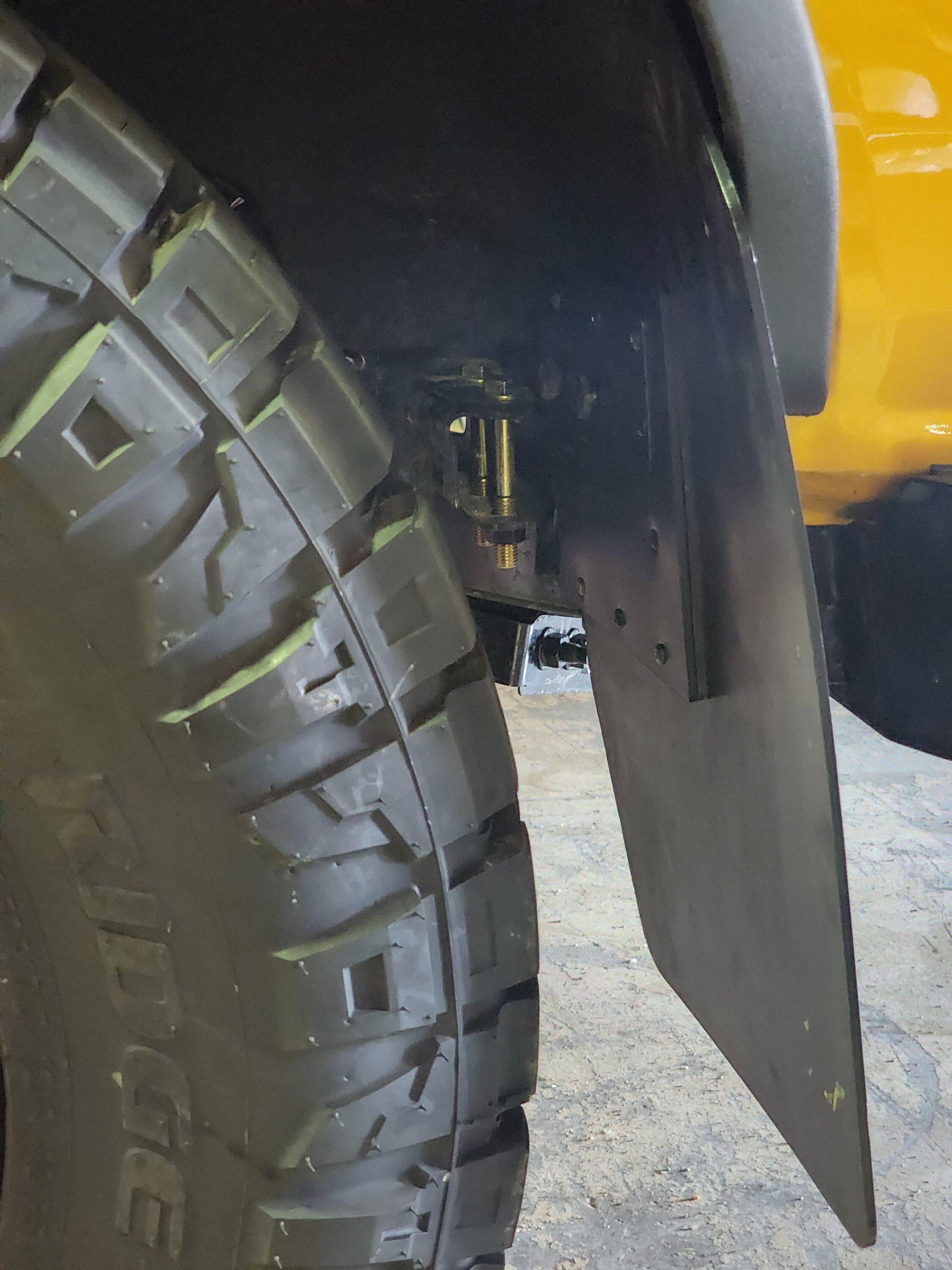

After months of wait, I finally received my front RokBlokz mud flaps for my Badlands Sasquatch.
This is a preliminary review, in development. In summary, for now it’s a disappointment.
So, for $300 you receive 2 brackets and 2 thin pieces of plastics with dozens of little screws all unmounted. They tell you to use loctite, but it’s neither pre applied nor included. Fine. After you are done playing legos and assemble the whole thing and loctite everything, comes the problems.
The first and main issue is that the flaps rattle a lot as soon as you touch them and on the road (see attached video). They also don’t stay in place properly as there is a lot of play vertically (also shown in the video).
I contacted the support and sent the below video and they replied that the only thing they can think of is to make sure the hand screws are tight.
I fully unmounted the brackets and tightened the hand screws to the point I cut my finger. Still exactly the same issue. On the second video I put way the bracket from the wheel well and you can clearly see the little piece of metal they use is the problem moving up and down.
I replied to them today after doing those tests, and will update here when they reply.
Second issue is the clearance for your tire. Less than an inch at a certain tire angle. The screws on the bracket are already in contact with the wheel wells so can’t really push it more towards the wheel wells. Could be an issue. See picture.
Third issue is the fitment, it doesn’t really sit nicely against the fender flare. That’s mostly esthetic, not a functional issue. See picture.
I have feeling this product has not been tested well (on Sasquatch that is, their website and instruction shows a non Sasquatch with different bracket).
I will update this post once I get any new update from their support. Hopefully they make it right.
Update:
  • Rokblokz acknowledged the issue eventually and shipped new clips that fixed the up and down movement of the flap.
  • I still have this issue: following Rokblokz instructions to sit the bracket right against the wheel well, the metal clip threads protrude in a way that eat into the wheel well liner. Then putting the hand screws makes it even worst cause they are too long and go past the metal clips. I used spacers for that. If you don’t sit the bracket against the wheel well, then the flap won’t sit against the fender flare properly creating other issues (less clearance for the tire, rattle, etc).
Update after months of use: it works to protect my Bronco from mud and rocks. screws come undone from time to time. It’s expensive for what it is, but so far it gets the job done and so I will say I am fairly satisfied despite being a beta tester at the beginning, customer service handled everything properly.
I had same issue. On 35s, 0 offset, sasquatch with zone 3 inch lift. I removed the plastic box that does nothing. I went from rubbing at lock to 4 inches if clearance.

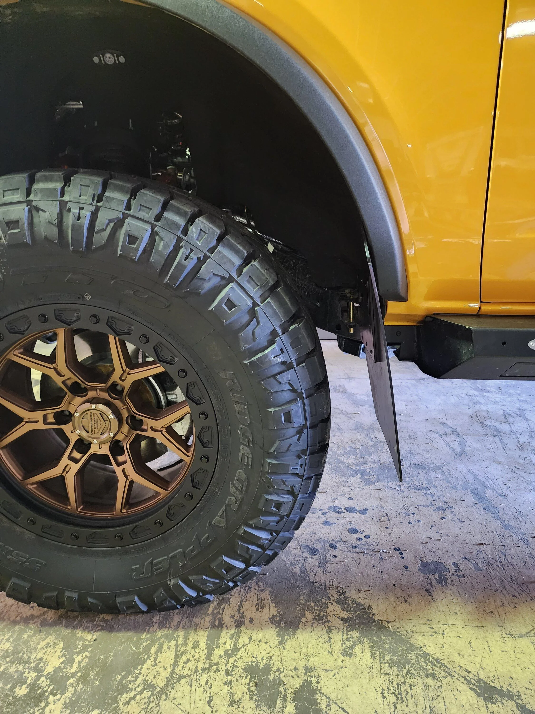

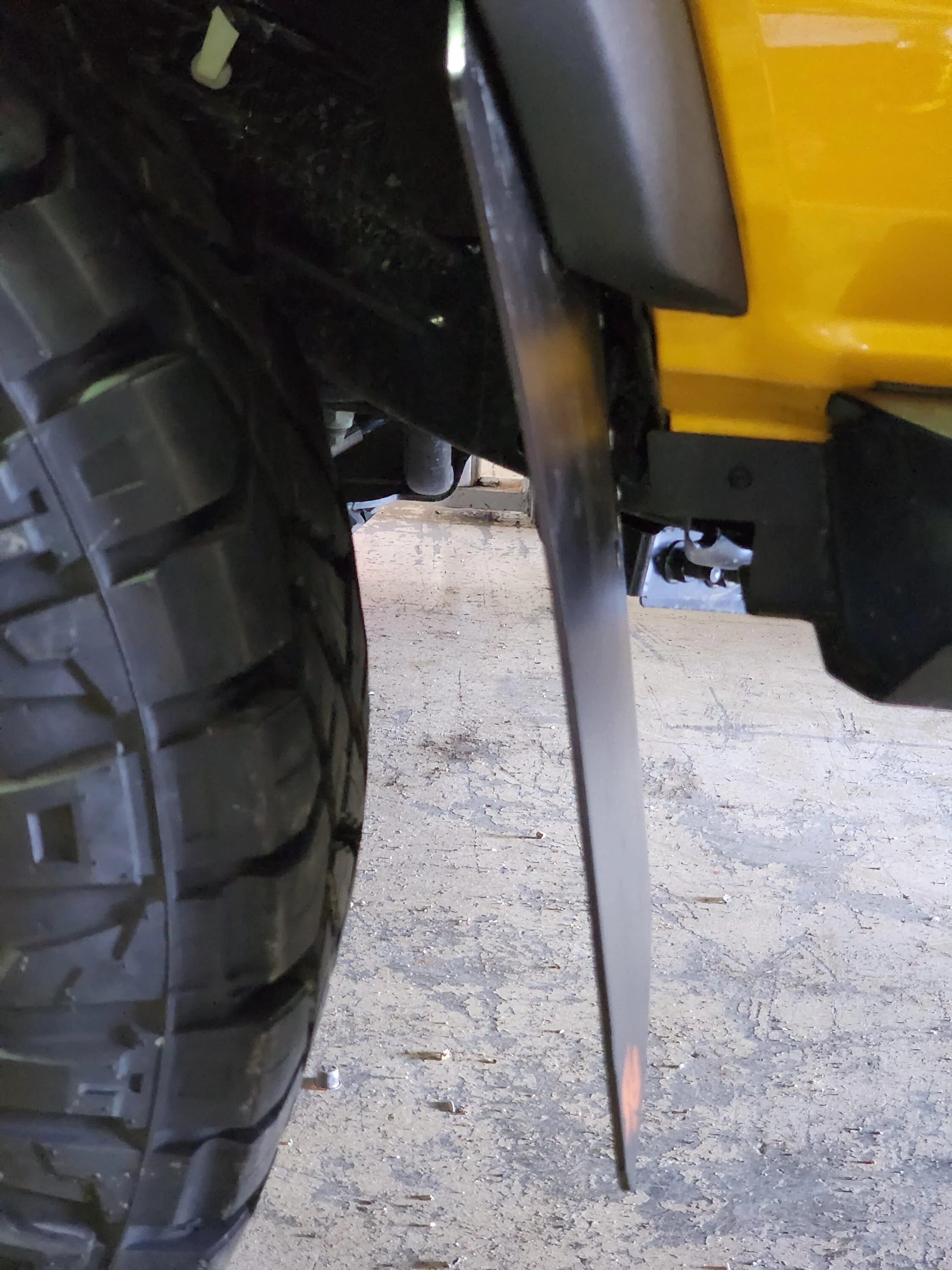

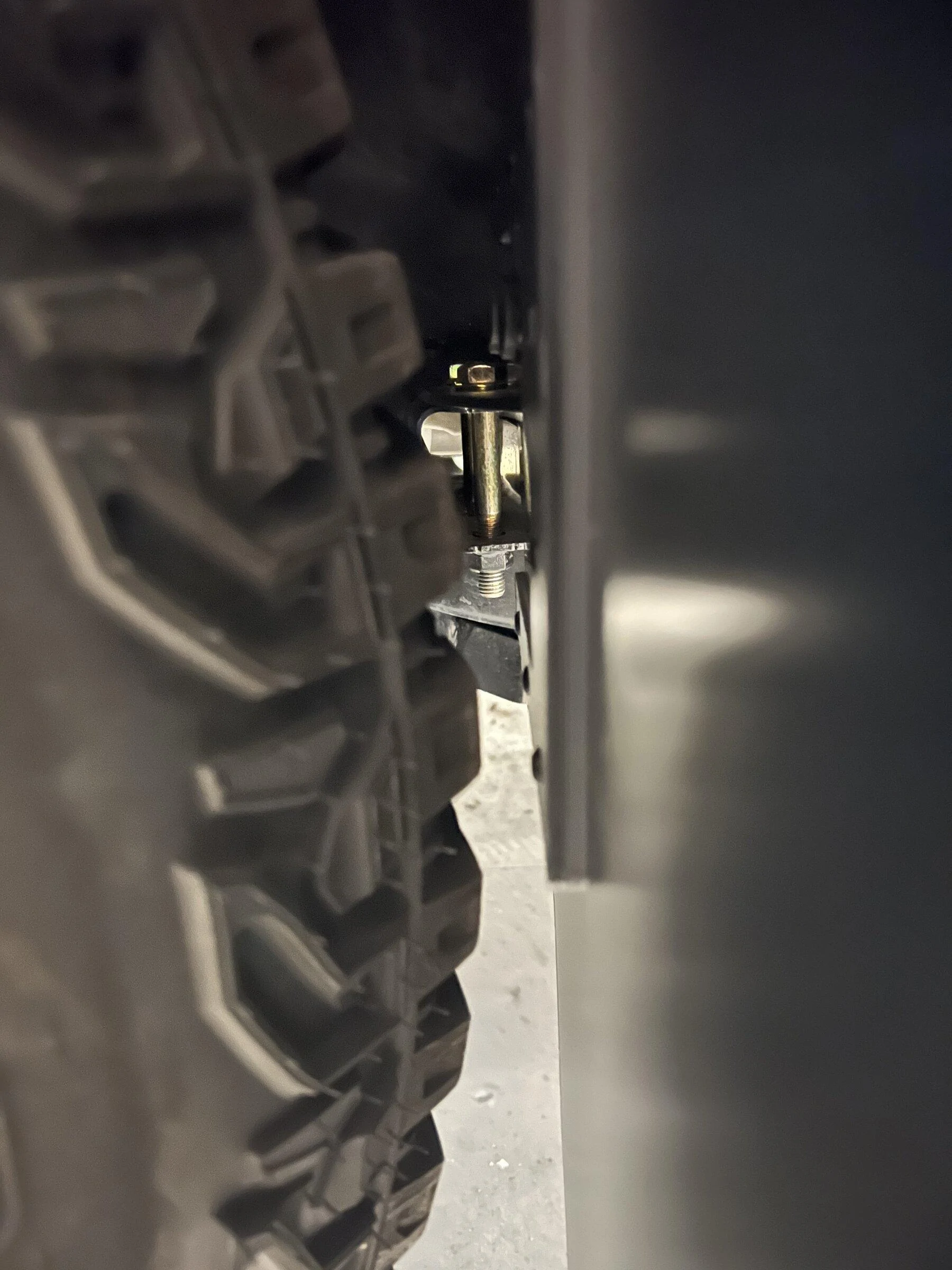

I had same problem. Removed plastic box hehind liner. It does nothing. Had 1 inch clearance, rubbing, loosthemselves up.
RB sent this-We did find that if you remove the plastic box thing behind the wheel well liner, you can push the bracket back to add some additional clearance. You will remove the 5 or so plastic rivet inserts on the fender liner. Then there are 3 bolts in the plastic box. Remove those and then the box will come right out. Replace the liner. Mount the flap to the bracket and slide back as far as possible (this will depend on when your flap starts hitting the body or rock rail or such) and tighten the brackets back down.
Ford Bronco RokBlokz Mudflaps Review 20220908_141923
Ford Bronco RokBlokz Mudflaps Review 20220908_141943
Ford Bronco RokBlokz Mudflaps Review 20220908_141937

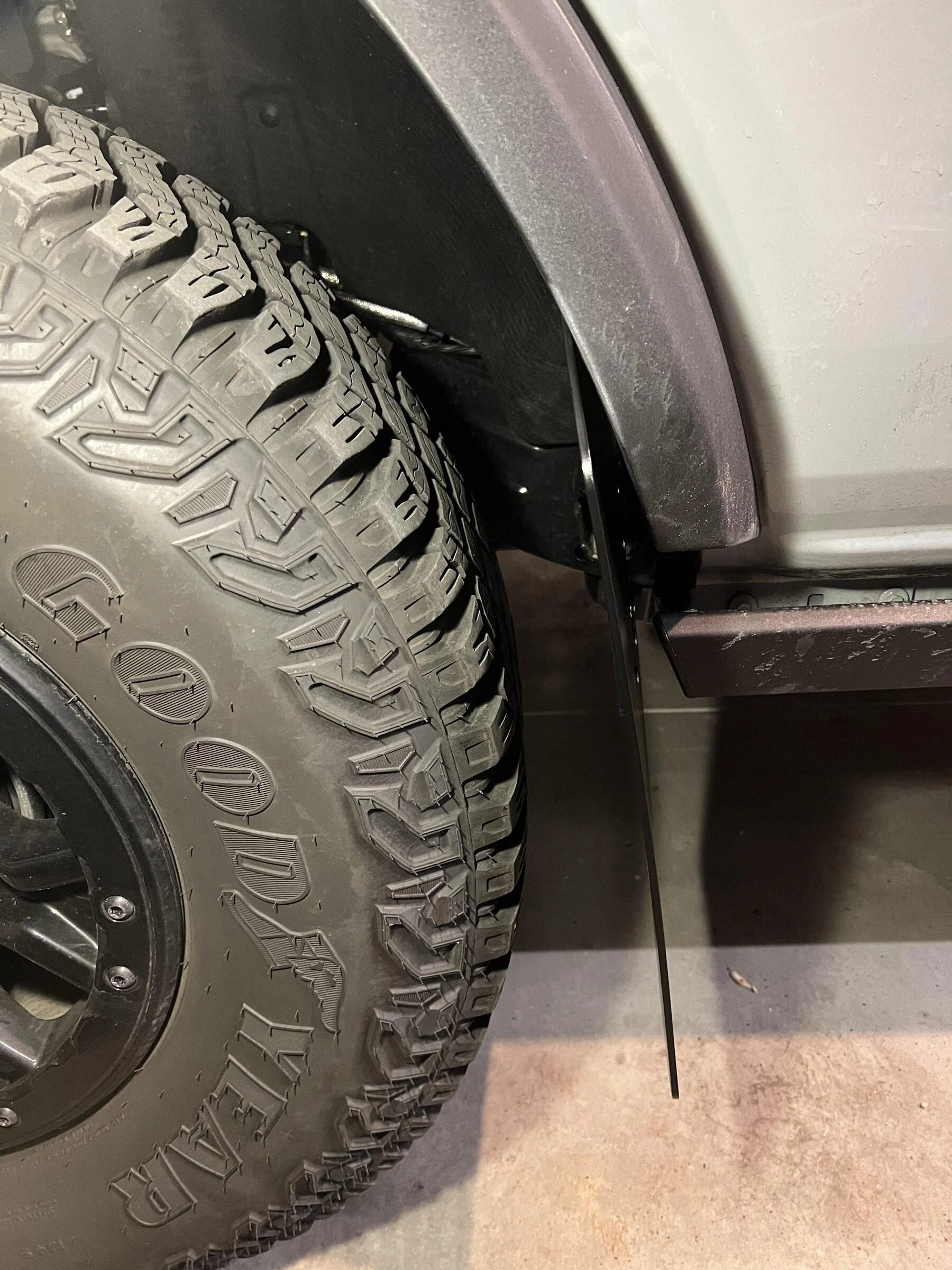

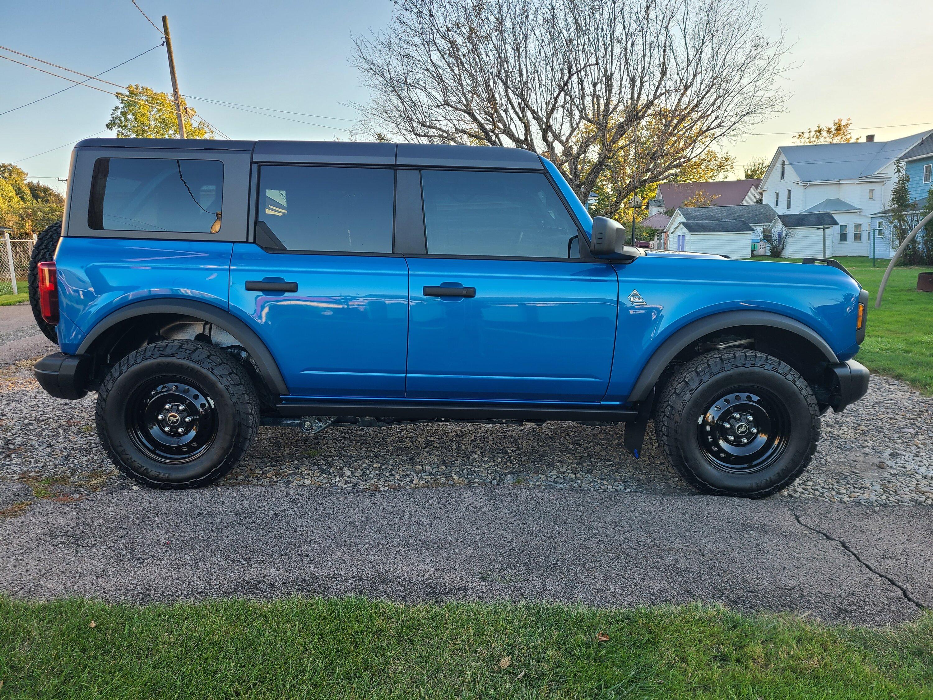

I've been messing with my rokblokz since I got them and they do sit crooked as you can kinda see in the pic. The inner part of the flap its farther back than the front. The only way I can see to fix it is to dremel out the slots more on the brackets where they mount to the crash bar. Pretty crappy for paying 270 bucks I think. I may dremel out the rear hole on the braket a little to see it i can pull it forward and straighten out the flap. Something I shouldnt have to do after paying that much. They do stop most rocks I guess.
Ford Bronco RokBlokz Mudflaps Review 20221011_175824

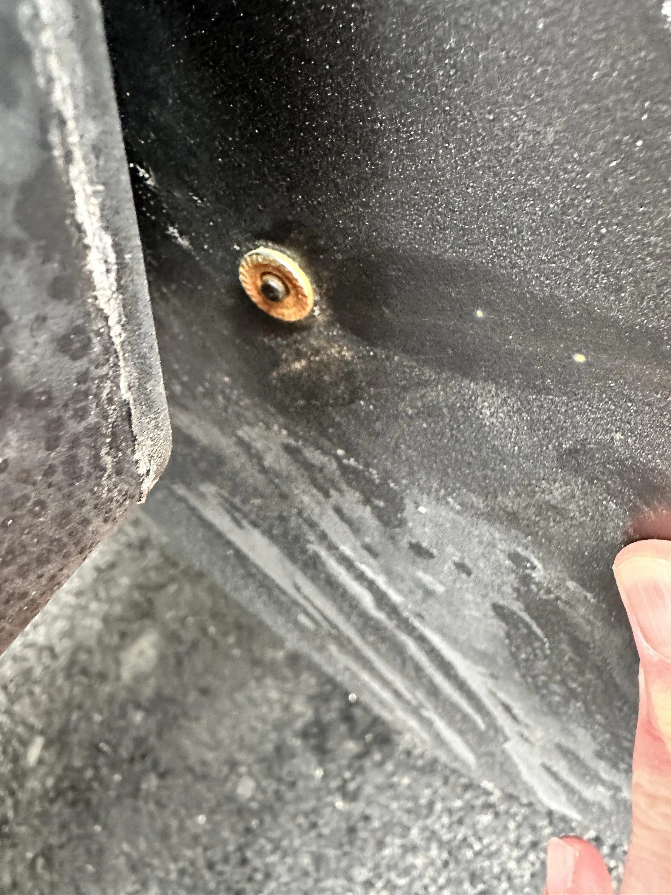

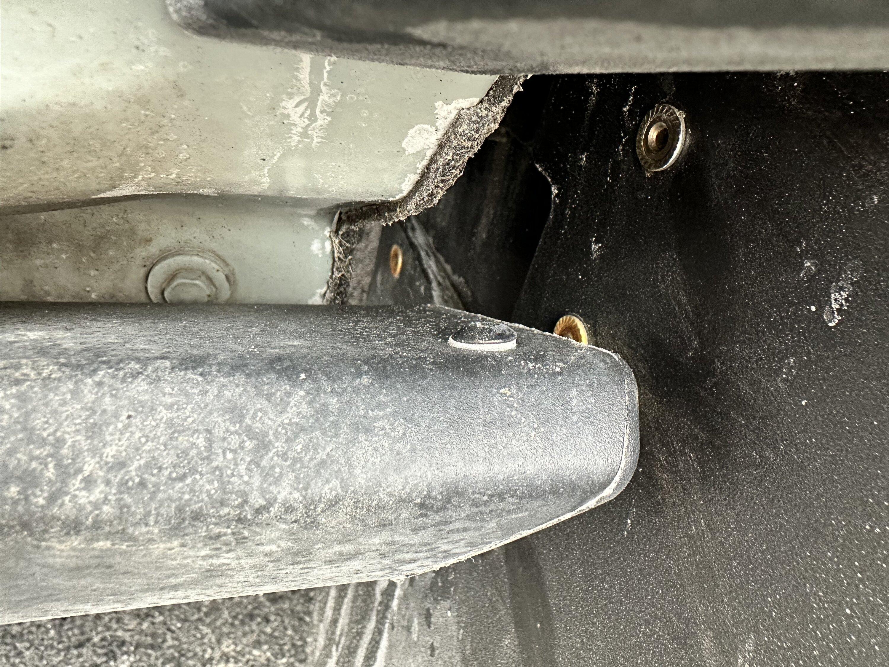

I ordered the fronts to try and combat the weather up here in the north for winter. Was happy until today when after less than a month the hardware is already rusting to shit. Not what I expected for that price
Ford Bronco RokBlokz Mudflaps Review B15E6F91-86BA-411B-BD5E-623823311C9E
Ford Bronco RokBlokz Mudflaps Review D5B74013-6CF2-45A1-BB89-E5578B69E1EB
