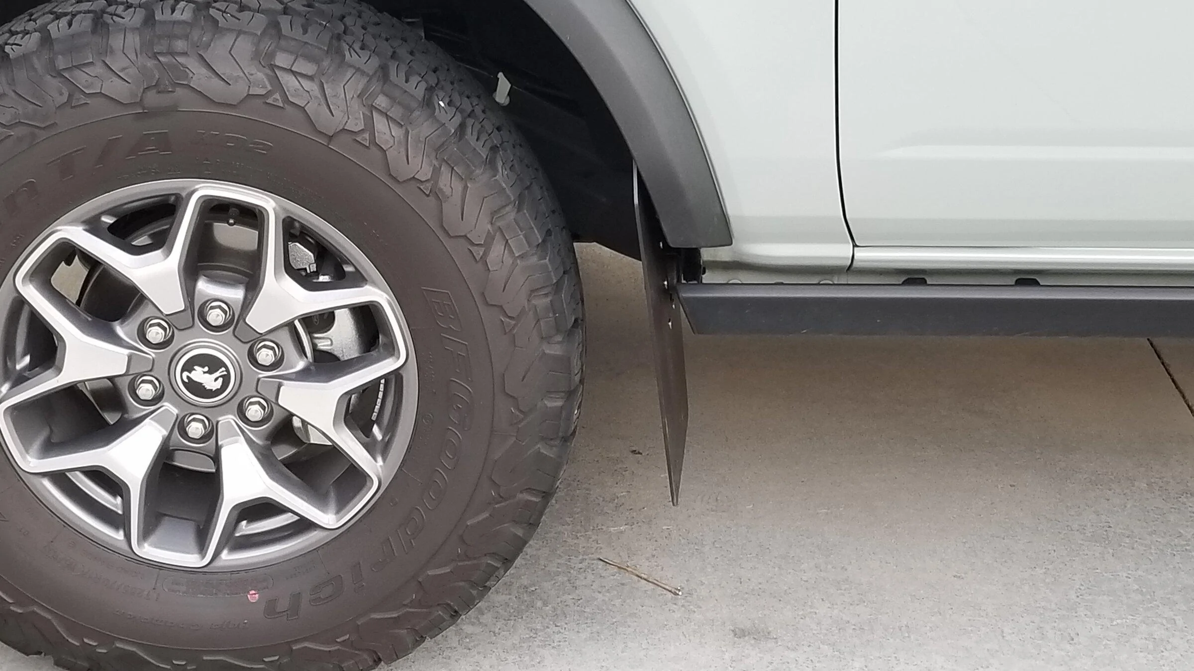

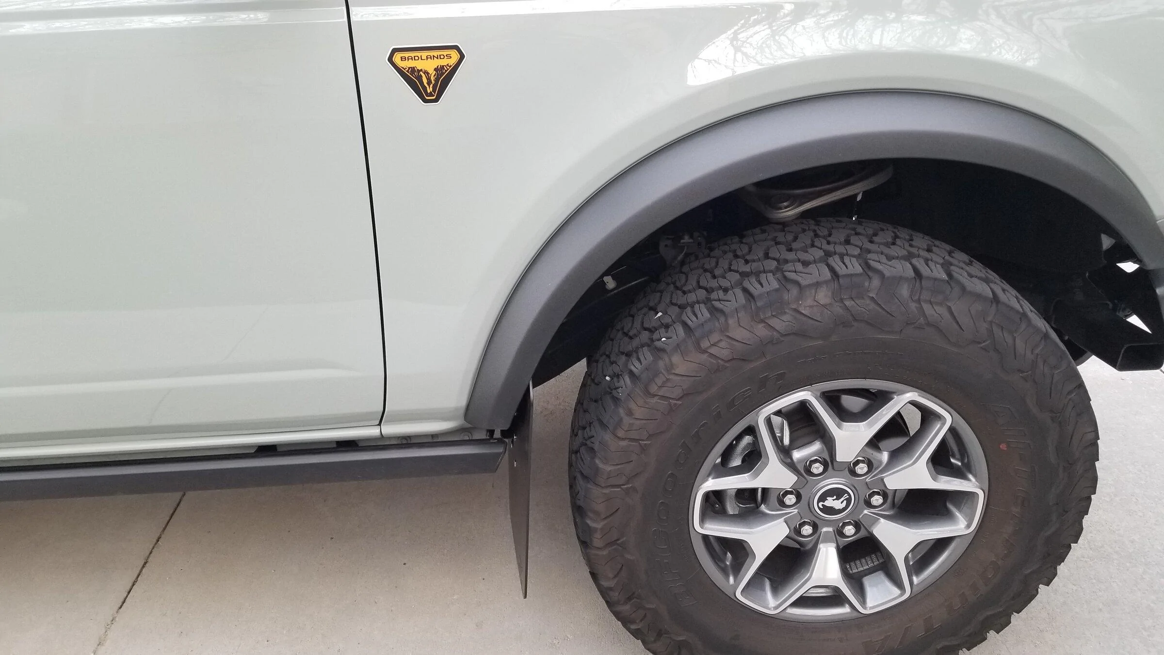

I hope I did something wrong here....cant get this to straighten out
Same here as well. It's due to the inside part off the wheel well and not being able to press the bracket further back to straighten it out. Gotta figure out if you are ok with it or not.

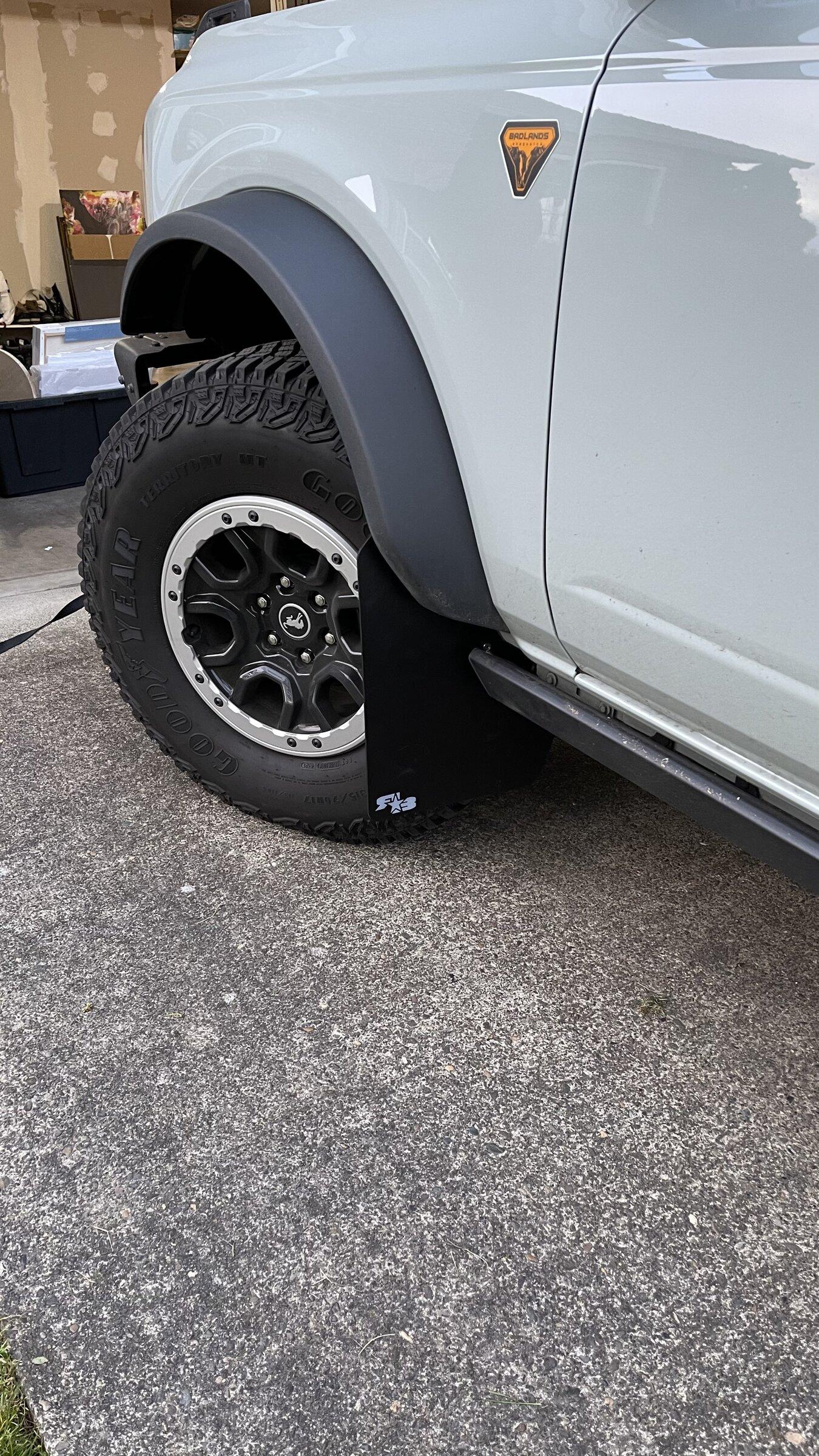

They’re on. Don’t look too bad/noticeable. I will still have them off 99% of the time, but if I’m about to go down a gravel road you can bet your ass they’ll be on lol. XL non-long. Can’t imagine what long would look like lol

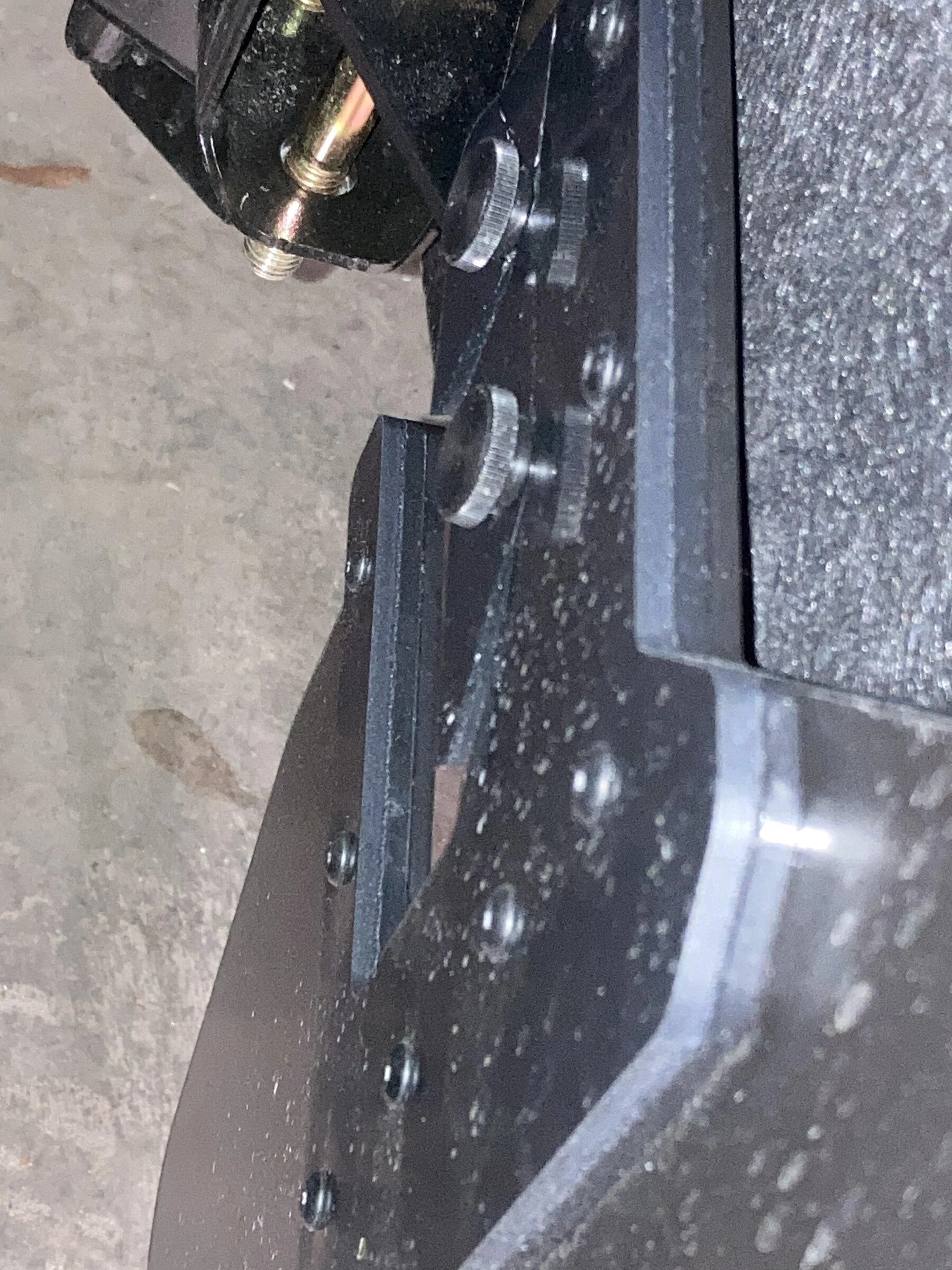

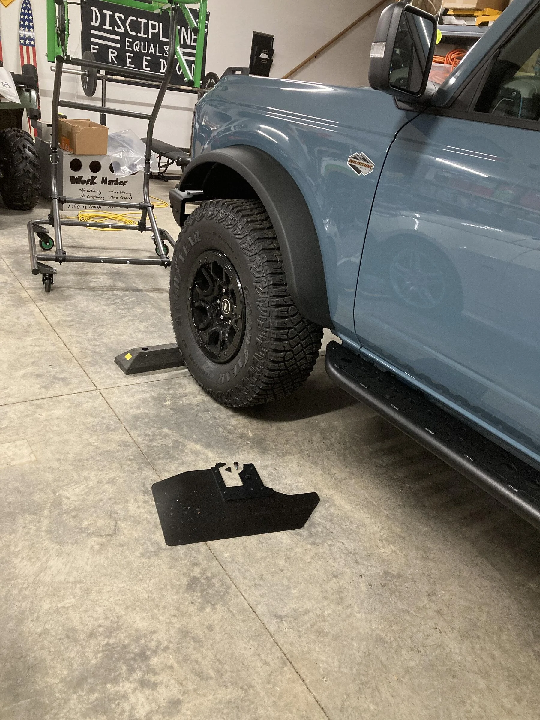

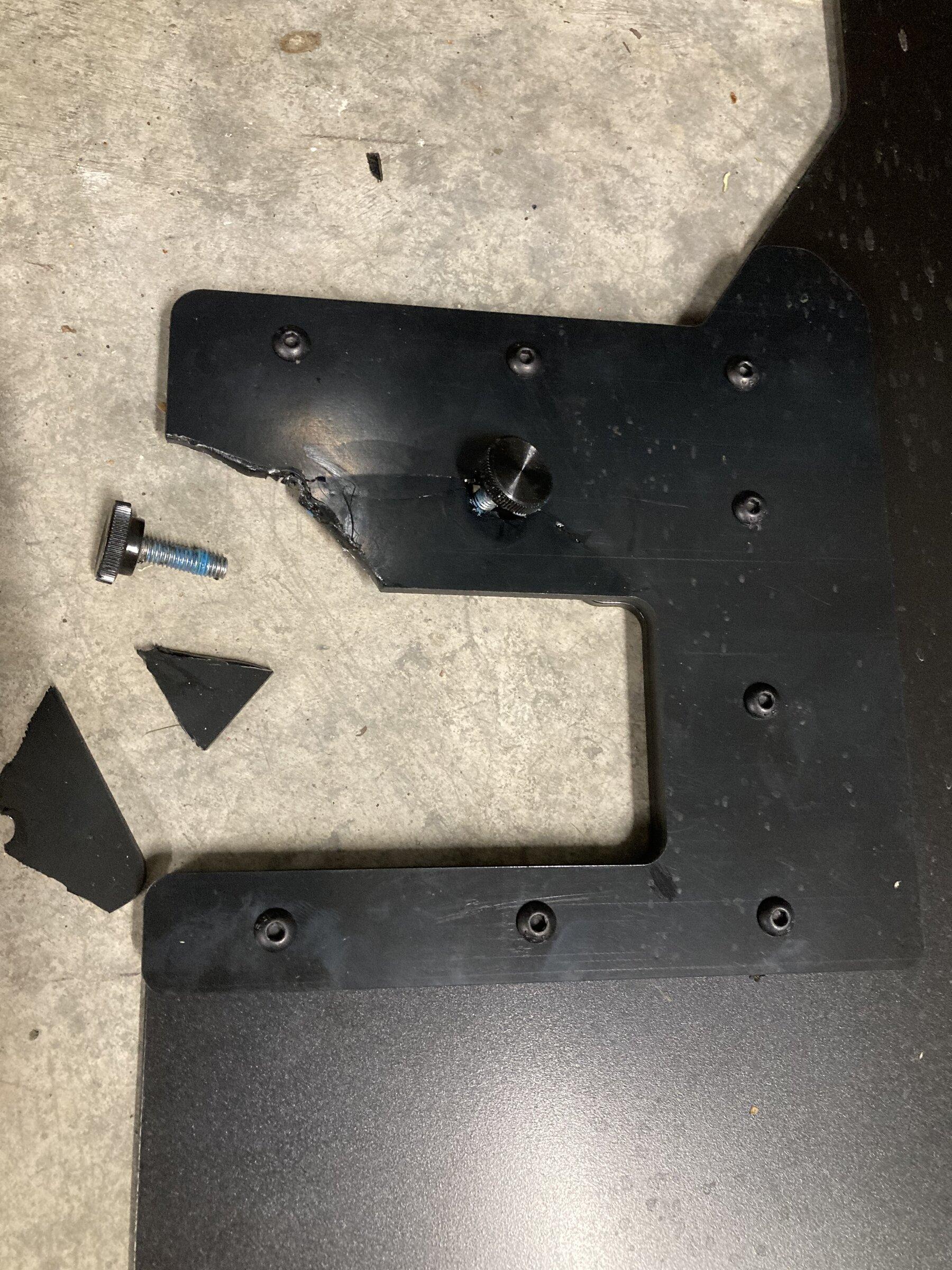

Anybody had this problem yet? The plastic cracked at the thumb screw holes.
Cracked on my first 3 mile trip to kids baseball practice.
I’m having a very tough time getting ahold of @rokblokz customer service and support.

Probably need washers to spread out the point pressure

looks like it cracked prior to when it came apart. Did you happen to notice if things were looking o.k. after you did the first install? One of those pictures looks like the thumbscrews are over torqued and cracked the material. Or the material is too brittle.

Yes I checked. Of course it is from one or both Over Torqued or material is too brittle. Either way……I set it finger tight……just like the other side. Too thin, too brittle. Probably should be a piece of thin metal.

It could be a problem with the plastic mixture used causing it to be too brittle and not flexible enough. I'm sure they'll take care of it for you. Give them some time to get back to you.

We did fix the original issue with wiggle in the front flaps finding that we received and therefore send the wrong clips to a handful of customer (most of which were sasquatch owners so it seems like it mostly affected those) and, as we knew it would, that has solved the wobble.
The broken plate posted by MillerBuilt has been shipped and that was a mistake on us where he actually got the wrong plate and a combination of the fact that the customer tightened the screws too tight.
We have been listening to all feedback received on this product, but we are not yet aware of any "issues" that would require a complete redesign or any "notable" changes. We have installed many sets locally and have had customers "thrashing" on their flaps to sets the design and we are happy with results thus far. We are constantly looking to the future to make sure our products are always great and as we find new materials and such we will make any necessary changes behind the scenes.
