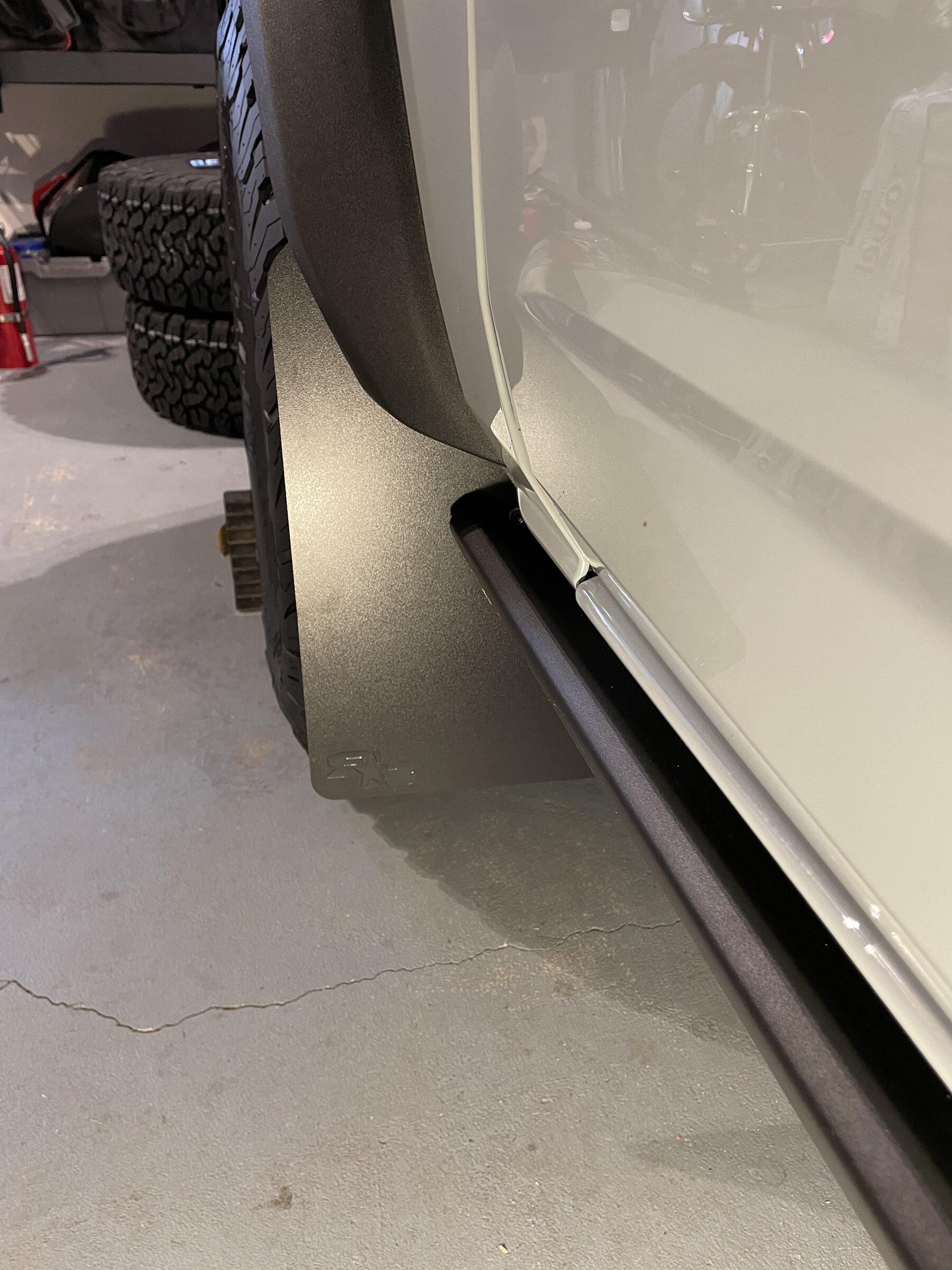

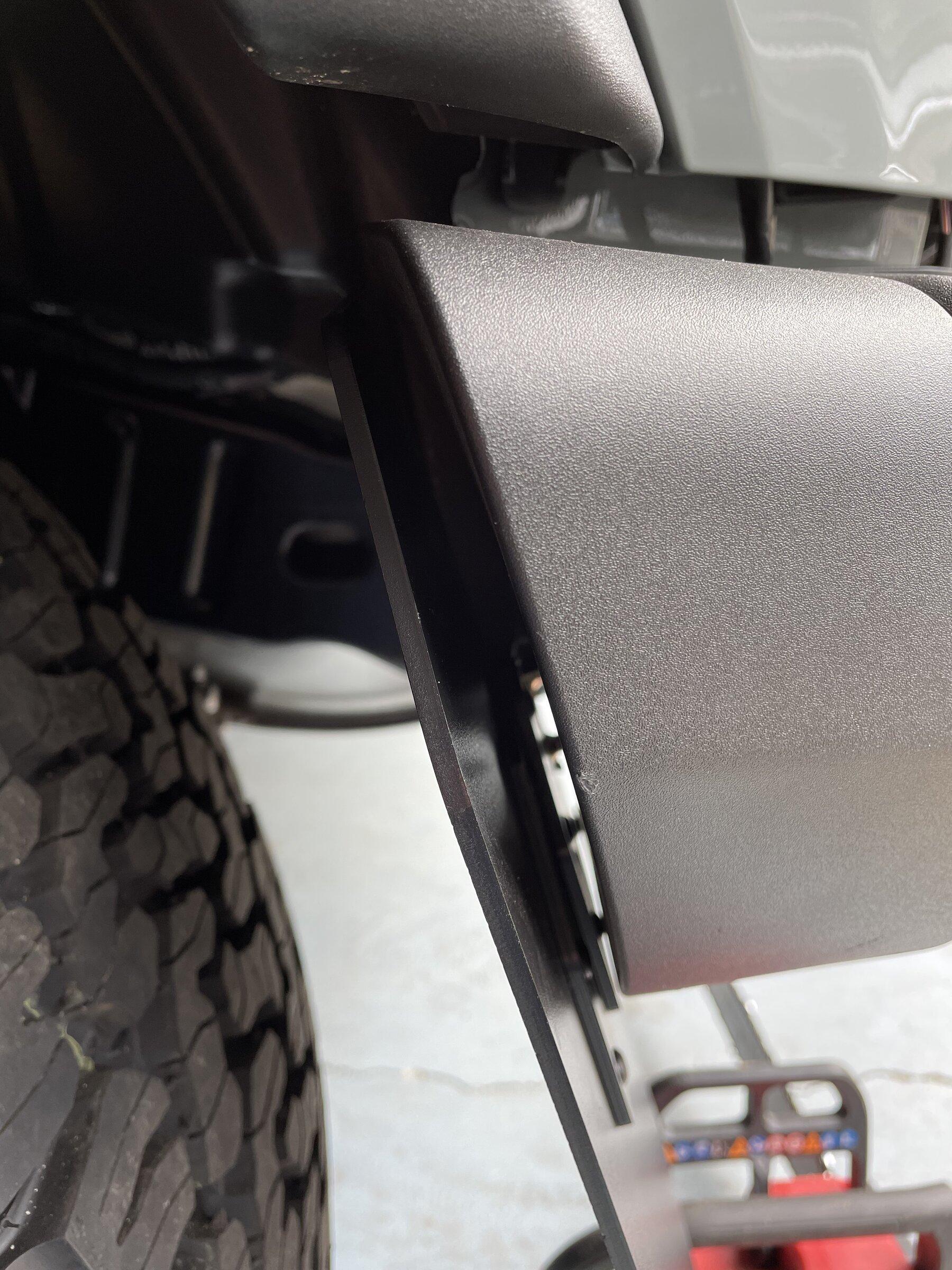

You wouldn't happen to have a picture of these offensive flaps, would you? I'd like to see just how ugly they really are.
Seriously considering cancelling the order for the $420 flaps if the Weathertechs aren't that ugly.

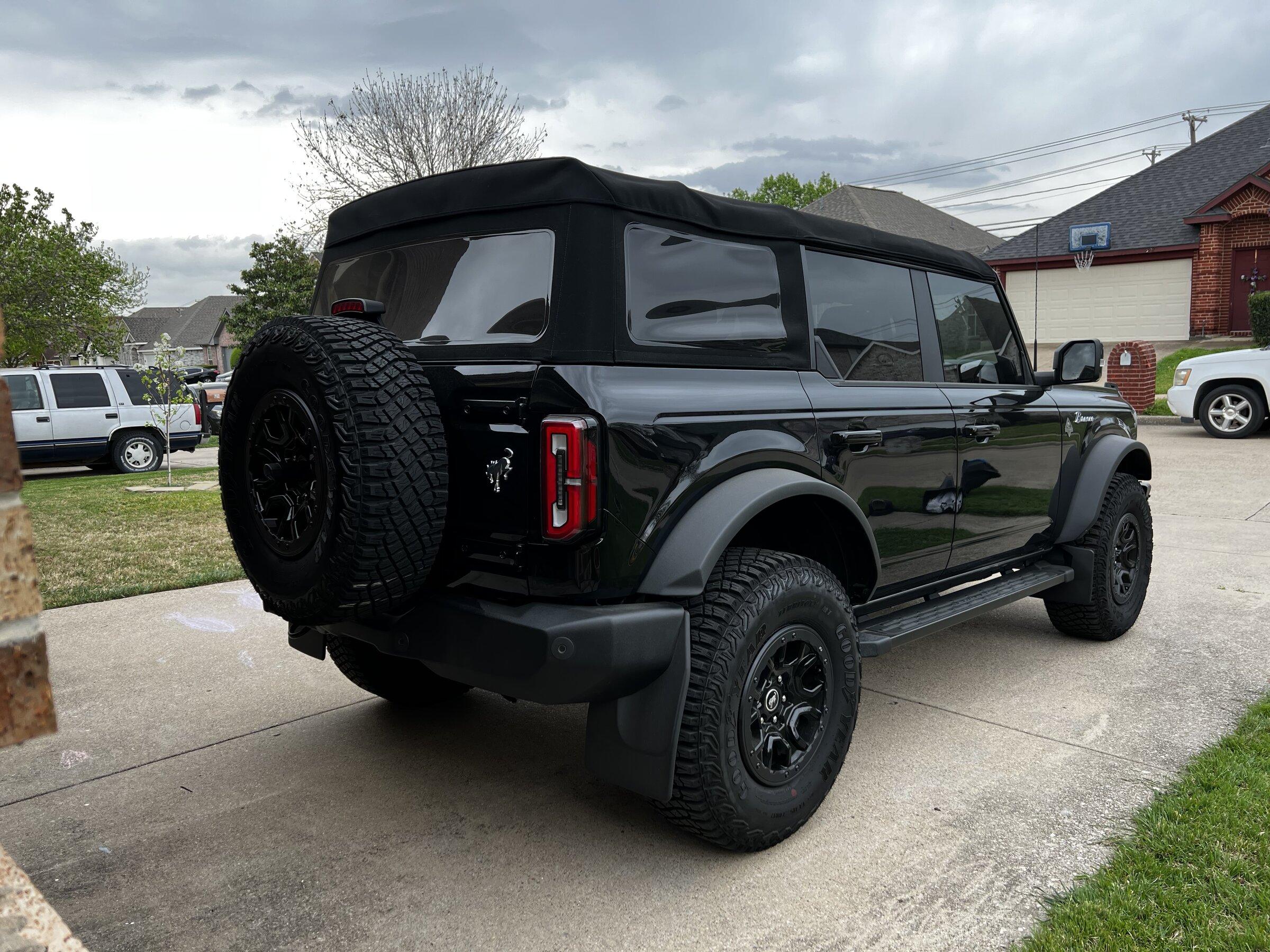

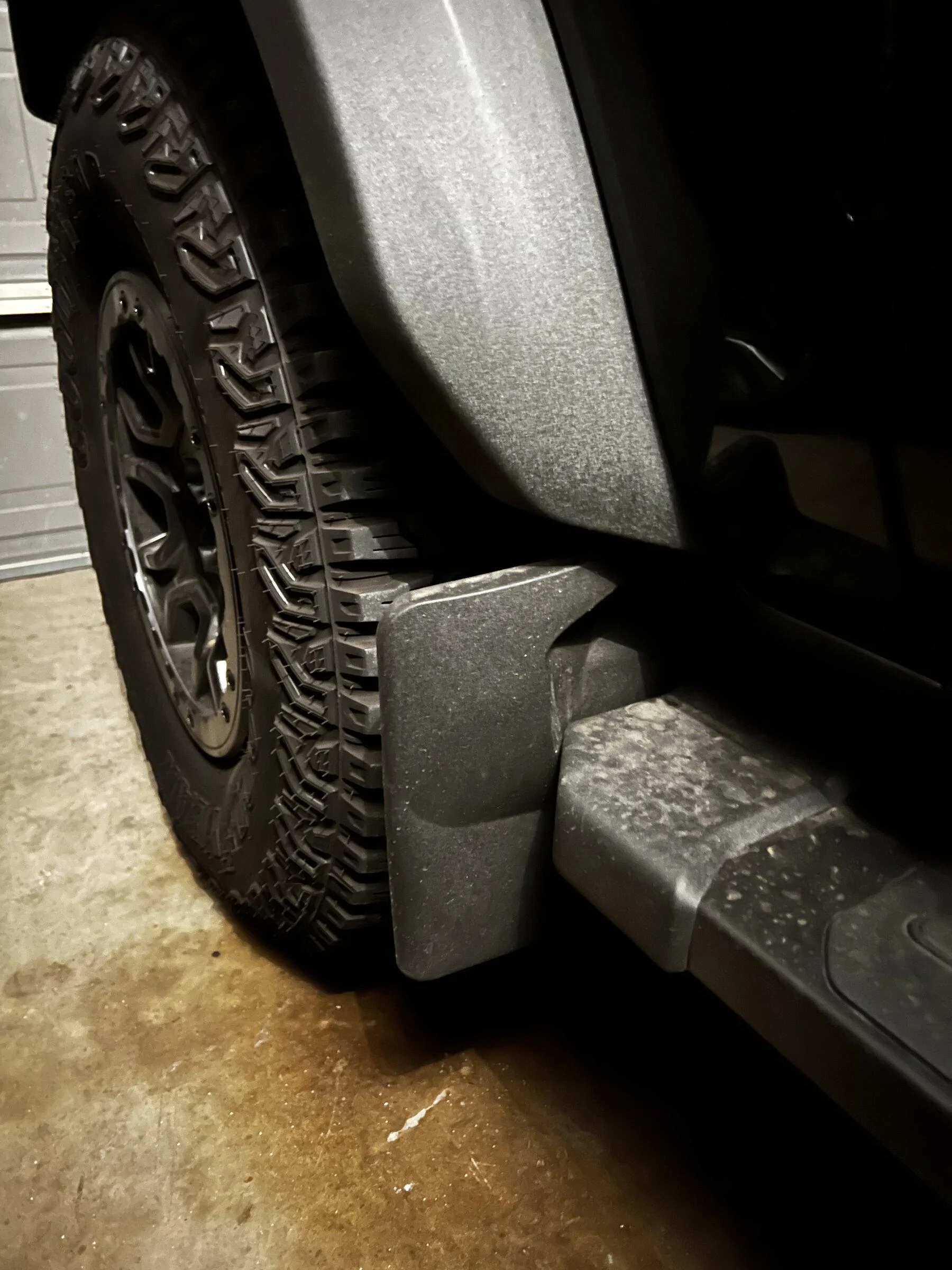

Here’s what I have. I’ll try to get a good one of the front flap

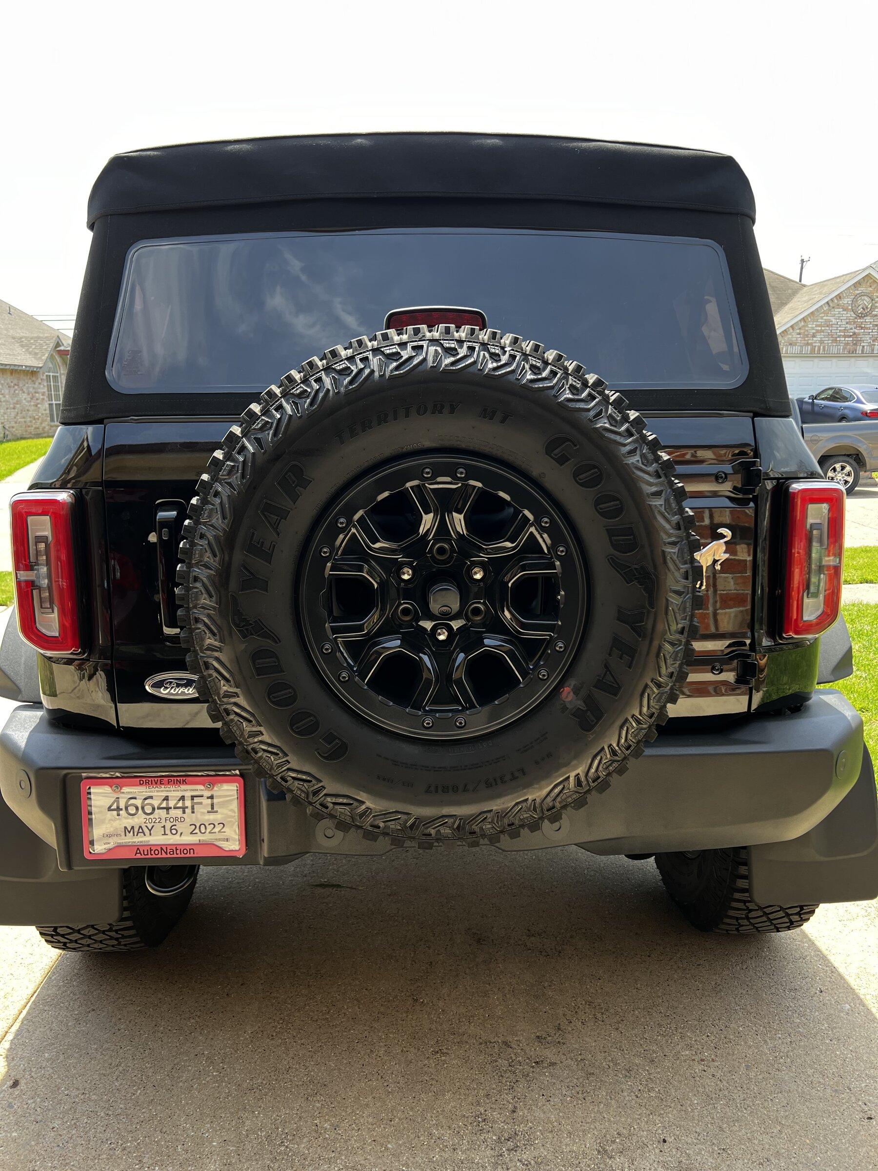

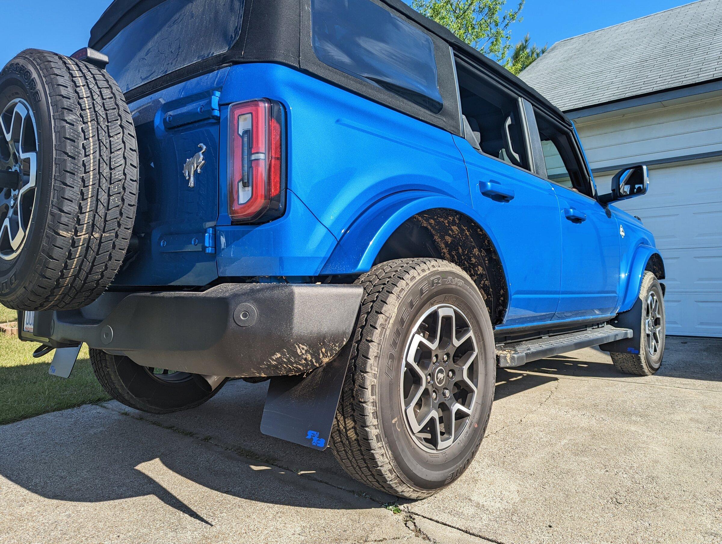

Received and installed mine today. Install went smoothly and they fit perfectly. Zero play and very snug.
Atrocious. Thanks for the pic. I'm tryin' to tackle the gap there in the front. My door handle is literally catchin' stones. Needs addressing before I end up with a re-dressing.
These look pretty good. Good competitor to Gatorbacks

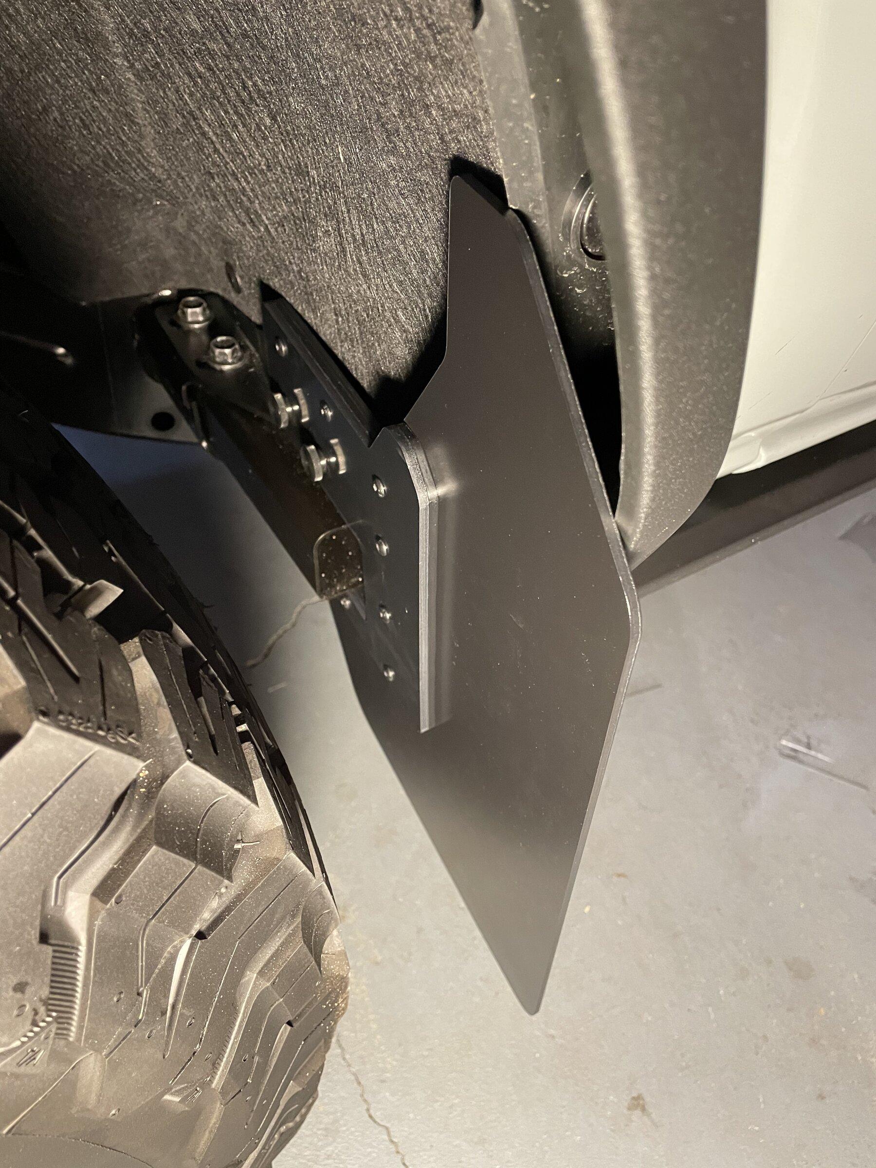

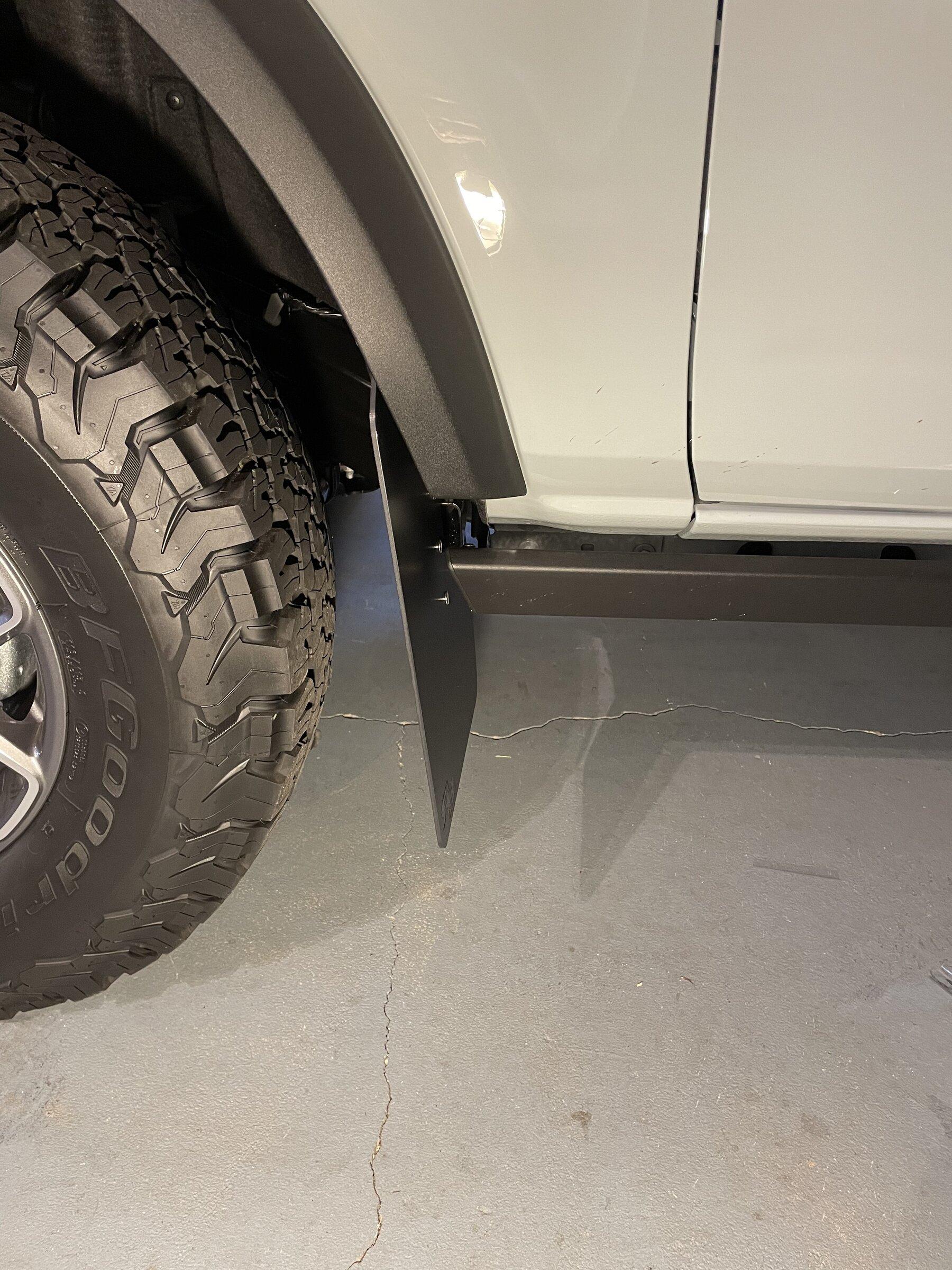

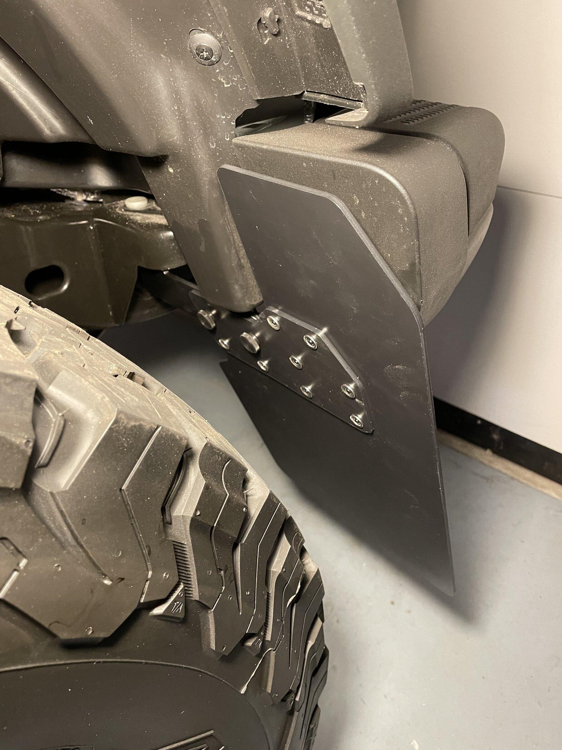

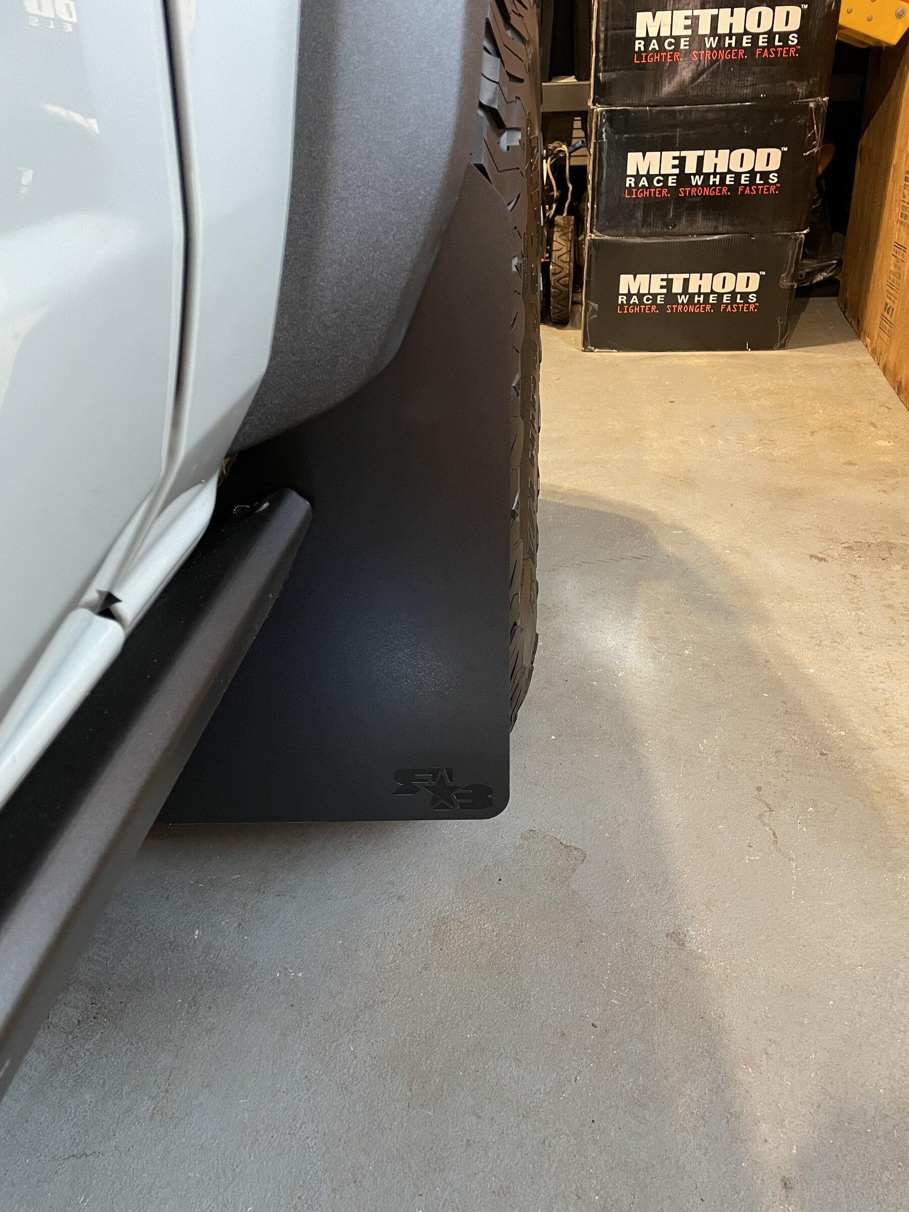

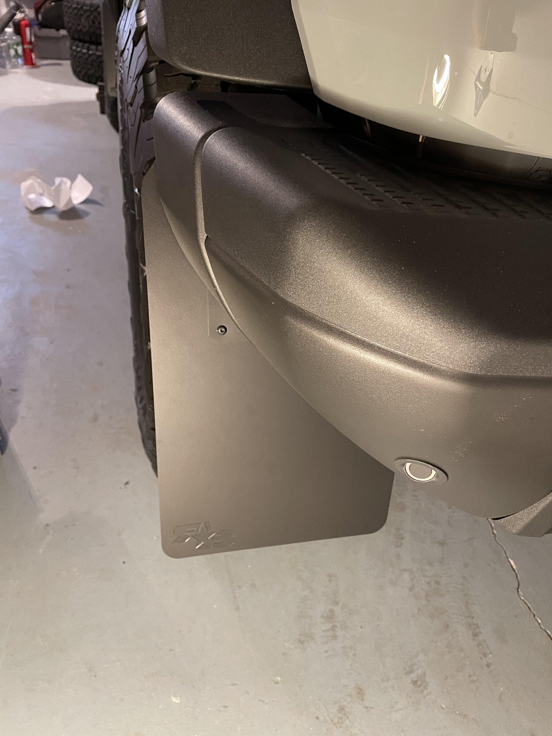

I installed my standard Rokblokz with crash bar on my stock badlands last night. I assembled everything on the kitchen table and then went out in the garage for bracket installation. I didn’t turn my wheels or remove any tires, I was able to install where it sat. The fronts went on just fine, The flaps don’t quite mount at a parallel/perpendicular angle to the rest of the truck, the inner edge angles back a bit. I tried adjusting the brackets, but they were already maxed out for angle. I don’t have any movement in mine like the OP here. The passenger side flap sticks out about 1/4” farther than the drivers side flap, which I prefer for additional coverage, I couldn’t adjust the drivers side out at all. When I swap to my +35mm wheels I might need that little bit more coverage. The rears bolted on just fine and are very solid. I slid them out as far as they would go and it’s just right. One of the body mount bolts requires a small socket with a narrow universal adapter to get back on without scratching the bracket. On the angle of the rear flaps, Rokblokz could reduce one of the angles on the brackets and the flaps would sit closer to vertical. I thought about straightening mine with a vise, but I didn’t want to damage the powder coating. Overall I would give these a 4 out of 5 star rating, with the fronts getting 3/5 and the rears getting 4.5/5. The fronts could stand to feel a little more solid, be square to the truck, and have some adjustability. The rears could have the bracket angle reduced so that the flaps don’t kick back as much. I would also use all stainless hardware for assembly (not sure if the current hardware will rust) and throw in the 8 screws and washers for those looking to ditch the quick release knobs.

I think they look really great. Yeah the front could skoot out just a little but it does cover the tread. Is all the prior reports of wiggle, looseness, etc gone? You got new hardware?
No wiggle on mine. All my nut clips were the gold ones, so updated I believe. Mine are non SAS, so that may also make a difference.

I get this is a 1st gen aftermarket product, and I assume they have some fine tuning to do on design. But OCD kicking in, so I must ask: 1.) Can the front flaps be adjusted so outside edge line is same as Sas fender? 2.) Can the angle of front and back flaps be made to match?

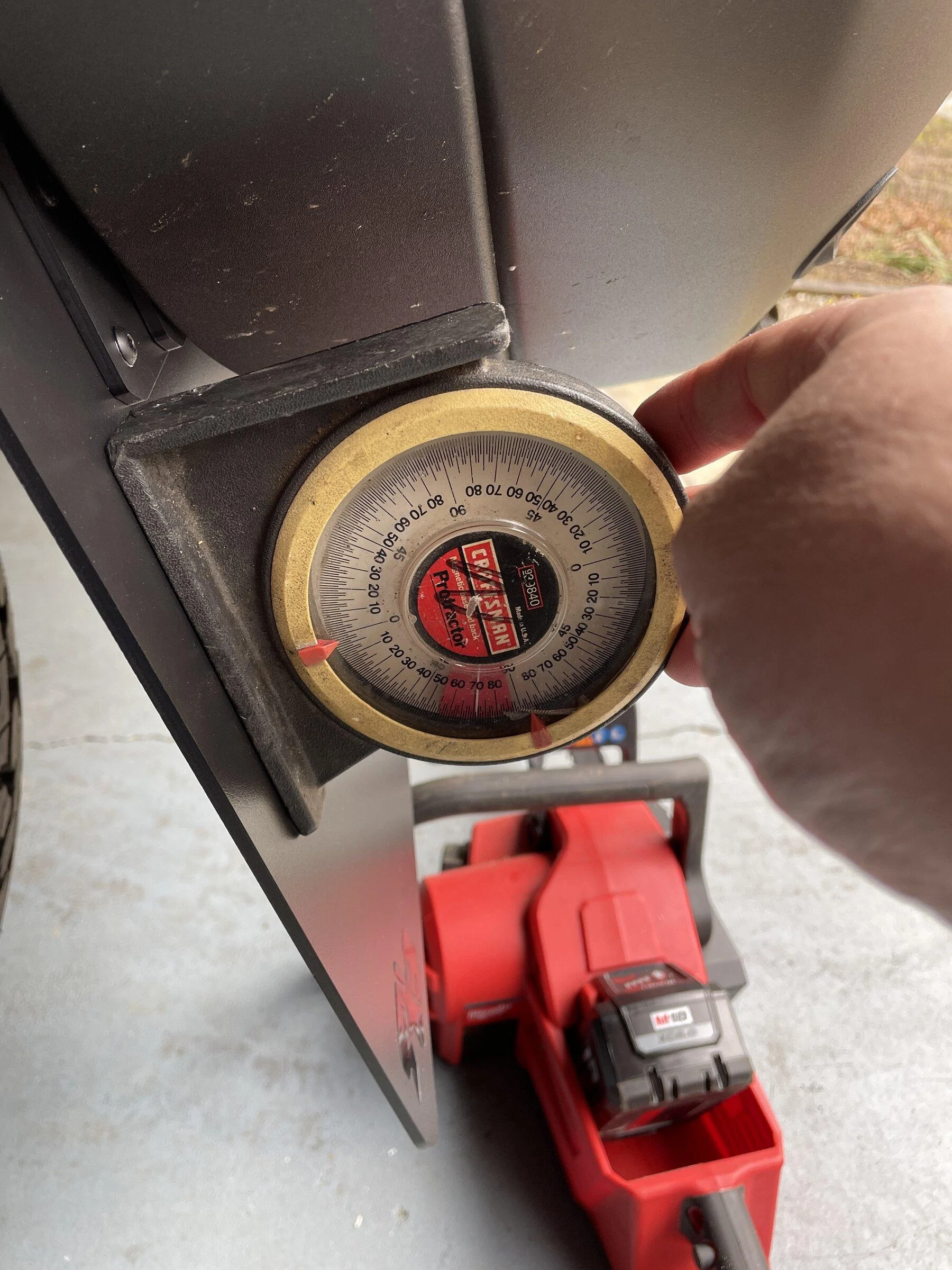

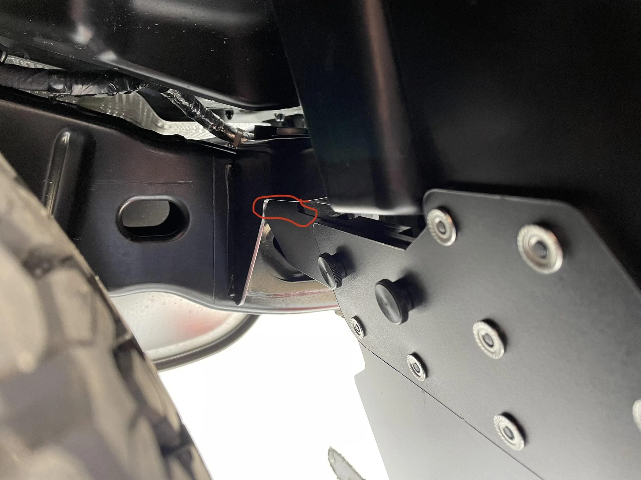

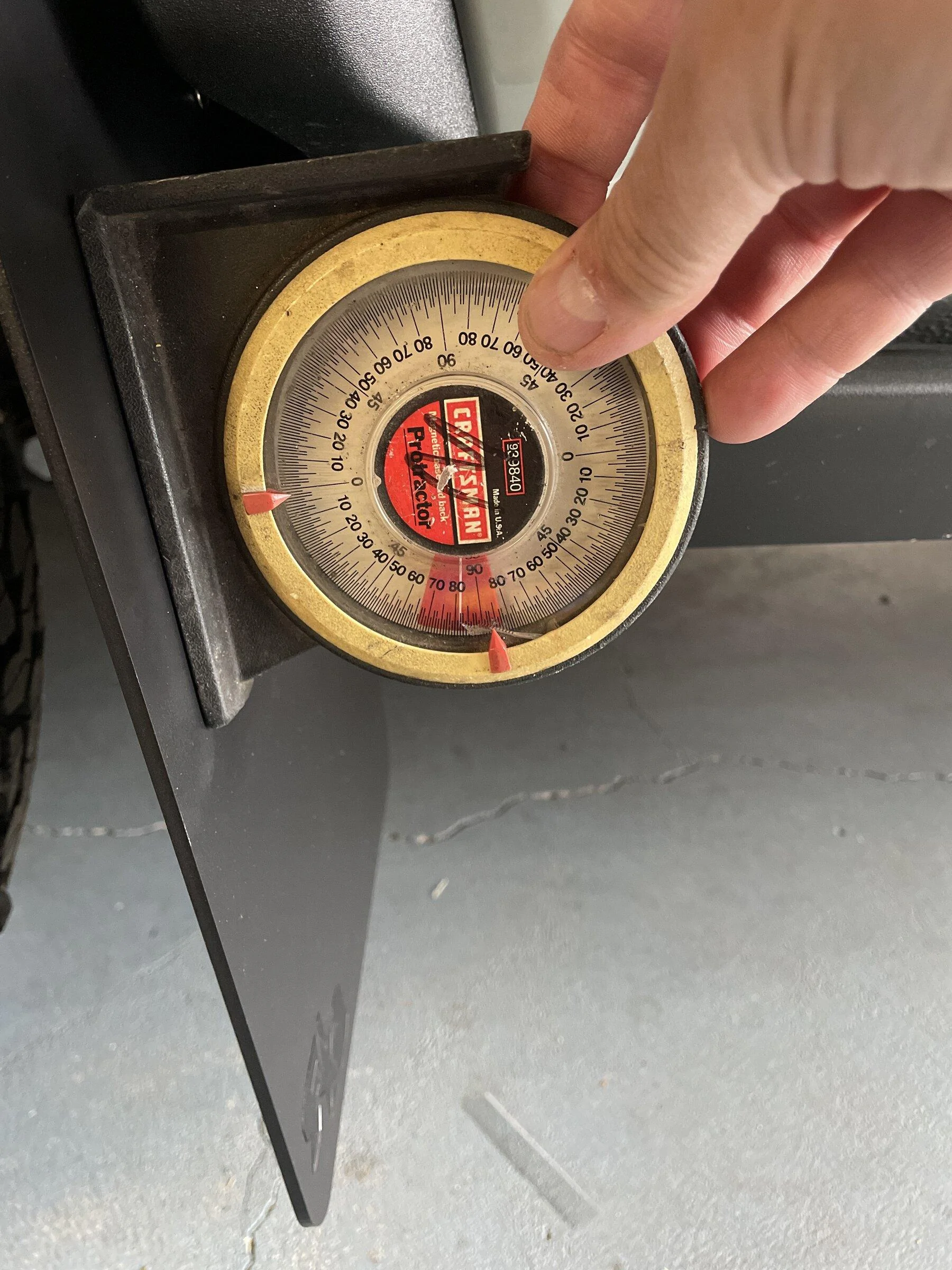

The front flaps are not adjustable, SAS uses a different bracket and flap that is wider to line up with SAS flares. The angle of front and rear can not be adjusted unless you are willing to relax one of the bends on the rear brackets. The front flaps are at 80 degrees, the rear are at about 72 degrees. The bend is circled in the third picture. There is plenty of clearance for the flap tot he rear bumper to straighten it.
