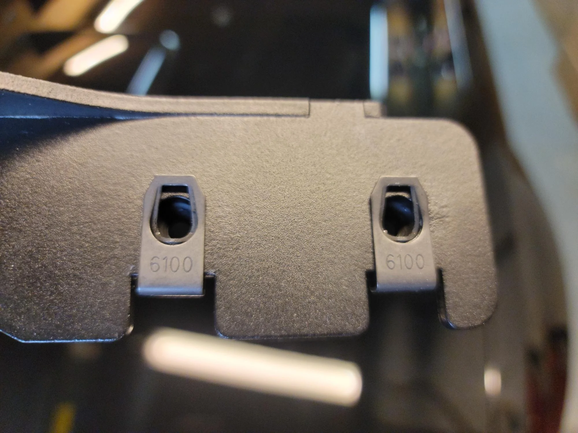

Are these the bad clips?

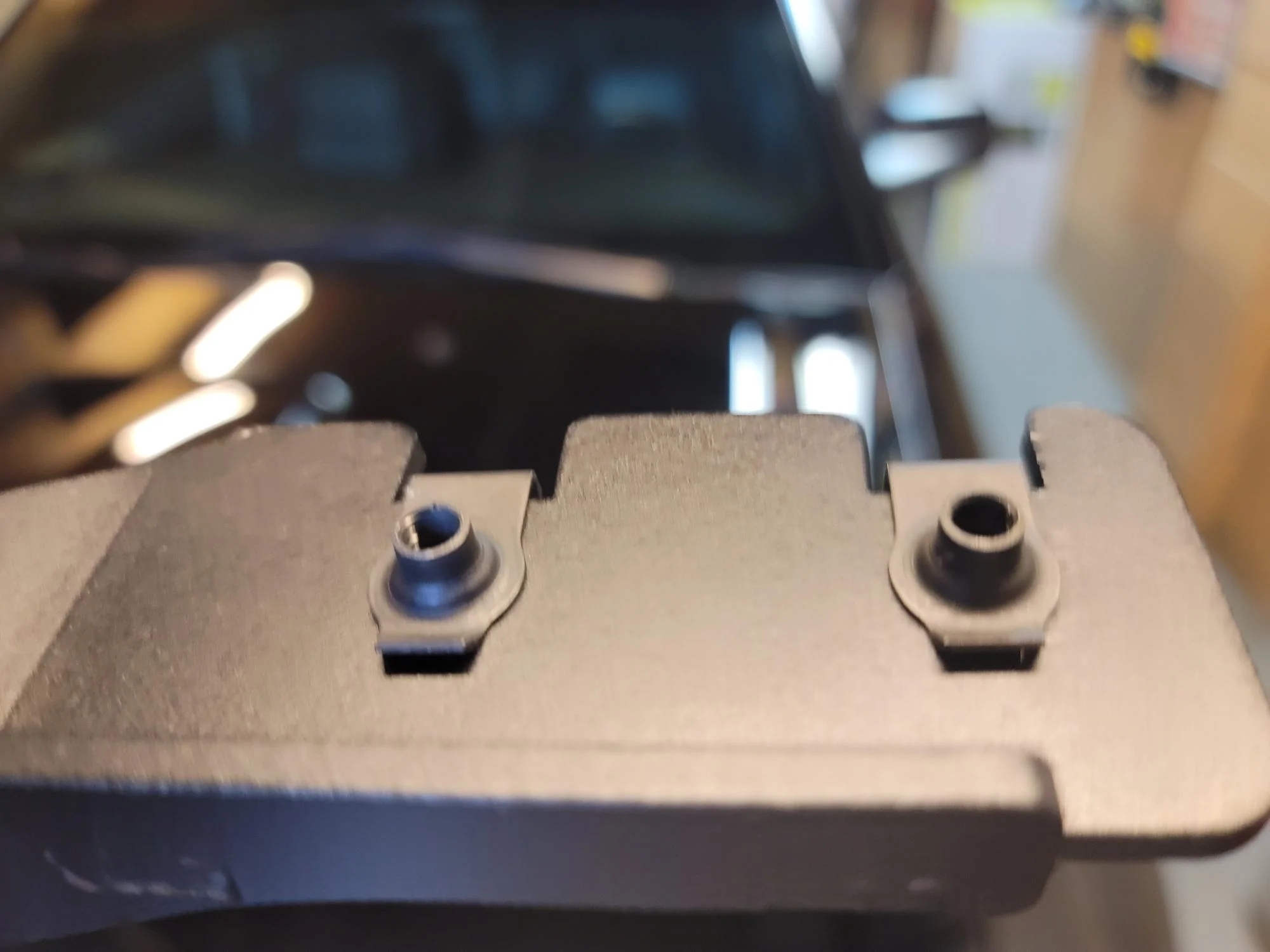

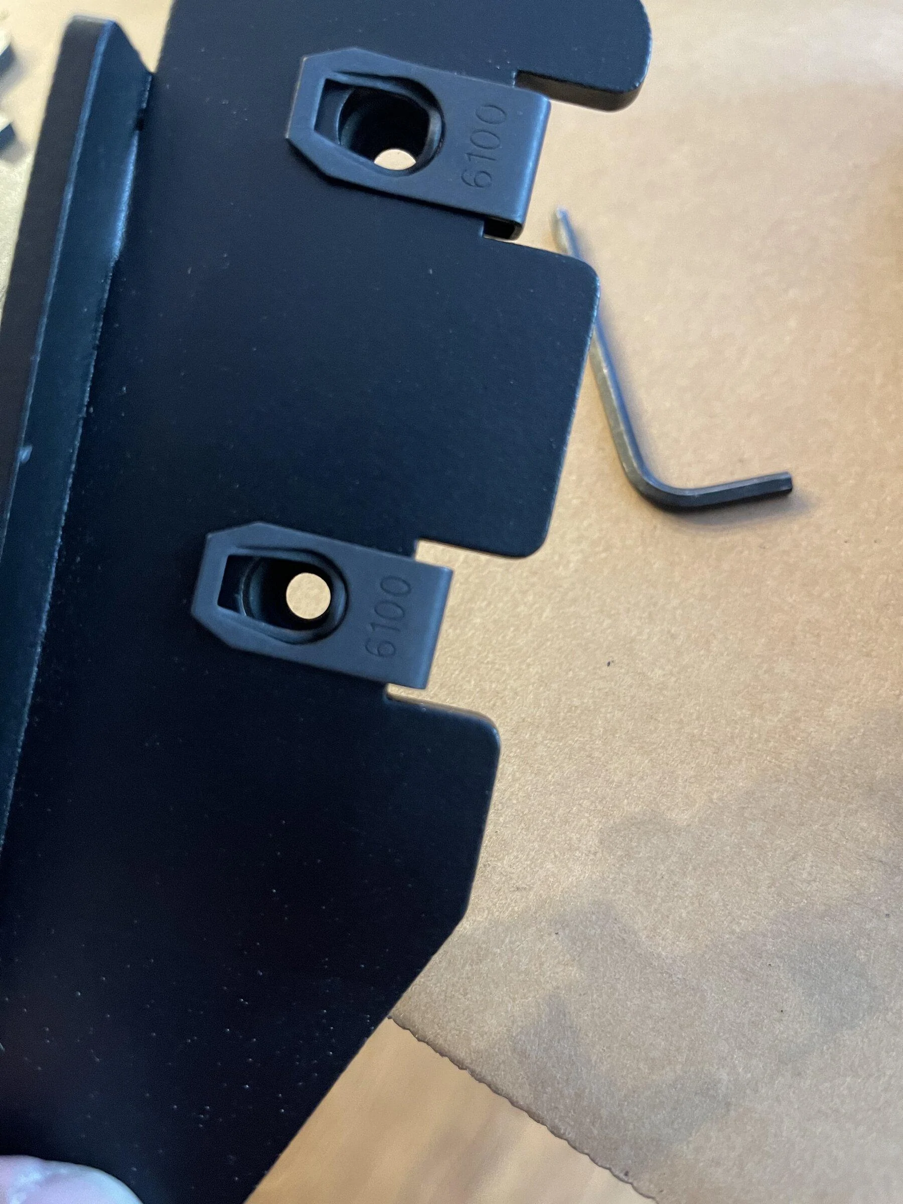

Mine are black and say 6100 on them, Brook at rokblokz said mine were the wrong ones.
Ford Bronco RokBlokz Mudflaps Review 997CAB3B-C341-4C13-AFAD-4A8E84A9046C
Ford Bronco RokBlokz Mudflaps Review 8FC48302-6712-43B1-9B84-E16DE3AF9B0D
Bingo. I have the 6100 black clips too.

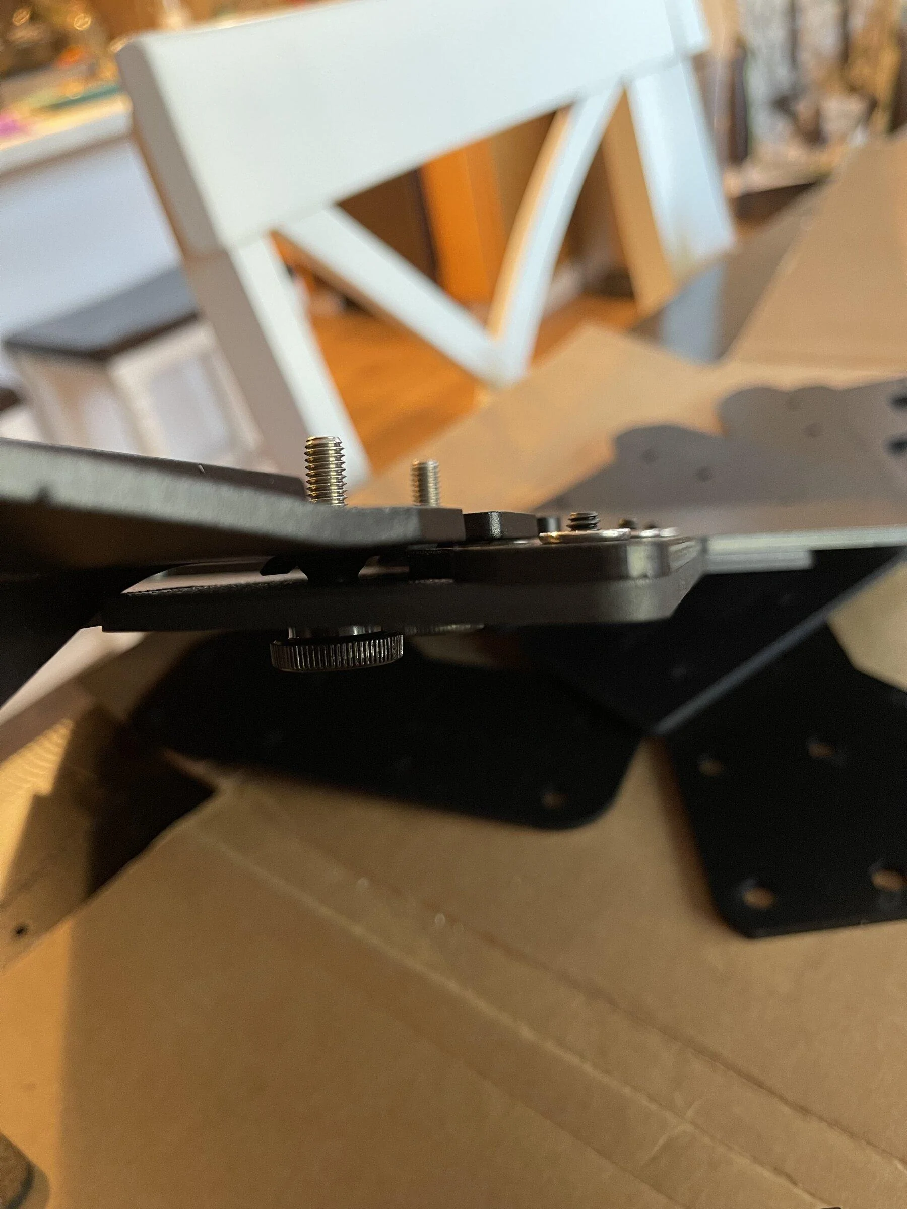

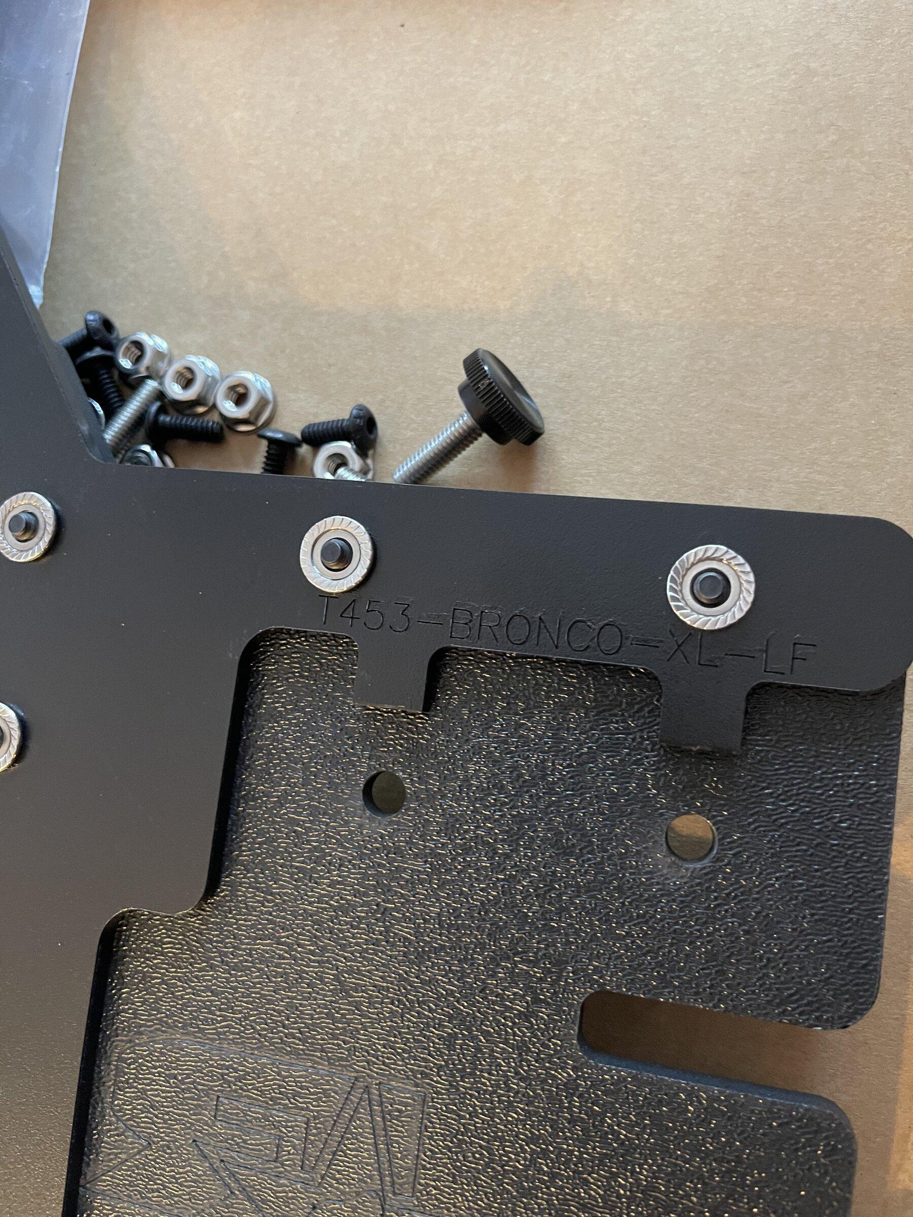

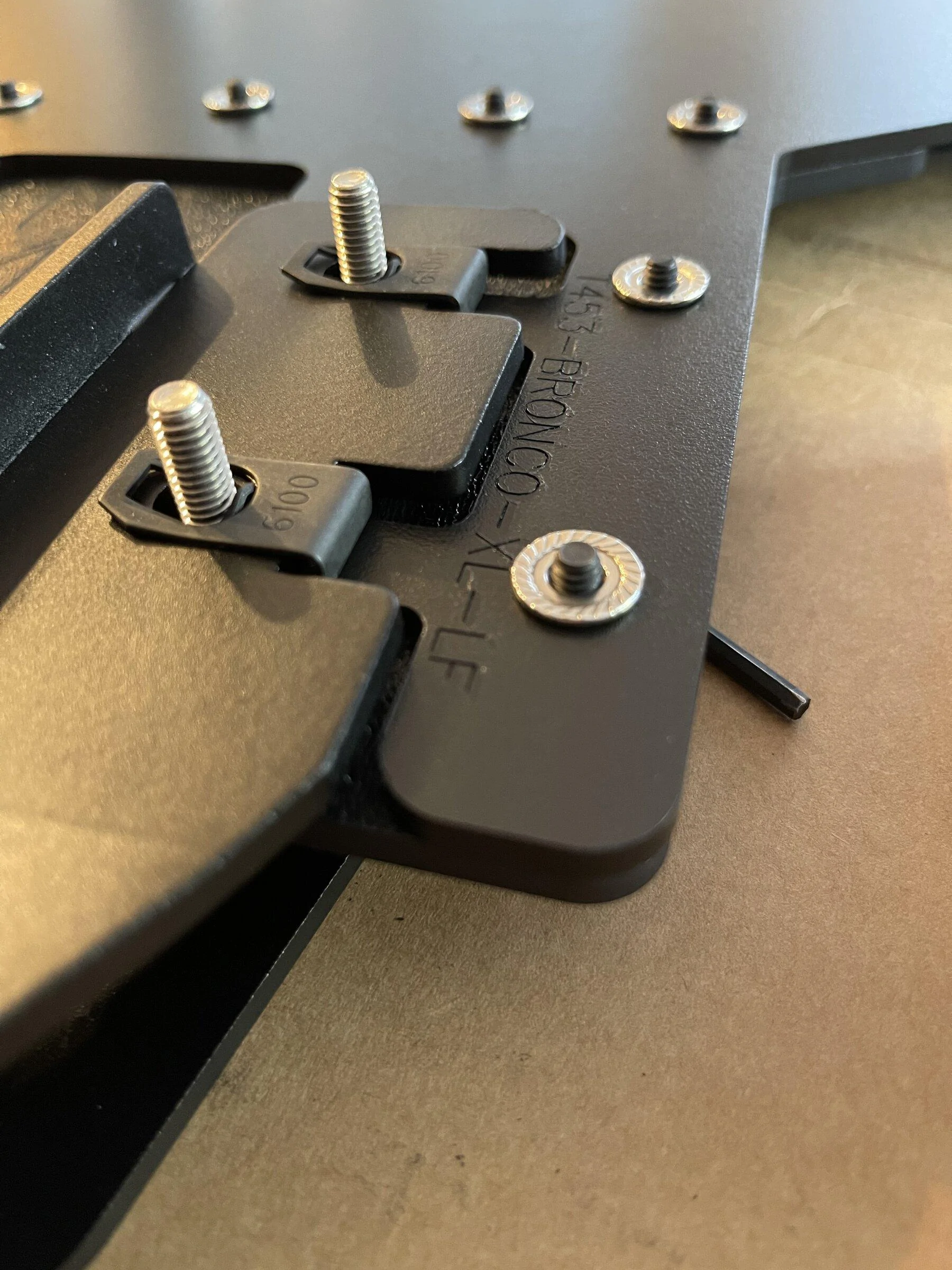

For people that are curious, the black clips do not allow the bracket to recess into the flap. The clip length is a hair off and the diameter of the clip thread nub is too wide to go into the flaps pre drilled hole.

With these pictures you can see how the flap “keys” into the bracket. And the clip length interferes with the bracket “key” by about 1/16”
