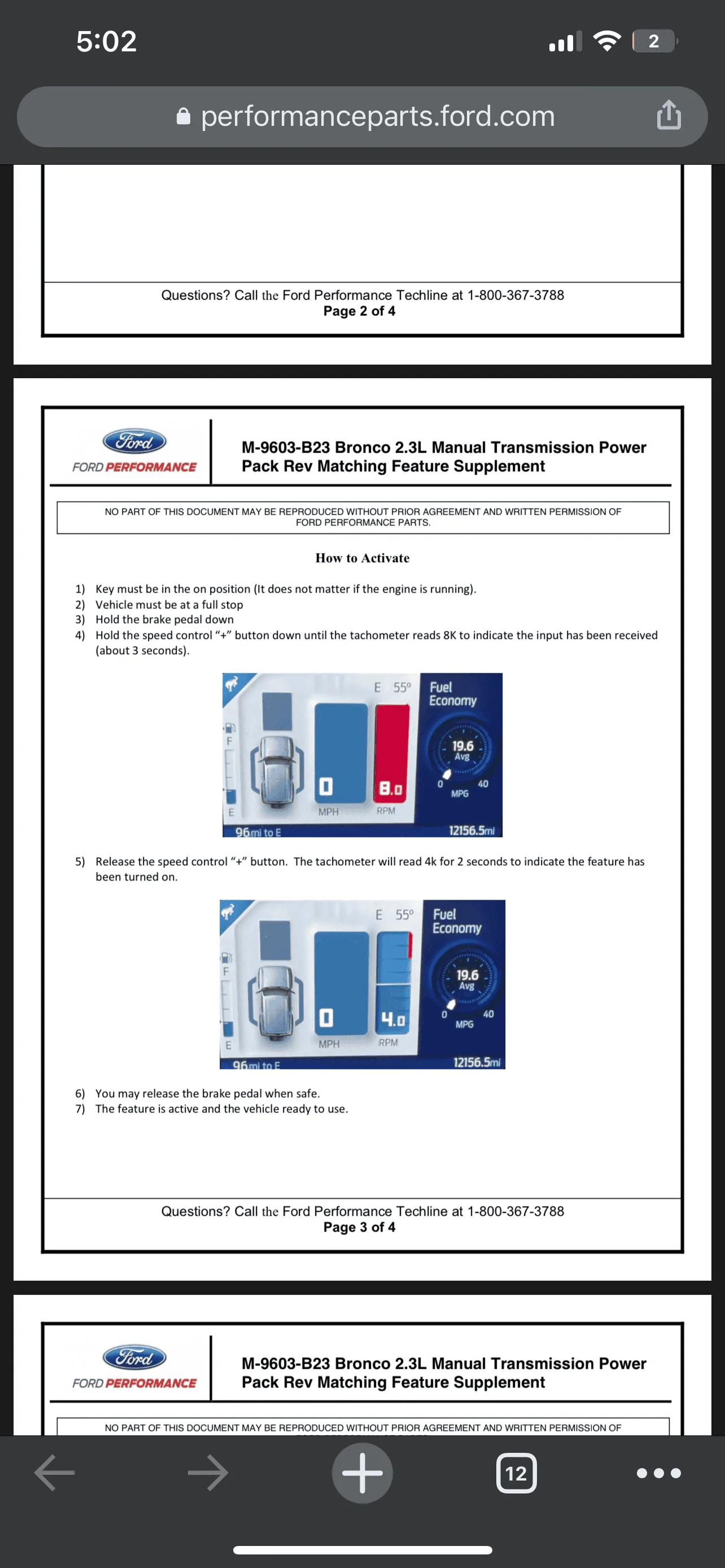

Has anyone tried turning rev matching on using the method described in the ProCal 4 installation?

Speed Control Button? That’s on the Ford device itself, no?
redone17
Mar 6, 2021
75
4,774
5,207
Cold Spring, NY
2021 Bronco, 2020 Ranger
Could mean the +/- for cruise control
Oh, duh. Good call.
I can give that a try. I still have everything enabled via Forscan. The toggle button is greyed out in settings though.

I was wondering if it could be activated with the Procal unit without purchasing the tune and lethal performance said no.
