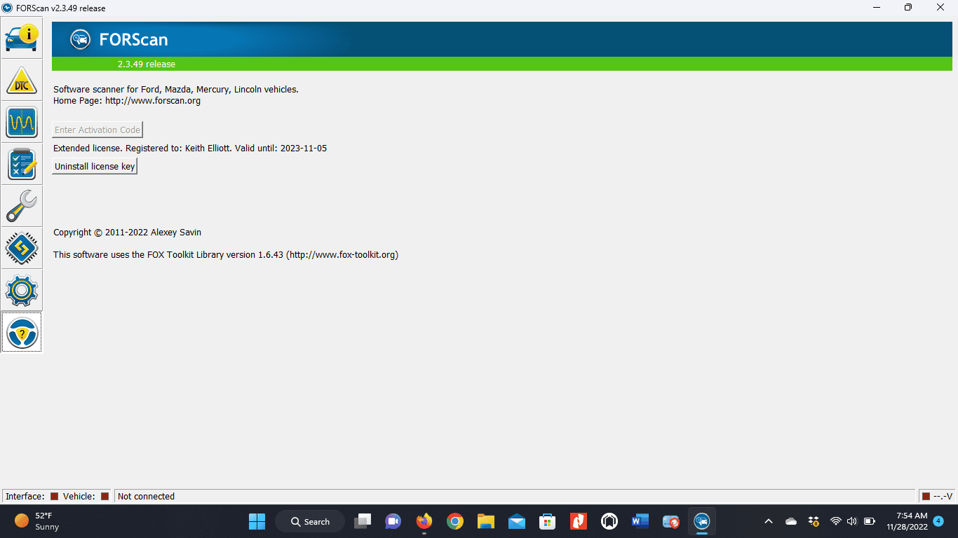

Which version of Forscan? For auto start/stop, you need vers. 2.3.4

how do i determine the version of forscan?
Will only vers. 2.3.4 work or is the latest vers. be good to go?

Latest version is 2.3.49 That should work for auto start/stop.
