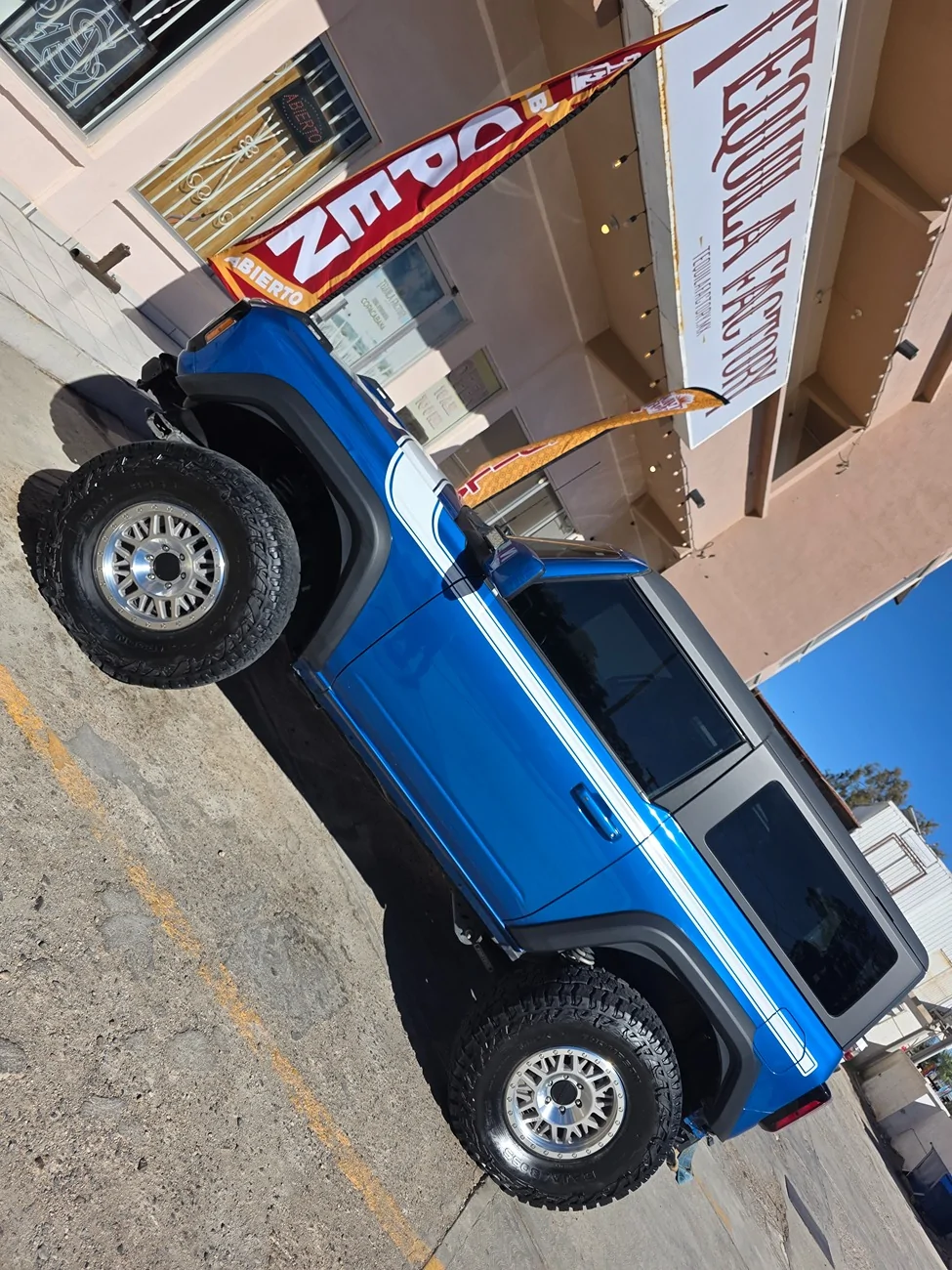

Bigmeats....is that your Bronco? I'm wanting the short cab for mine! What flares are those?
This is mine.
Ford Bronco Need help with FORscan 1000015410
