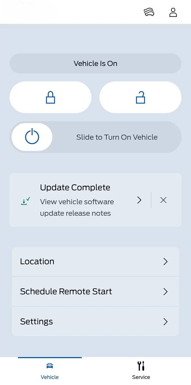

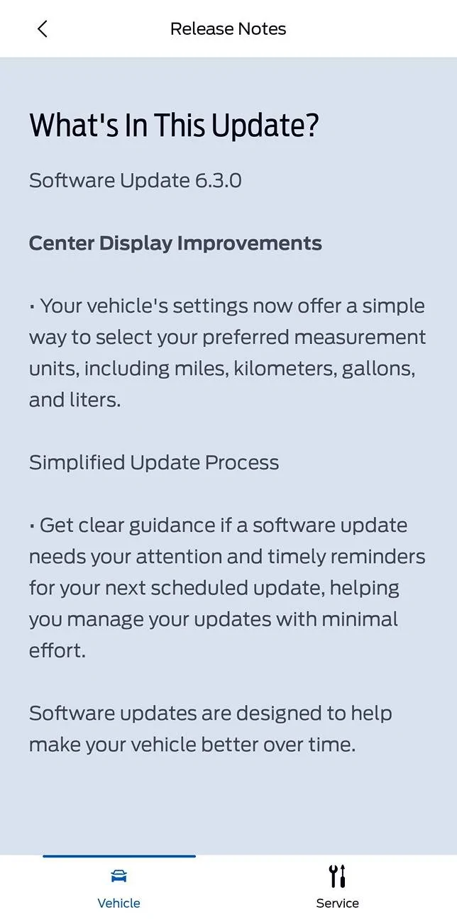

May be issues with the latest software update. Early today, 09/29 my screen went black just as I was attempting to enter info into navigation for a trip I had to make. Blank screen, I did have a radio connection but could not control it. Shut down the vehicle and restarted and only got the Bronco graphics and then back to black. After the Bronco was shut down for about 10 minutes I restarted, and the screen started working but going to black and back on a few times. Eventually, everything seemed to be back to normal. I got a notification on FordPass that a software update was complete. Later in the evening I looked at the FordPass and it was showing the Bronco was "ON" yet it was parked and not running. Checked it out as it was parked in the garage, not running and no lights or displays active. Started the vehicle and let it run for a few minutes and shutdown. Now showing "Vehicle Parked"... will continue to monitor.
