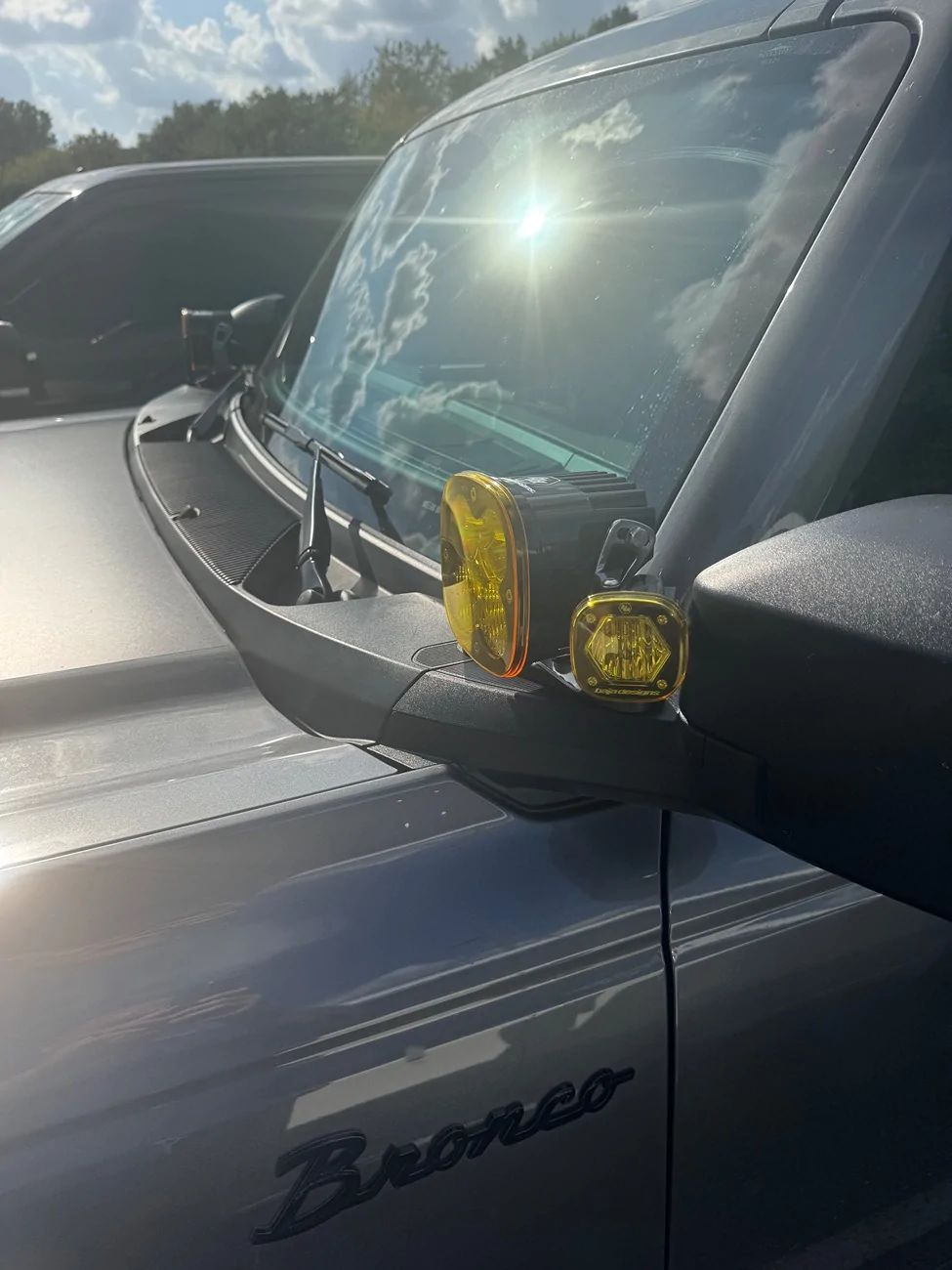

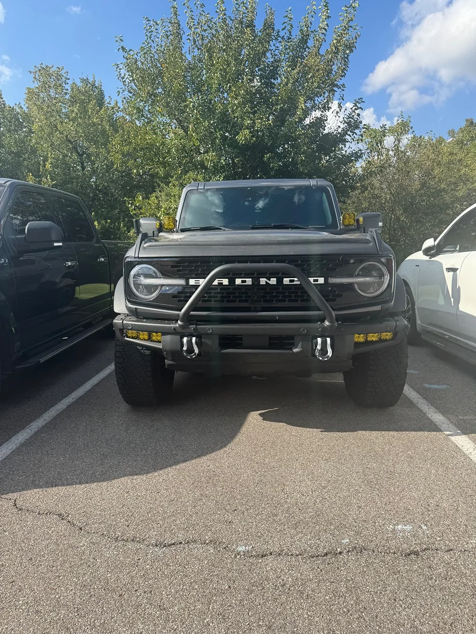

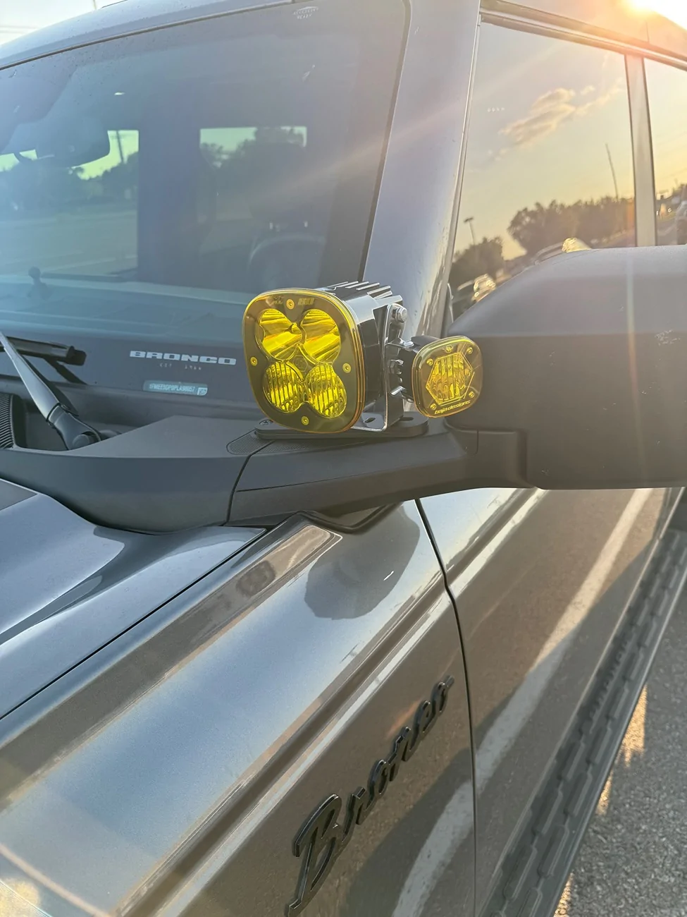

Your question is a good one. And likely will receive a lot of good answers. It really comes down to your specific use case but I will share what I chose.
I think this set up is very functional and versatile for my needs for off-road, hunting, camping and use on dirt roads and in city.
I went with Baja designs, but pick the brand that suits your needs and budget. I went the ā€œbuy once, cry once wayā€ and chose Baja Designs for their warranty which came highly recommended.
My build was all purchased at Specialty Performance Parts @SPVPARTS :
Fog lights: Squadron Pros- 2 pairs of Wide cornering (outside pairs), 1 pair combo (inside pair at the middle of the hood)
A-Pillar: XL80 pro in combo (also purchased spot lenses), with S1 in wide cornering attached to the side of the XL80 for ditches.
I bought all lights in clear, but then added the amber lenses that snap on for protection, and so I can remove them for different use cases and situations.
I should add that the wide cornering fog lights are not technically SAE but I use for them for city driving and I have them angled down slightly below the headlight cutoff and I’ve never been flashed by oncoming drivers.
Hope this helps.

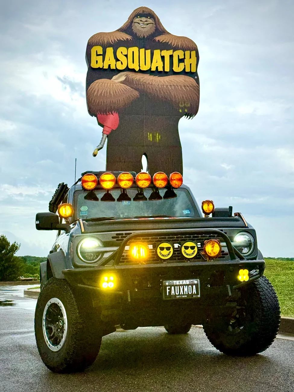

Add all the lights. :)

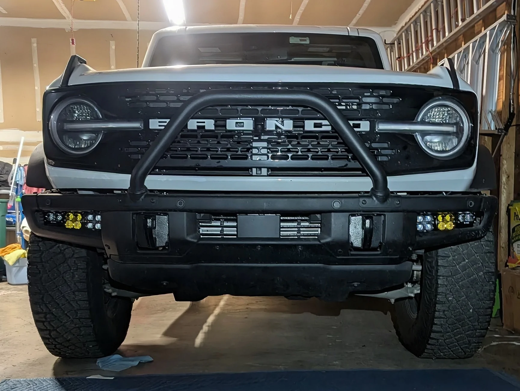

Maybe the only vehicle aspect more personal opinion/biased based than looks and exhaust note is vehicle lighting. :) My 2 cents...​
Correct me if I'm wrong but I think BD vehicles have the standard LED headlights vs the Signature Headlights of higher trims. I'm not sure how those compare in lighting performance, but I see complaints about the Bronco headlights. I find our WTs with Lux package have good headlights. That said, I put the Baja Designs SAE lights in the inner most position of our Modular Bumper slots, and they do an excellent job of supplementing and filling in UNDER the low beams. They also cast decent light to the sides. The upper cutoff for the BD SAE lights is very crisp (clearly defined line w/ little scatter) and with that, we don't get flashed down. We have them on an Aux switch now, so they are on/off with that switch only, but I plan to move them to an added factory fog light switch and allow them to be on with high beams using some FORscan magic (we have the OEM connectors with the Lux package, just no OEM fogs w/ the Mod bumper). A blaster type light run with your head light high beams and "unswitched" to turn off with the low beams will piss many people off, unless you wire in a relay with the high beam switch (Lux has auto high beams). If you like, I can get some comparative pictures for you.​
