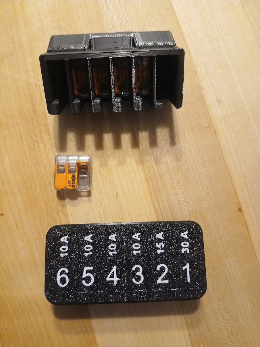

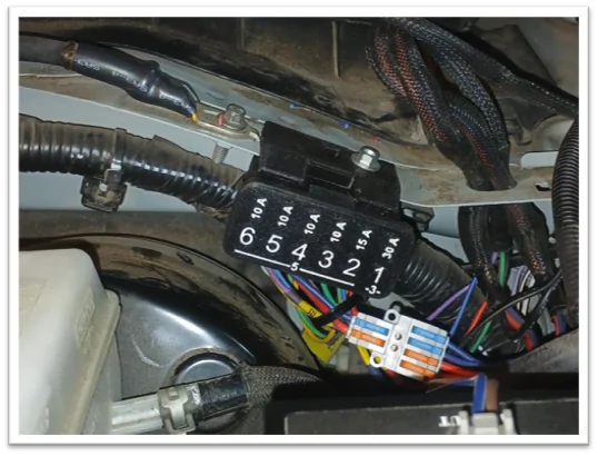

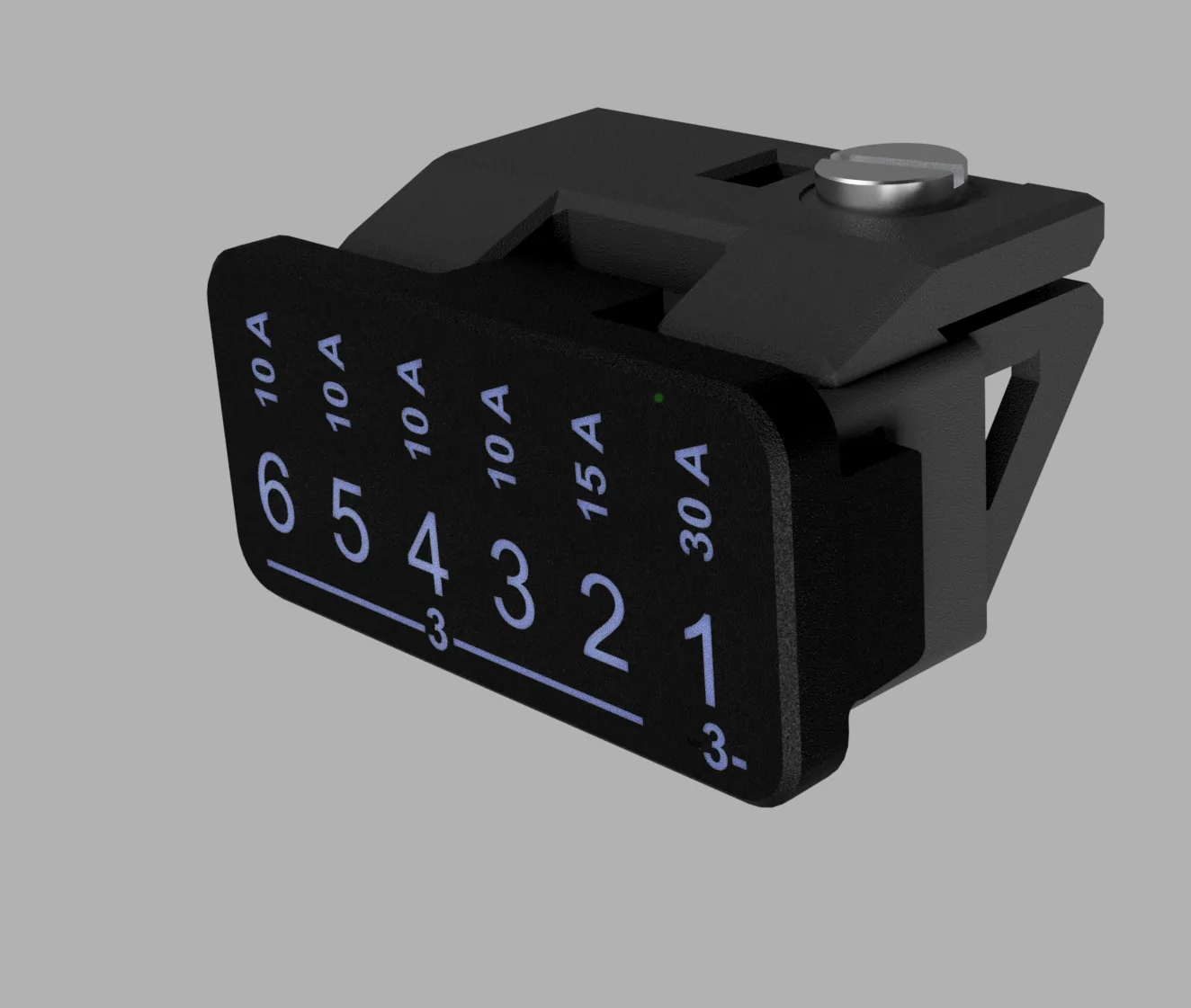

Sport version. I bought the lights through Panda Motorworks. It came with 6 lights (2 3" amber fogs, 2 (2x3"?) driving and 2 (2x3") combination lights) and a wiring harness specifically for the upfitter switches. You can pick whatever lighting combination you want. It fit very well. I ended up making a terminal block (see pictures) for the upfitter wires that uses WAGO lever connectors and mounts to the flange above the master cylinder.

I thought I posted a response but it doesn't seem to show. Anyway, I have 3" amber Fogs, 2x3" Driving, and 2x3" combination all the 'sport' levels with an amber backlight. I also have 3" ditch lights with amber backlight. Mine are all tied into the upfitter switches with a really nice wiring harness that is made by one of the sponsors on this site but I bought from Panda Motorworks. I made a junction box for the 6 upfitter switch wires that uses WAGO lever connectors.

@Dirtrider, did you model and 3D print your block? Any chance you might share the file? I generally use stl files out of SolidWorks, but I think I've used 3mf too. I use the Prusa Slicer.
