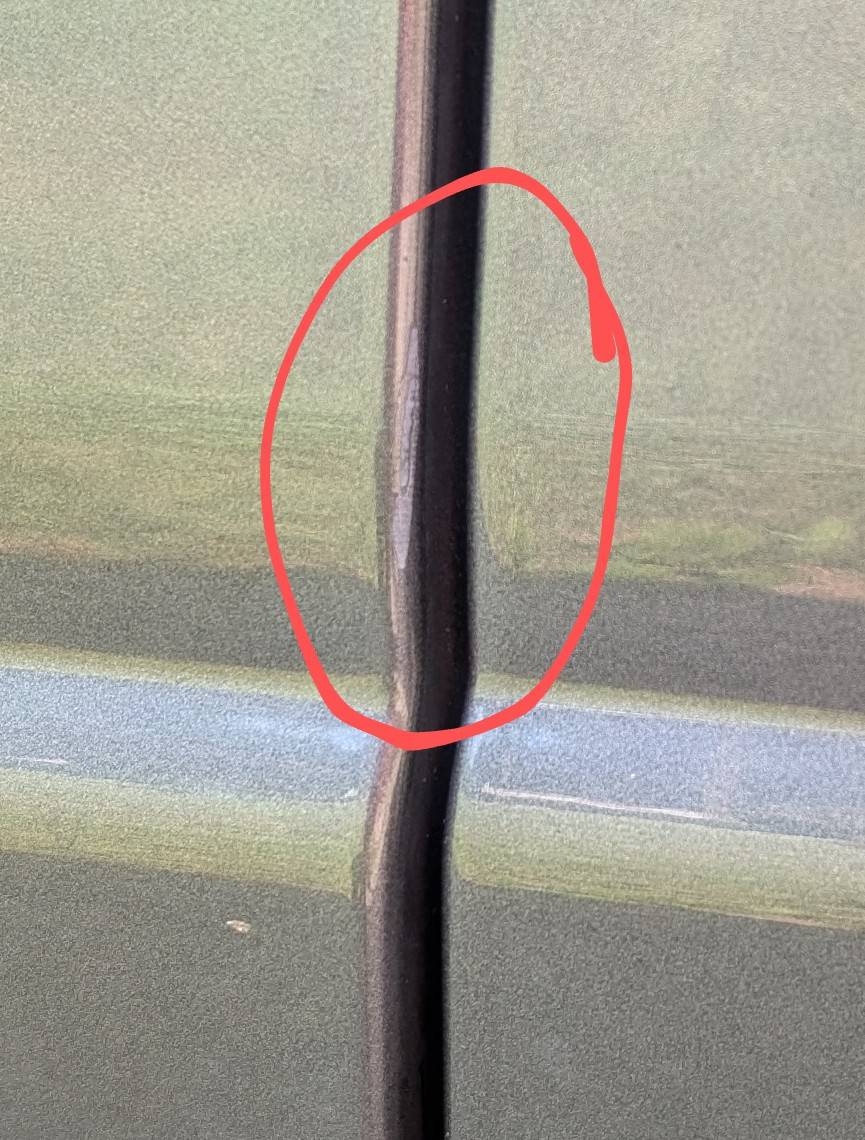

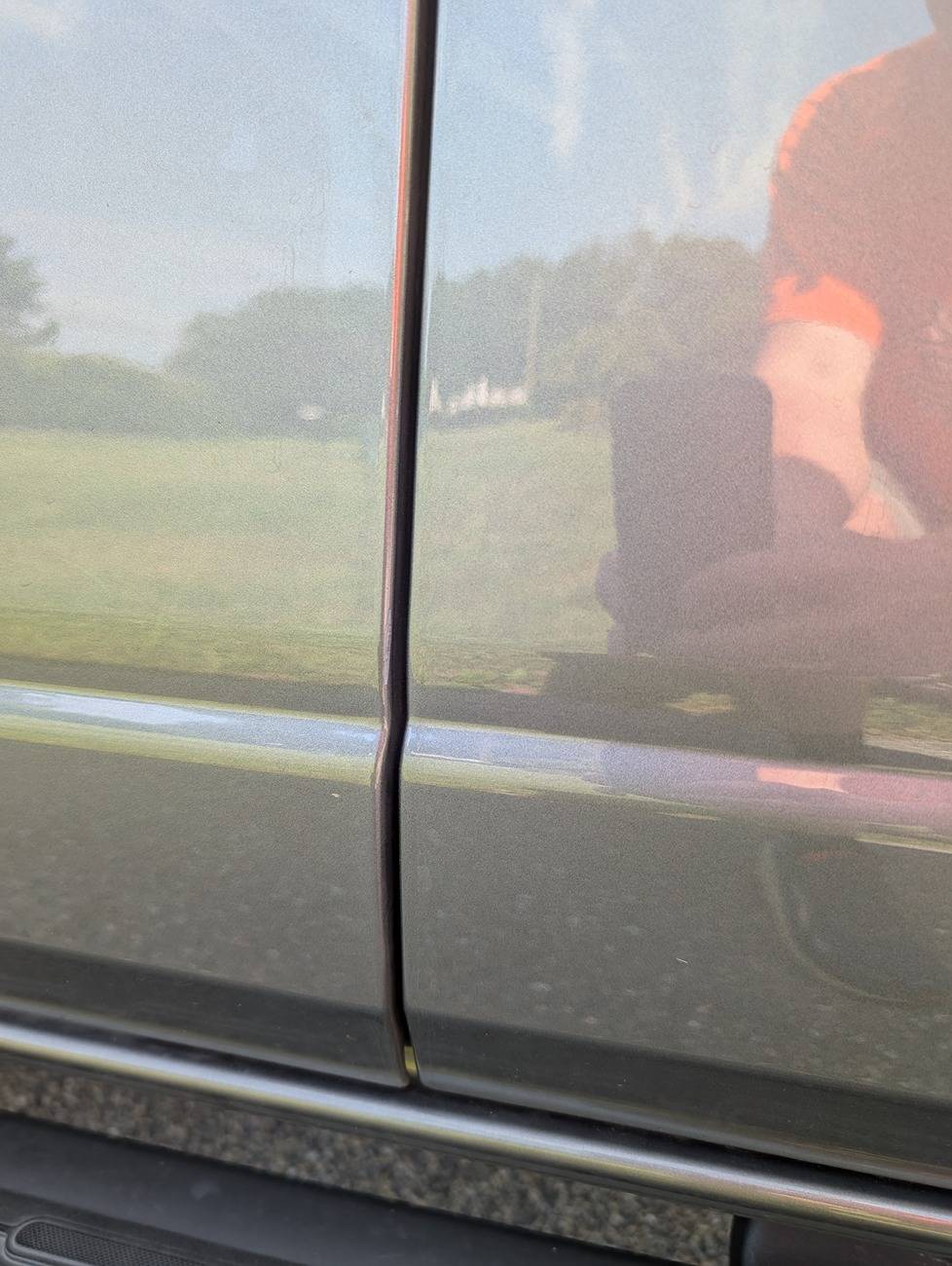

4-door, obviously. Rear door rubs against front door when opened first. It's wearing the paint a little, not all the way to metal yet. Anyone know if it can be adjusted? That door panel seems to sit slightly farther outward.

YEP! Thank you very much! Steps 1-5 got it done. Just had to loosen those 3 bolts and push in gently on the bottom with the door closed. Pro tip (because I'm a pro now!), it looks like they suggest loosening those bolts 2 full turns... that's way too loose, because once you get the door where you want it, it moves when you try to open it to tighten everything back up. So, only loosen them enough to allow the door to move with just a moderate about of pressure. When you're comfortable that it hasn't shifted upon reopening, then torque the bolts to spec. All-in-all, an easy task (as expected) that saved me a lot of aggravation. Door operates fine now.
