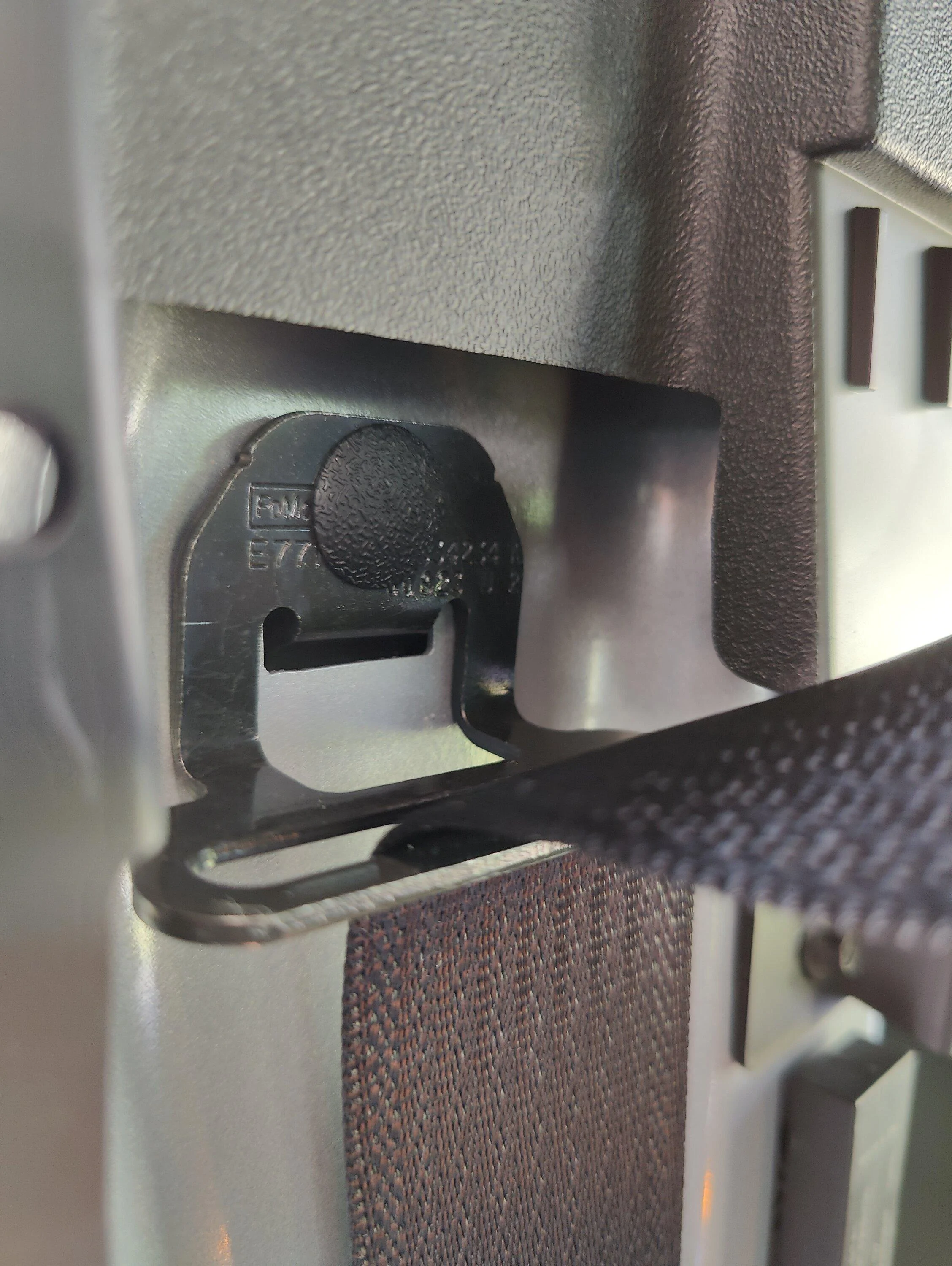

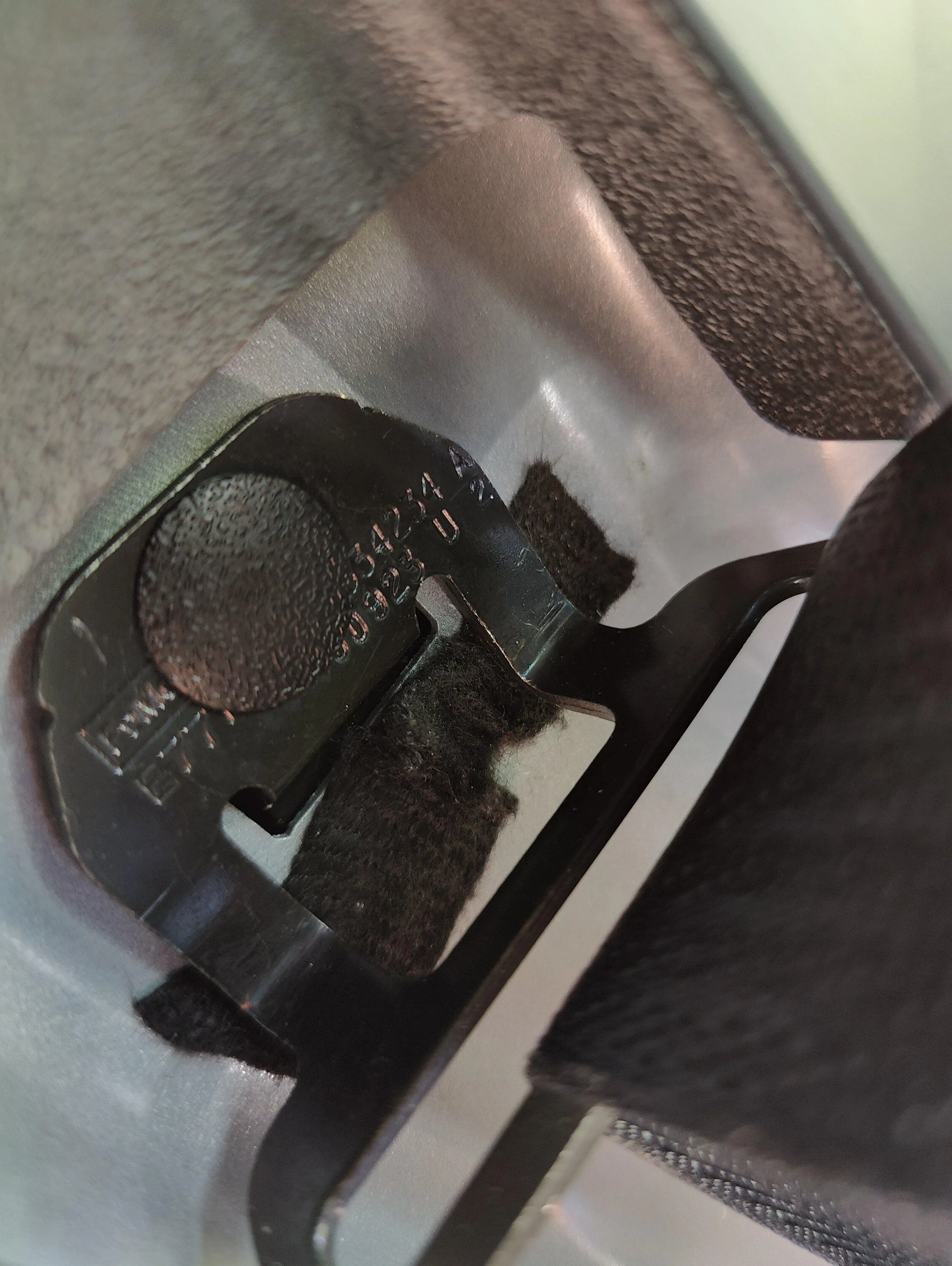

Hey man, I did my factory sub install and I found my rattle! Maybe this is the same source as yours. Mine sounded kind of like a jingle bell, and the sound travelled a bit, and sounded almost like the rear back passenger seat (2 door). I sourced it to the hidden seat belt guide being floppy and tapping the metal. It was a little challenging, but I slipped some felt tape under the guide and there's no more jingling. I hope this helps you!
