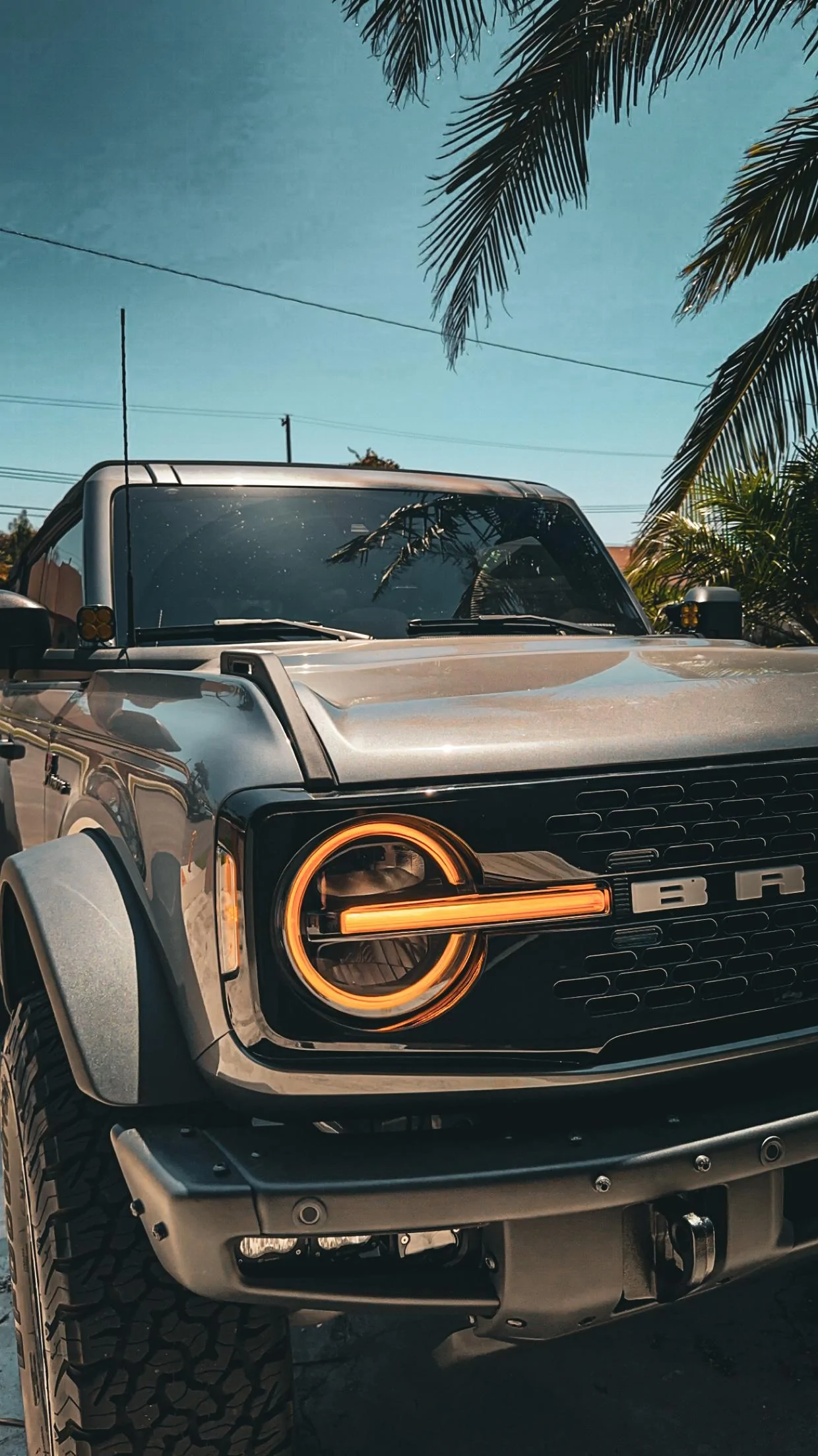

I was interested in swapping my signature LED headlights to the Raptor amber lights. Spent some time searching this before and found conflicting information if they would work or not.
Found a set for a great deal this weekend and went for it. After an easy disassembly of the grill, the lights bolted in without any issues. Everything works great and there are no issues so far.
Loved the added light output from the AlphaRex and Morimoto but couldn’t pass up this set for a fraction of the price.

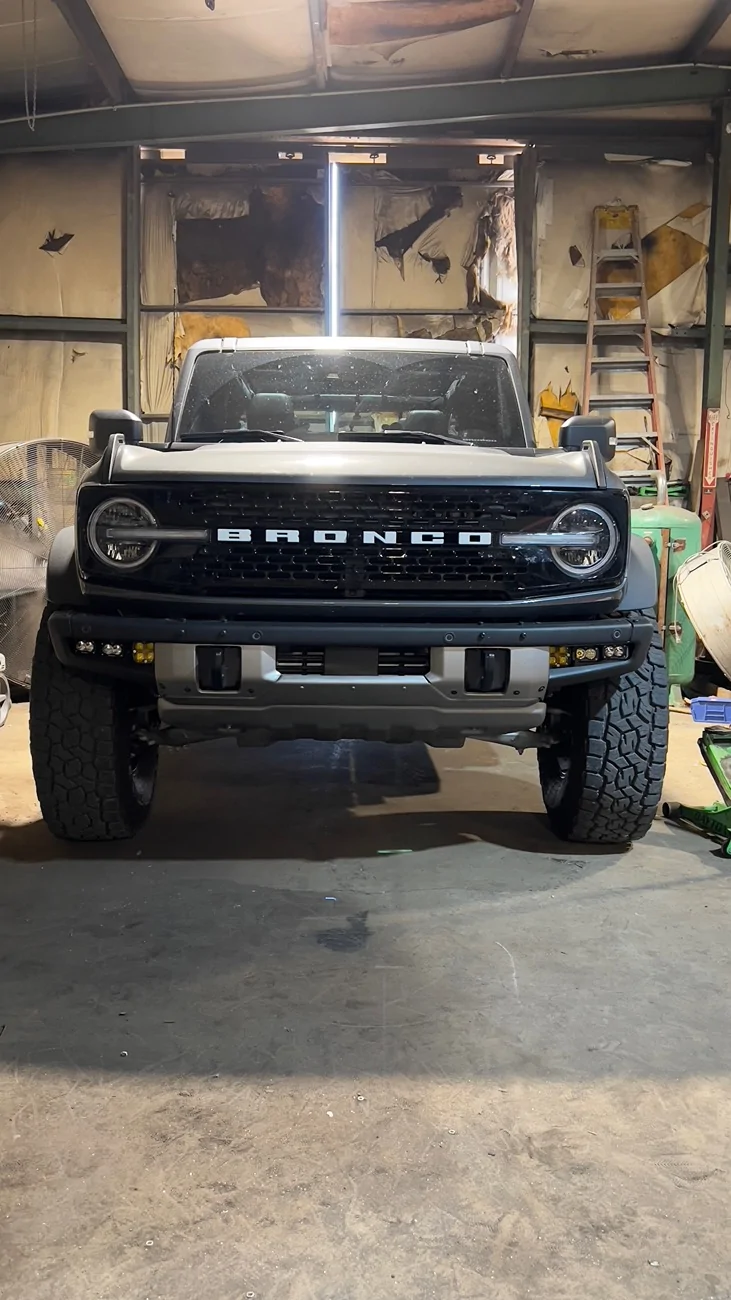

Nice! I wish I had done this before installing my front bumper. I can no longer remove my grille without removing the front bumper first.

Removing the bumper is no easy task.. what bumper did you go with?
I'm looking to do the same with my 2021 OBX. What year is your Badlands? Was it a straight swap plug and play? Nothing needed to reset anything, like needing Forescan?

Mine is also a 21. Straight swap! No reset, forscan, etc..!
