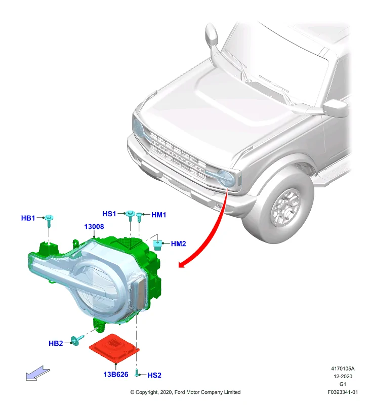

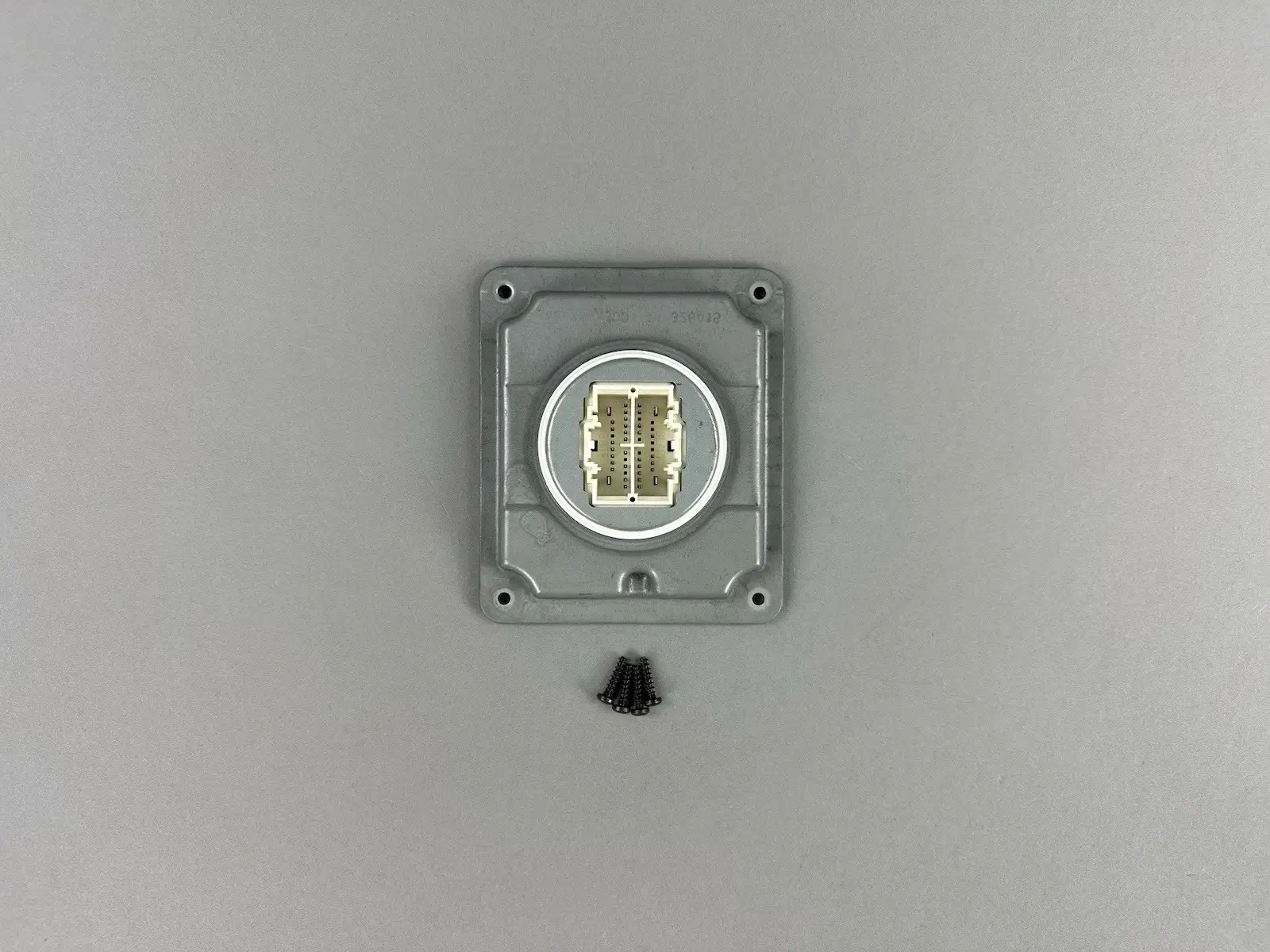

I was hoping that you would be able to provide some guidance with this. I received the Bronco Raptor headlight kit today and it came with screws taped to the ballast modules. These screws are way too large in diameter and too long for 2 of the 4 locations. The part number for the supplied screw is W506966-S437. Would you be able to confirm that the part number for the HS-2 screws in the photo below the same part number?

I pulled this photo from an eBay listing and the screws in the picture look smaller. Thank you in advance for your assistance
W506945-S437 should be the correct part number.
Not sure what happened there, but the ones they gave you are definitely wrong. W506966-S437 doesn’t even come up in the catalog anywhere for a Bronco.
