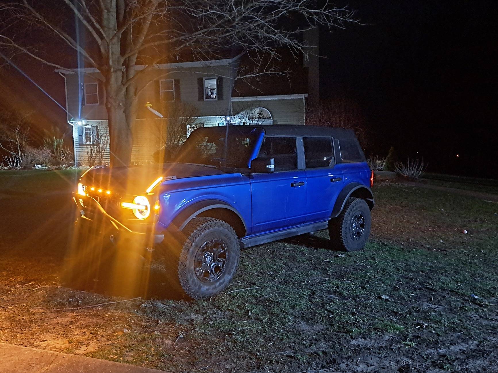

Im going to have to give up for now. I attempted to load a raptor vin in the BCM and rerun the exterior lighting procedure in FDRS without any luck.
Whats really annoying is after running the LIN BCM procedure my known good headlight stopped working.
it seems clear the headlight module is not programmed correctly. If i flash my high beams the orange DRLs illuminate. Low beams work fine. No working blink function.
i currently have a set of base headlights installed that are working fine.

I am experiencing the same exact problems with my raptor headlights in my wild trak. Did you find a solution to the problem?
I did fix mine but it required put them into a Raptor and running an FDRS procedure.

What did you use to do the first. Procedure? I will have to find someone local willing to help me out. Thanks for answering me so quickly.

You need to find a Raptor to install the lights into, then run the Enhanced Exterior Lighting procedure for the BCM in FDRS.
