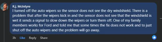

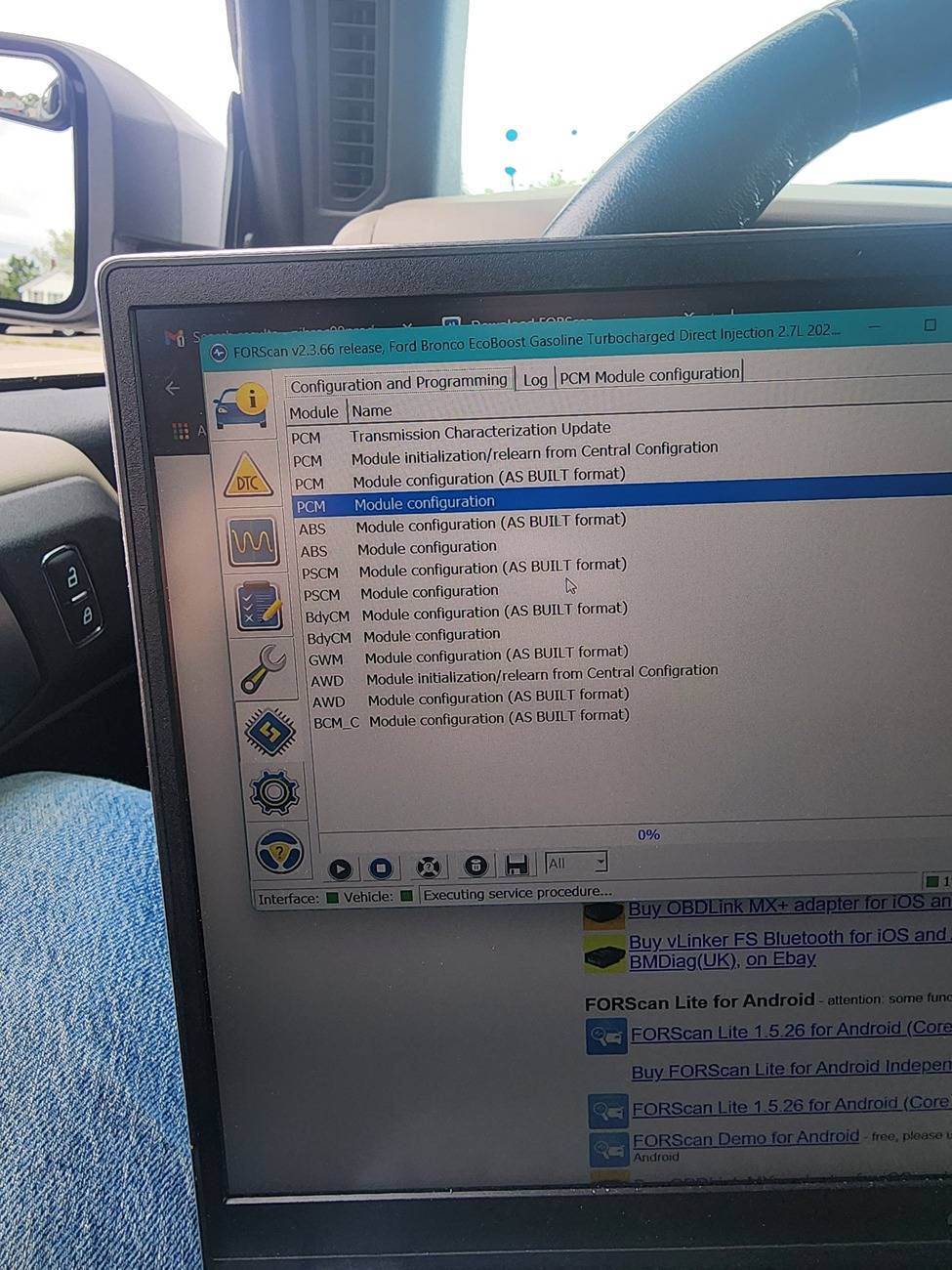

I'm trying to find the SCCM module in Forscan on my 22 wildtrak with Lux and I don't see it - any idea as to why that is? I'm thinking maybe it's because I'm using a Bluetooth adapter - though this adapter is an expensive one that worked fine with my 2013 explorer. I have a USB OBDII adapter that I'll try when I get home today too though but figured I'd ask.
I'm actually trying to disable the rain sense feature as when the blades slow down n the return stroke, they chatter and skip like crazy. I've made multiple posts in multiple forums and so far the only thing I haven't tried yet has been disabling the auto wipe feature. It doesn't show up in my vehicle wipoer settings page either.
Broncos don’t have a rain sensing feature from the factory.
But yes I would agree that your adapter is likely the reason all the modules aren’t showing up.

It has the friction-sensing motor that "prevents damage to the motor in dry conditions" as Ford puts it. So it slows down the motor but isn't an "auto-rain-sensing" auto wipers feature. I'm trying to get it to stop slowing the blades down on the return stroke basically. The TSB regarding this has already been performed on my vehicle as well (23B35).
But cool, kinda glad it's likely just the adapter I'm using lol. Will have to try again when I get home with my USB one. Thanks!!

Gotcha... Someone said this in a facebook group, maybe they were talking out their ass then LOL. I certainly trust you more than anyone on facebook, as based on other comments I've seen from you, you very clearly know what you're talking about lol!
