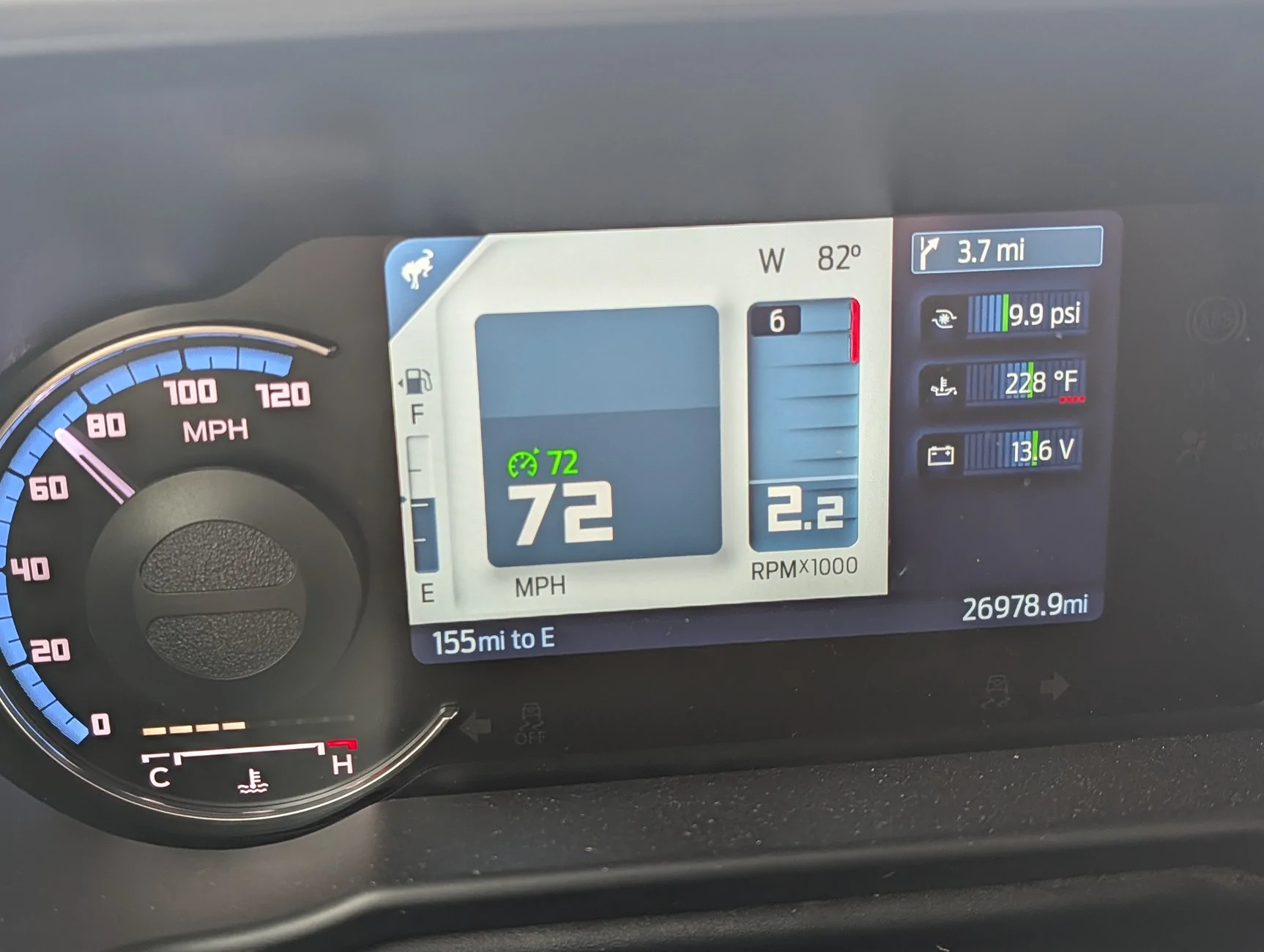

On the flats we were running 210 to 215, but on longer climbs we crossed 230 several times and got the "reduced power" message on the dash once. This was on Northeast TN, afternoon temps were in the mid-80's.
Manual transmission, and I always to keep the tach at 2k or above on hills, so usually 5th gear uphill on the highway, 6th gear on flats runs.
I think it's possible that you're lugging it a little. Too much boost for too long? Sweet spot is more like 3K in my experience with the same engine and trans, and towing with it. Or you may need a washout. Just my thoughts.

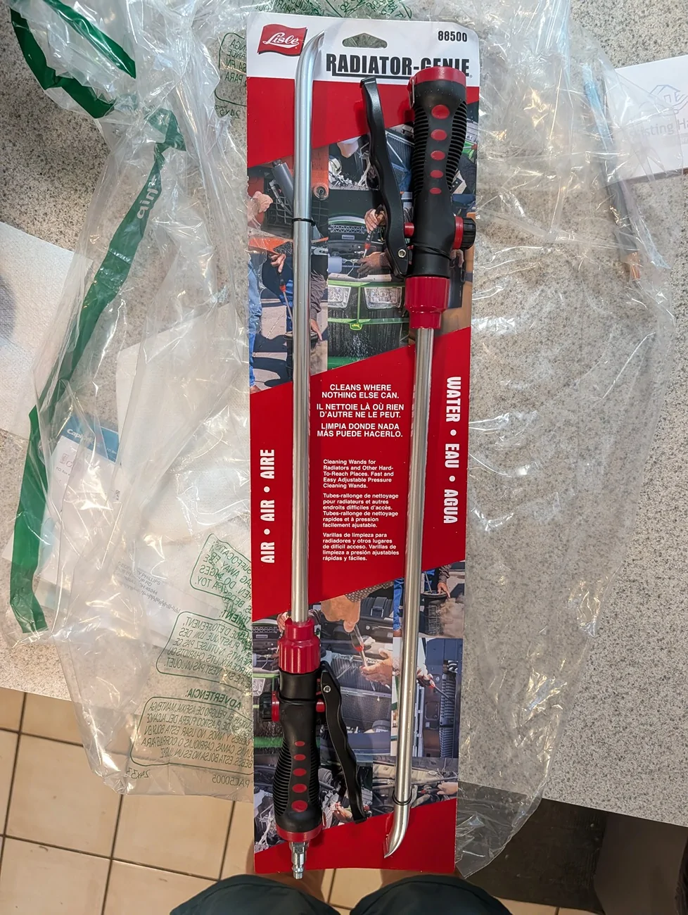

I was able to I use the radiator Genie wands this morning, air and then water. Seems like a good combo, getting decent amount of dust out before using the water. I can see how it would help more to have the other kind of very thin wand to get between the condenser and radiator. But I had good success getting the wand in between the fan blades spraying water forward. I could see between the condenser and radiator with a light and see the rinse water go from brown to clear. Although it's hard to rinse the parts just in front of the fan motors.
Got on the highway for a road trip this afternoon and seems better! Now that I'm watching both gauges, it's clear the oil temp fluctuates a lot more than the coolant bar graph. Today on some small hills I noticed the oil gauge fluctuating 15 to 20° with no movement in the bar graph. Seems odd.
I also see how higher RPM helps keep the oil temps down a little on hills. My not-so-scientific test was to set the cruise control at 72 and 5th and 6th gear. Mild hills on the highway, oil temp got up to 228 max in 6th gear and 222 or less at the same speed in 5th gear. Didn't get a pic in 5th gear.
I'll experiment little more, but think I'm out of the danger zone for now.
