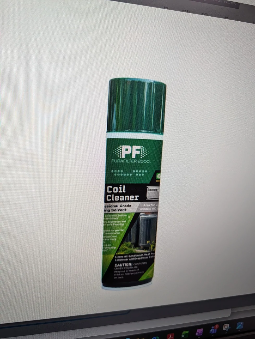

My 2022 2.3L was running too warm on a recent road trip, especially on the uphill climbs. Most of my daily driving is local, 40 mph stuff, and it seems fine at those speeds, short drives.
We did some muddy trails this Spring, and I rinsed it well, but probably not well enough. Wondering if anyone has had success with the Radiator Genie wands? And should I be pre-treating with a cleaner like for AC condenser coils? The attached pic is something available at Lowe's.
Thx!
Thx!
To me it looks like a solution in search of a problem. I've never needed such a product on any car I've owned. All were Arizona cars.
But he has a problem. Overheating possibly due to mud in the radiator fins.

Here in Southern OH and central KY, mud and deep-ish water is unavailable on our trails. This type of mud is probably not ab AZ issue.
I've never lost an alternator like many with 2.7's have on the same rides, but it's fairly deep. And the fans run and slings it up even higher unfortunately. So I know I need a more thorough cleaning.

I've just used a garden hose with a spray nozzle with nylon brush to clean a radiator or condenser. Maybe with an attachment that lets you apply Simple Green or something similar.
I don't think an aerosol can will work on mud build up. Those products are intended for an A/C tech to carry in his tool kit when working on a building's A/C.

Coil cleaner is really aimed at organic debris/dirt. Hair, grease, pollen, household dust. Get the mud out first and then maybe.
Most are acid base but evidently not PF.
