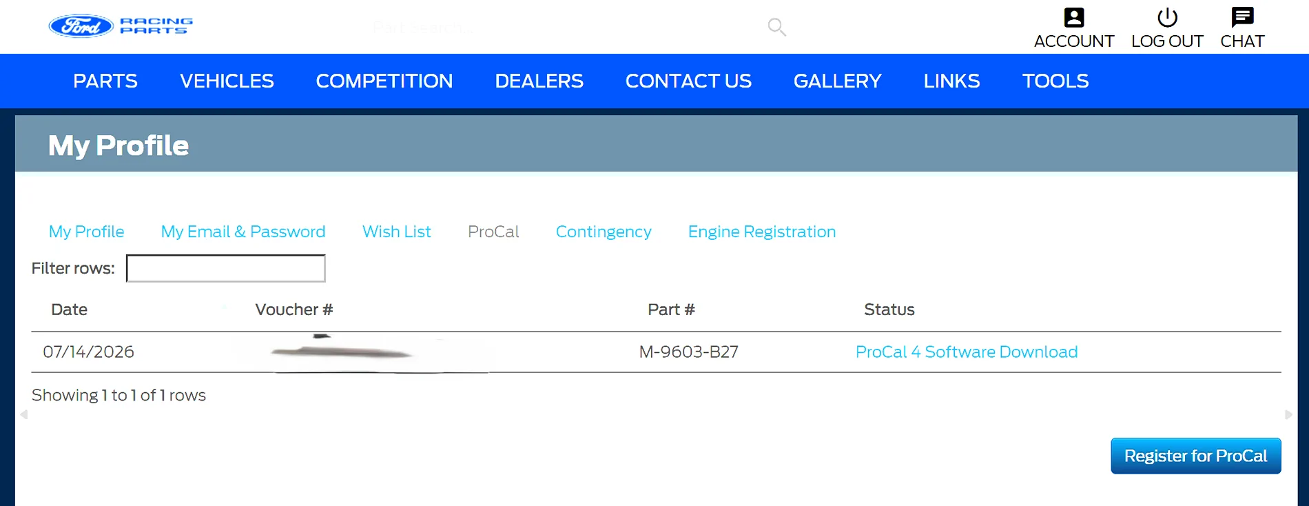

If you want control of your tune, you want the ProCal unit tied to your account, not a dealer account.
Register an account here: https://performanceparts.ford.com/register/ It's different from your regular Ford account.
In your profile, there will be a section to download the ProCal software and register your ProCal unit.
Ford Bronco PSA: Ford Performance ProCal -- 25% Off via Ford (Code: POWER25) Screenshot 2026-07-21 113312
If the dealer does this with their Ford Racing account, you can't download the software, perform updates, etc., and you have to go back to the dealer for any changes
Make sure to confirm with the dealer that they are using your Ford Racing account, not theirs, and provide your login and password to them. The dealer will do the download and registration.
Once you get it back from the dealer, you can download the ProCal software yourself, you won't need the dealer for any changes.
If you are doing it yourself, you download the ProCal software, and plug the ProCal unit into your PC. It will look for ProCal software, and you can download the tune to the ProCal device. It will prompt you for your voucher number at some point. The voucher is printed on a paper that comes with the ProCal.
Once the tune is downloaded into the ProCal, you disconnect the PC, and connect the ProCal to the ODB2 port. Then, you can upload the tune from the ProCal to the vehicle.
So I tried to set up an account, but it requires the voucher, which I do not have as it is being sent to dealer for install. So suck fest, I have to pick it up, get voucher and go back for install. Does the voucher come with the package or is that another hoop I have to jump through?
