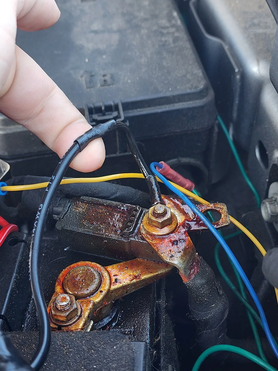

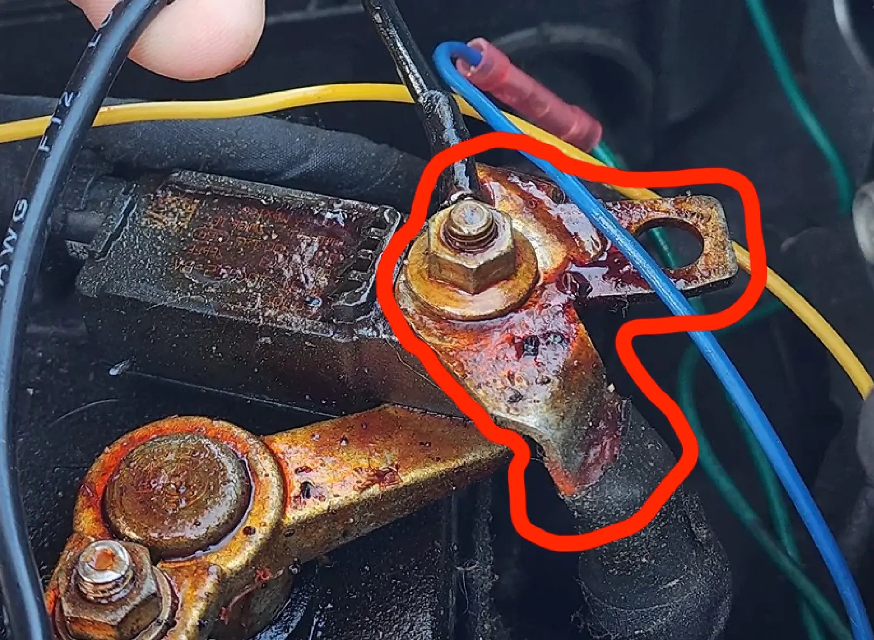

You can clearly see in my picture that it's not an extension of the battery post. I've posted this pic a few times now in this thread. Thought that was settling the debate lol. The BMS is clearly in between the battery terminal and the negative connection to the vehicle.

I didn’t say that….BMS tab is on battery post side then to the sensor then outgoing wires. If tab was on wire side coming out of BMS then yes it would make sense. I’m not trying to argue with anybody on here I’m just not seeing BMS between tab and battery post. Post and tab are both on same side of BMS
Just want to circle back to this - you were agreeing that the tab is on the terminal side of the BMS, which is why I'm confused about what you're saying now. The photo I posted shows that the tab and negative lead are clearly on top of the BMS, meaning all electricity has to pass through the BMS sensor in order to make it through to the negative battery post. So I'm not sure why everyone's talking about magnetic fields now... We were clarifying here that indeed all of the electrical current going to the negative post of the battery has to pass through the BMS sensor, and as such, the negative lead of the Bronco is on top of the BMS and the battery post is on the bottom of the BMS.
