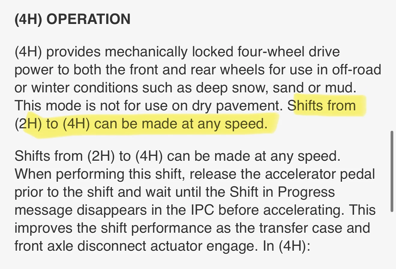

To get back on the original track,
I believe the concern is at what max speed can the Bronco 4H be engaged from 2H, and back again, without leaving some pieces behind on the road.
Ducati1098
10,013
23,293
Midwest
There is no limit. Shifts can be made at any speed.

Part time:
Ford Bronco Practical switching between 2H and 4H? IMG_9444

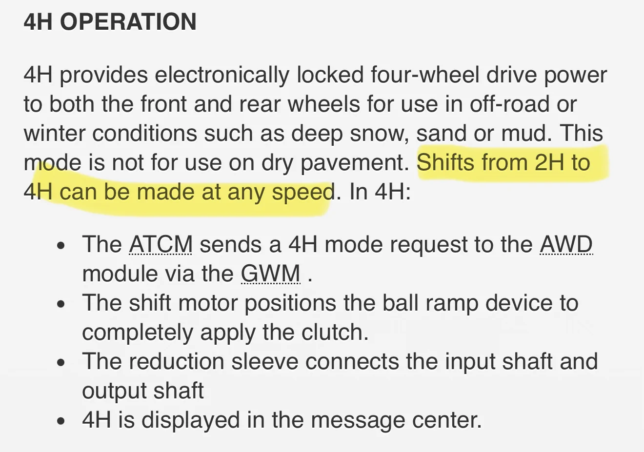

4A:
Ford Bronco Practical switching between 2H and 4H? IMG_9445
I looked in the manual and couldn't find any reference to a maximum speed for engaging/disengaging 4H. I did find references to the maximum speed to engage the locking differential (20mph) and the speed it unlocks (25mph) and re-engages (20mph). Based on that, it seems there is no practical limit for engaging 4H.
