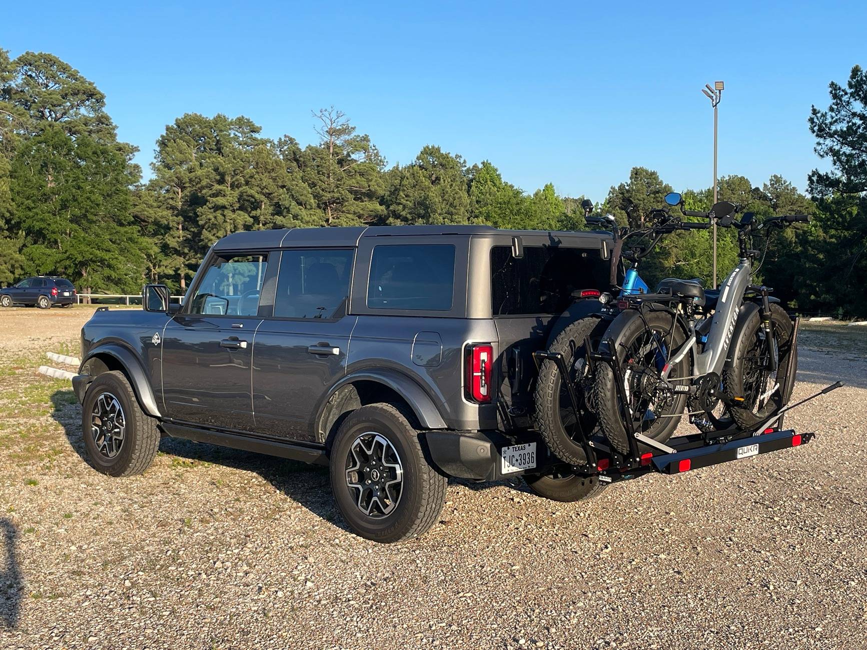

I have a 2023 4-dr Outer Banks, 2.7L with a Curt 13493 class III hitch installed. The hitch has a tongue weight capacity of 350 lbs. I have a 7 inch extension on it to clear the spare which I have read reduces the tongue weight by 25%. I have read longer extenders reduce it by 50%. So, 350 lbs. reduced by 25% gives me about a 262 lbs. max tongue weight. I haul two e-bikes on a bike rack. The rack weighs 65 lbs., and the two bikes together weight 214 lbs. This puts me at 279 lbs. which is 17 lbs. over my tongue weight. My question is will 17 lbs. over matter much? If so, any suggestions on how to increase my tongue weight capacity?

I would think 17#, while over the limit, is within the safety margin but I’m not an engineer. On my F350 paranoia drove me to buy the 3” hitch instead of using a reducer sleeve.

You probably won’t break anything with bicycles at 17 lbs over. But that’s a medium-sized “probably”. It’s not like your 269 lbs is entirely at the outer radius of your hitch extension, so good odds are are actually within spec, but… there’s calculus involved and I’m not that smart.
The easiest solution would be to throw the spare in the back, or up on a rack, or leave it at home, and use a bike rack that pulls in closer to the body of the Bronco. (You may have already done this, hard to tell based on your photo)
Or take front tire or something off the bikes to reduce their weight.
Past that you are looking at probably welding something to your frame - not easy

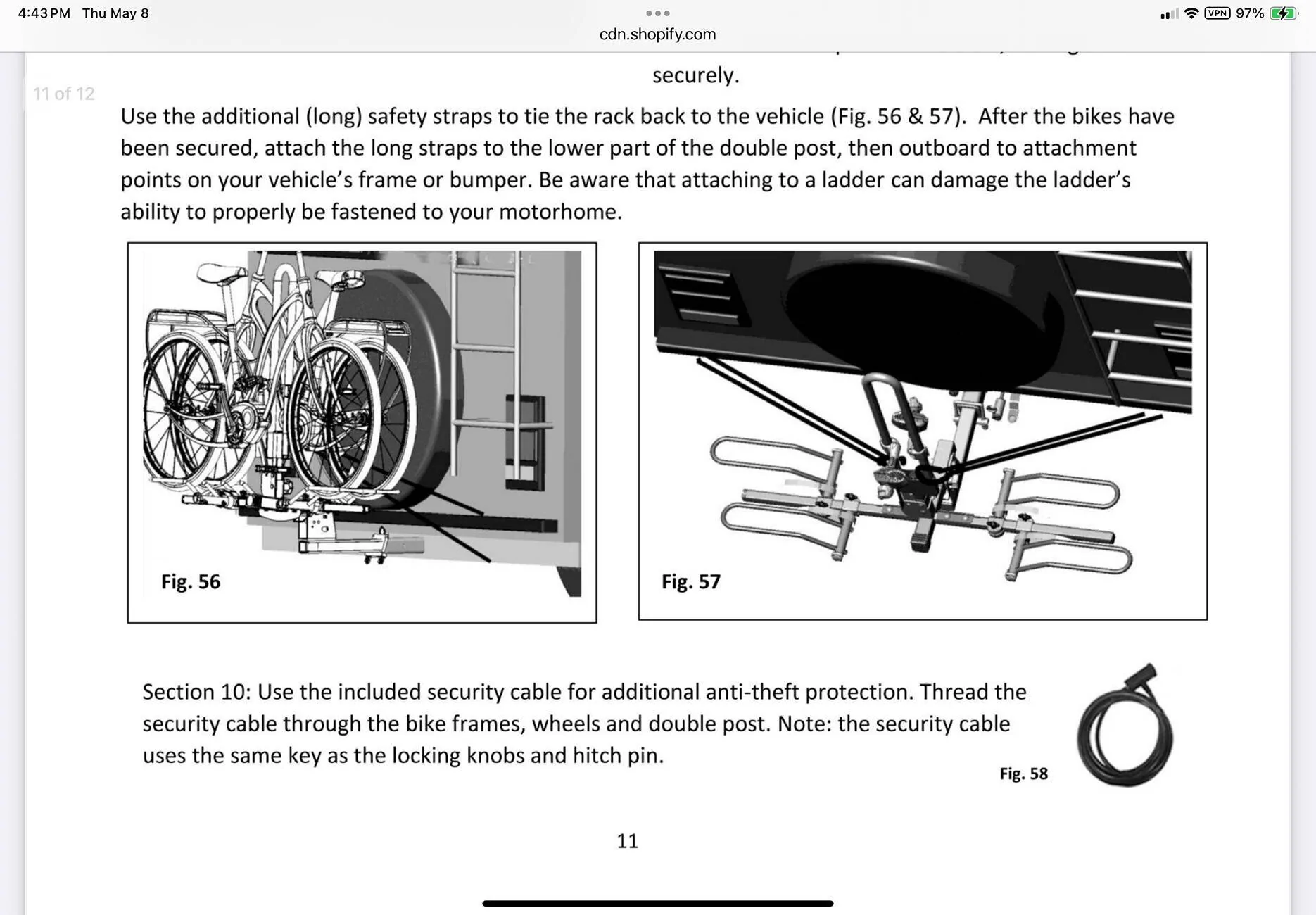

Get and install the Bronco Raptor hitch supports. There was a thread on here a while back about you might be able to fInd. I’ll look for it and if I find it will add to this thread.
Edit: I’d also get some nylon webbing cinch straps and secure the bike rack to the Bronco’s recovery points under each side of the bumper. That’ll keep side to side movement of the rack to a minimum. See pic on the right for an example.

My spare is still attached. I may have to leave the spare at home like you said.

Good idea on the straps to minimize side to side movement.

No.... Extending the hitch WILL NOT reduce the tongue weight. It is the exact same weight.
But it WILL create additional leverage which is BAD for the weak hitch design. Essentially it will become a longer lever to try and twist the crossmember mount.
Just remove the spare tire and ditch the extensions. Carry a tire plug kit and air compressor. Much less weight and you'll be able to repair most issues. Plus your swing gate will thank you.
