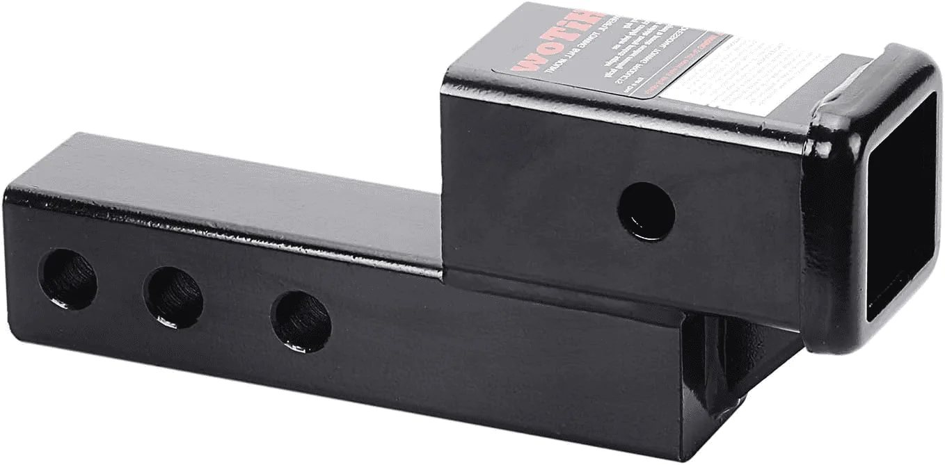

I am using this for a shorter drop hitch for my bike rack, but it could also help with trailer as you can get a lower drop.
Ford Bronco Bronco extended trailer tongue extension question 1712071570292-qc
