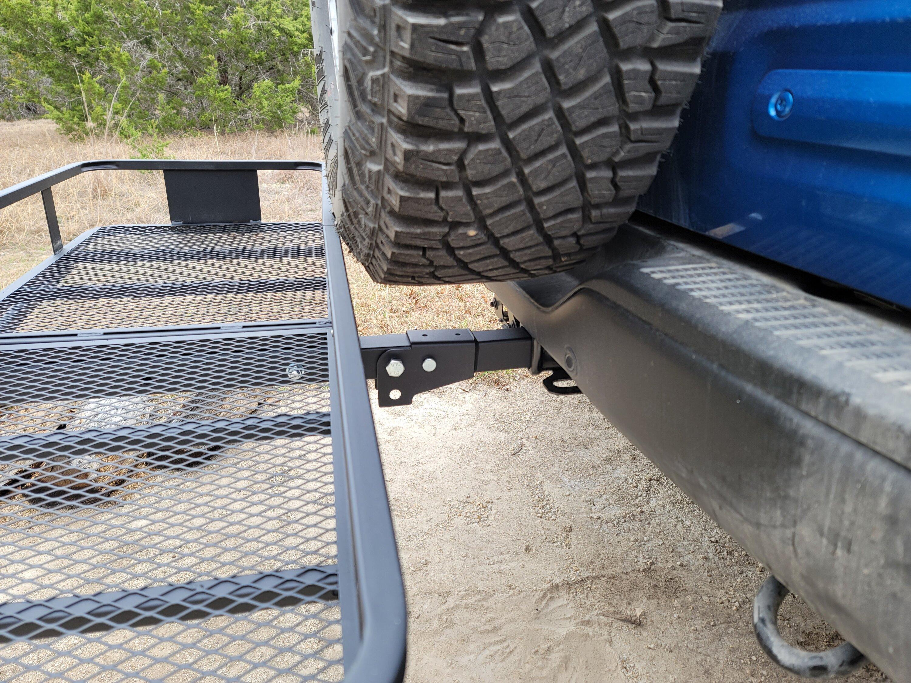

I recently bought this hitch basket to store some extra gear on while camping. It's the same one on the Ford accessory site but I saved like $200 by going through Amazon with the manufacturer part number.
CURT 18151 60 x 20-Inch Basket... https://www.amazon.com/dp/B00JF5HR7K?ref=ppx_pop_mob_ap_share
My issue with it is that the Sasquatch tire is too large to allow opening the swing gate without taking off the basket.
Ford Bronco Question regarding tongue weight 20230120_145822
I need to drop it by maybe an inch or two.
My questions are
1) Any recommendations on an affordable hitch drop?
2) Would dropping it effect tongue weight at all?
I know that the max tongue weight of the Bronco is 350lbs. The basket supports 500lbs and weighs ~60lbs so I'd never plan on exceeding 200-250lbs of gear just to be safe, but was wondering if somebody here knows if a hitch drop to allow the swing gate to open would further impact the max tongue weight.
Thanks in advance to anybody willing to dish out some education.

I dont see how it would. An extension drops the tongue weight. There is some calculation for that.

You'd be changing the geometry a bit by doing so and it might affect the torque applied from the weight of the basket/stuff, but dropping it by an inch or two shouldn't make enough of a difference to really be a risk. Just keep a small cushion between loaded weight and tongue weight limit (which you were already doing) and you'll be fine.
Thank you, ultimately I had an idea this would be the answer just wasn't sure.

How much weight do you plan on placing in the basket?
An ice chest, some recovery gear, and maybe some wood for a campfire. I don't think I'd even exceed 200lbs if I'm being honest.
