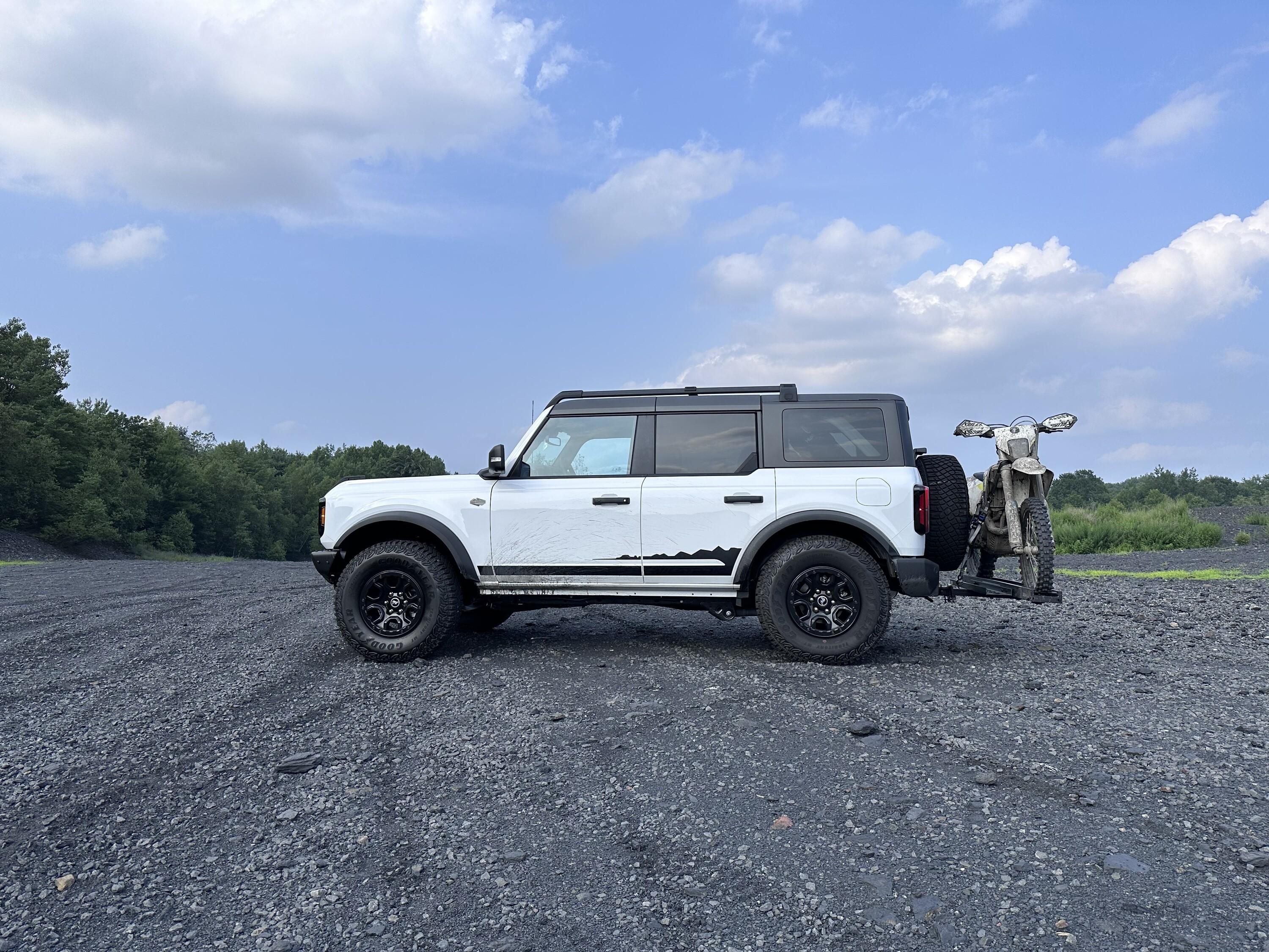

ETrailer.com sells a Draw-tite hitch for Broncos with max TW of 675 lbs. I got one to replace the stock hitch that is limited to 350 lbs. Works great. https://www.etrailer.com/Trailer-Hitch/Ford/Bronco/2022/DT37GR.html?VehicleID=20226004594
I'm running this because I did not want to run an extension and need additional stabilizers.
Ford Bronco Increase max tongue weight for ebike rack 53059383265_b75688e999_4k
Untitled by Michael Halat, on Flickr
Everyone yammers on about exceeding the 350 lb tongue rating and gets all herky jerky over it but says nothing when people slam on 2k lbs of overland accessories on the back of the truck.

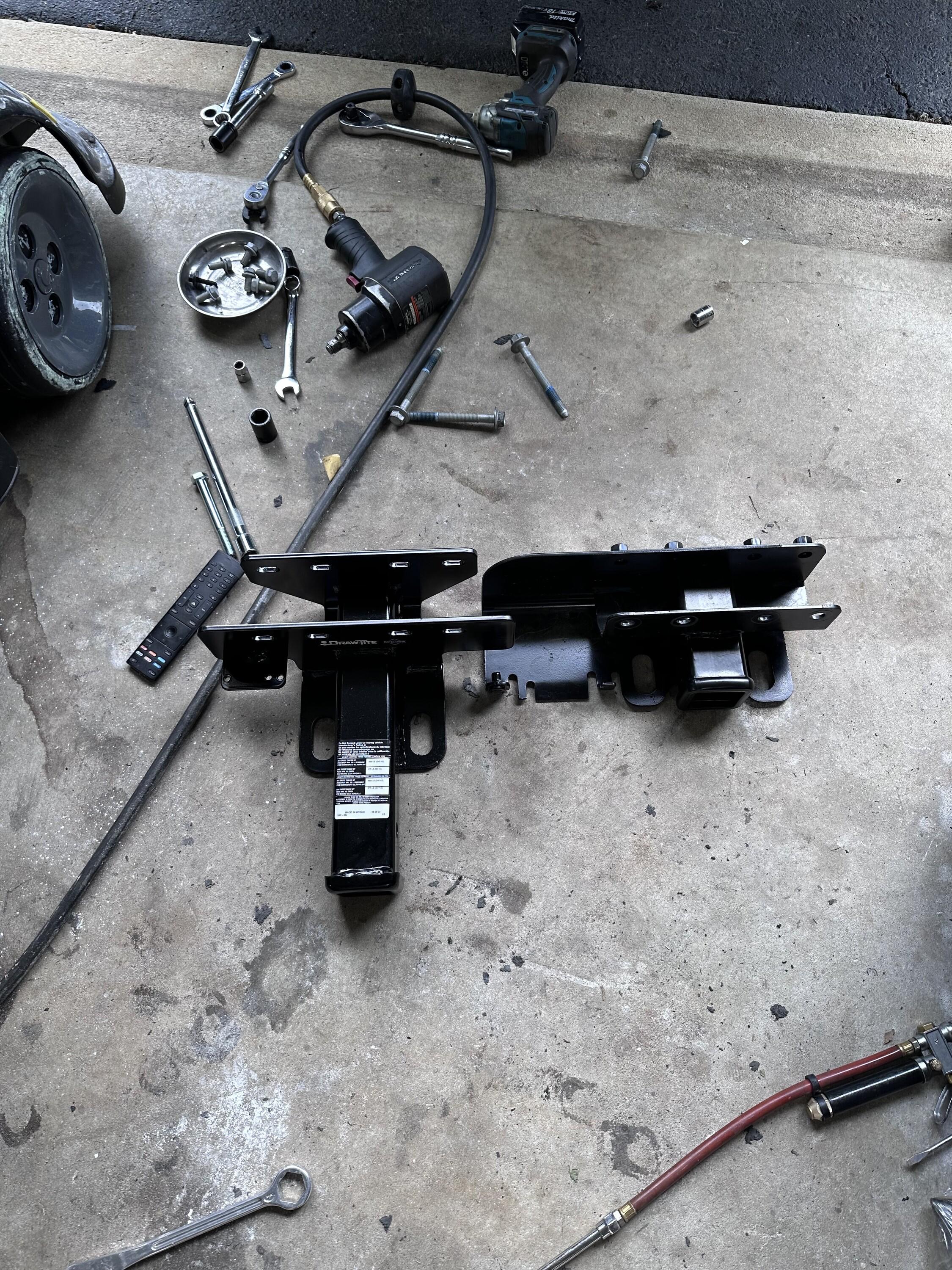

Yes but tow capacity is calculated not only by crossmember strength, but braking ability, suspension components, etc. And if your tongue weight is also being calculated by those factors, then every other piece of weight added to the vehicle is negatively affecting it's towing capacity as well. There are far more factors at work, but everyone seems to think if you push the rated tongue capacity you are immediately going to die in a fiery accident but says nothing about severely overloaded overland rigs with everything under the sun slammed on it.
IMO people need to use common sense in what the rigs can handle and there is no "this is the only way to safely do it" mentality because people pick and choose what their opinion of "safe" is.
For my personal situation the max frame is rated at 675 lbs and is significantly thicker than the ford OEM mount. So as the max frame pushes the fulcrum point further out on the vehicle it is also a significantly stronger receiver.
Here is a comparison of the two:
Ford Bronco Increase max tongue weight for ebike rack 53059206579_22a585df20_4k
Now would I ever offroad with this setup? Absolutely not. But for what the OP is trying to accomplish it's not bad, but admittedly it's no raptor setup either. I would love additional bracing on the rear crossmember for piece of mind but I am not ready to hack the exhaust on a truck with 400 miles on it. Oh and my total weight with the above setup is 300ish lbs, but I run into the OP's issue with the fact that it is an extended hitch and supposedly cutting my carrying capacity to only 175 lbs.
