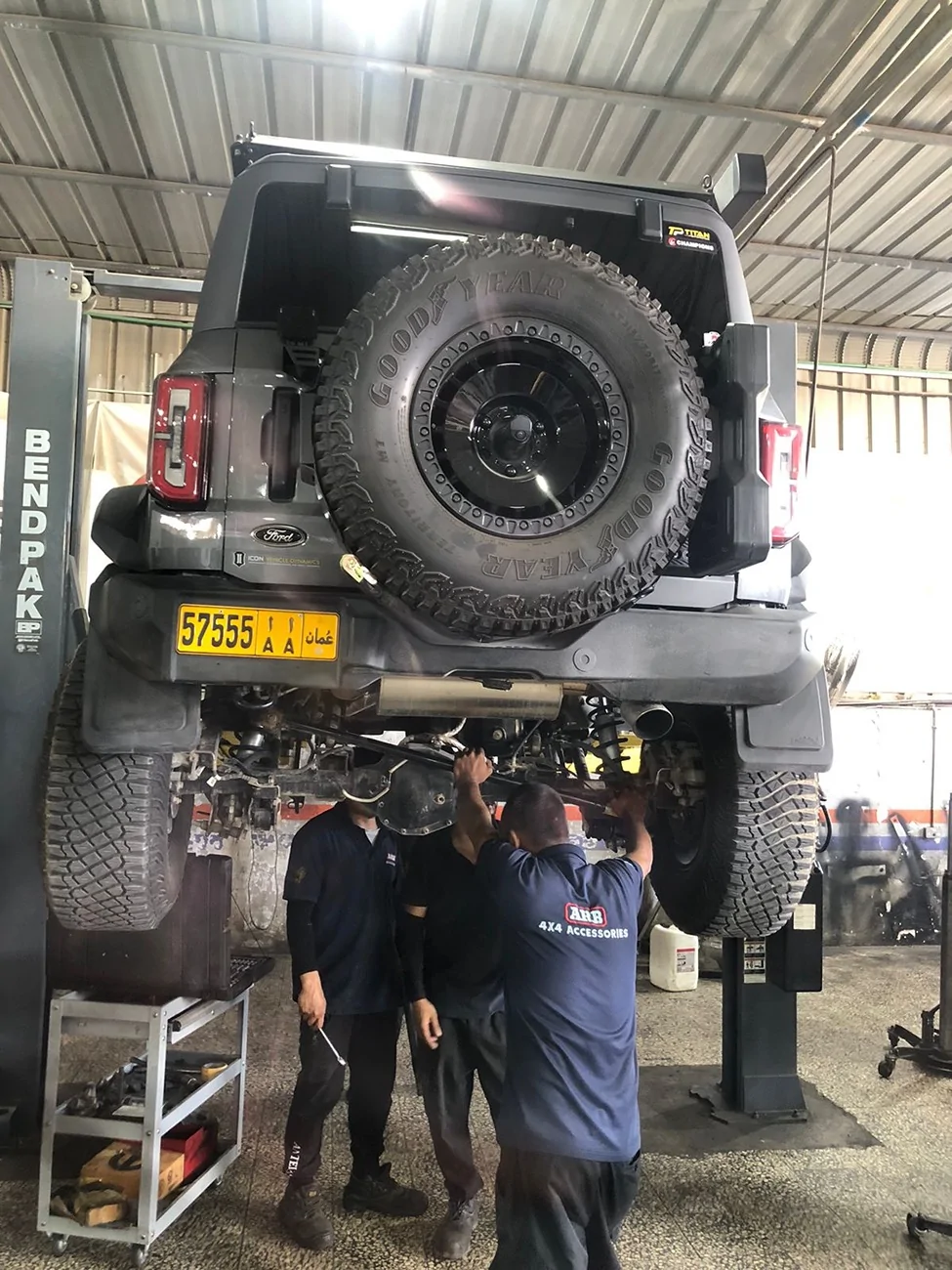

Hi everyone,
I’ve been chasing a clank noise in the rear of my Bronco for quite some time, and after multiple workshops and many replaced parts, the sound is still there. I’m hoping someone here may have experienced something similar or can point me toward something I may have missed.

Dang. That’s annoying. Might be time to try mounting some gopros under there and doing some forklift tests, assuming it’s a suspension shifting issue.
We’ve had the driveline rub against the tank, but it never clanked on us. Also the axle shifting sideways and the swaybar arms making contact with the links then bending/breaking, but that shouldn’t be an issue with the panhard bar still in place.

I tried lifting the car using a lift and putting it down each time with one tire up using bricks. But i did not get the sound, it needs some engine load. Thought about the go-pros but i feet if i get anything using this method it would be purely luck 😅
