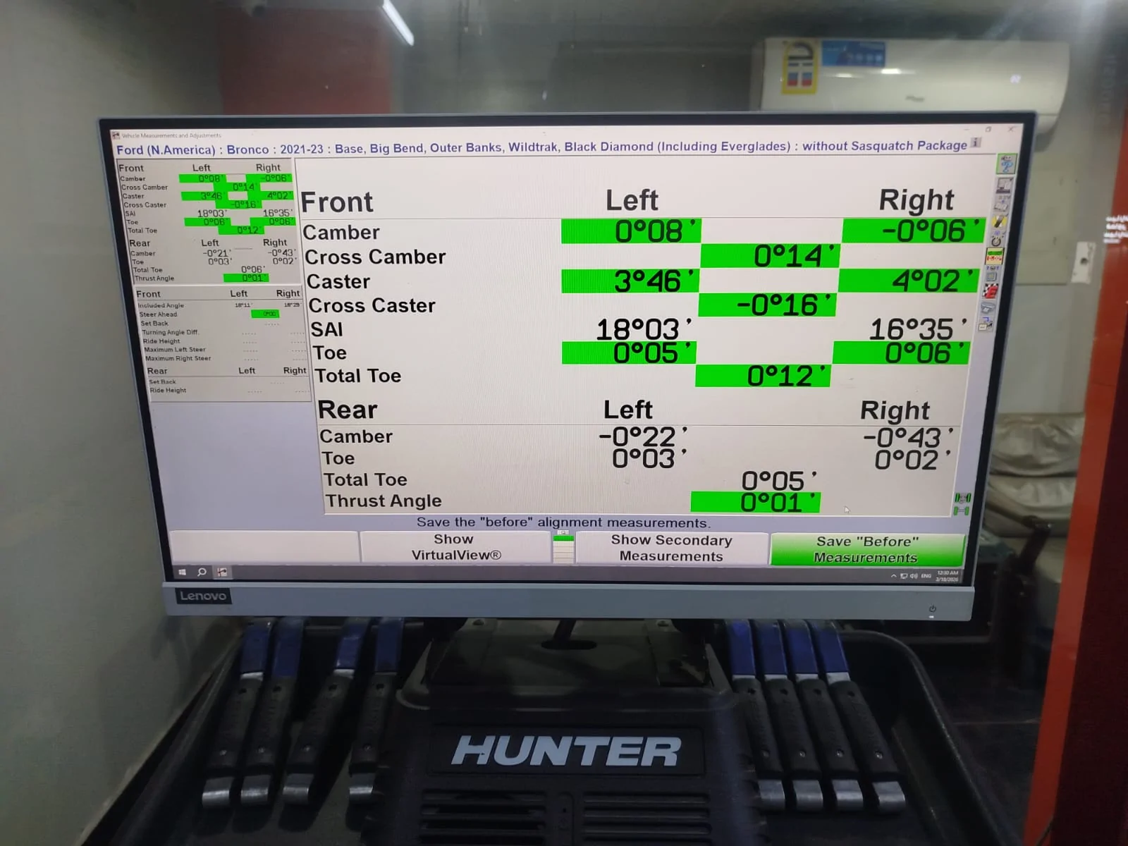

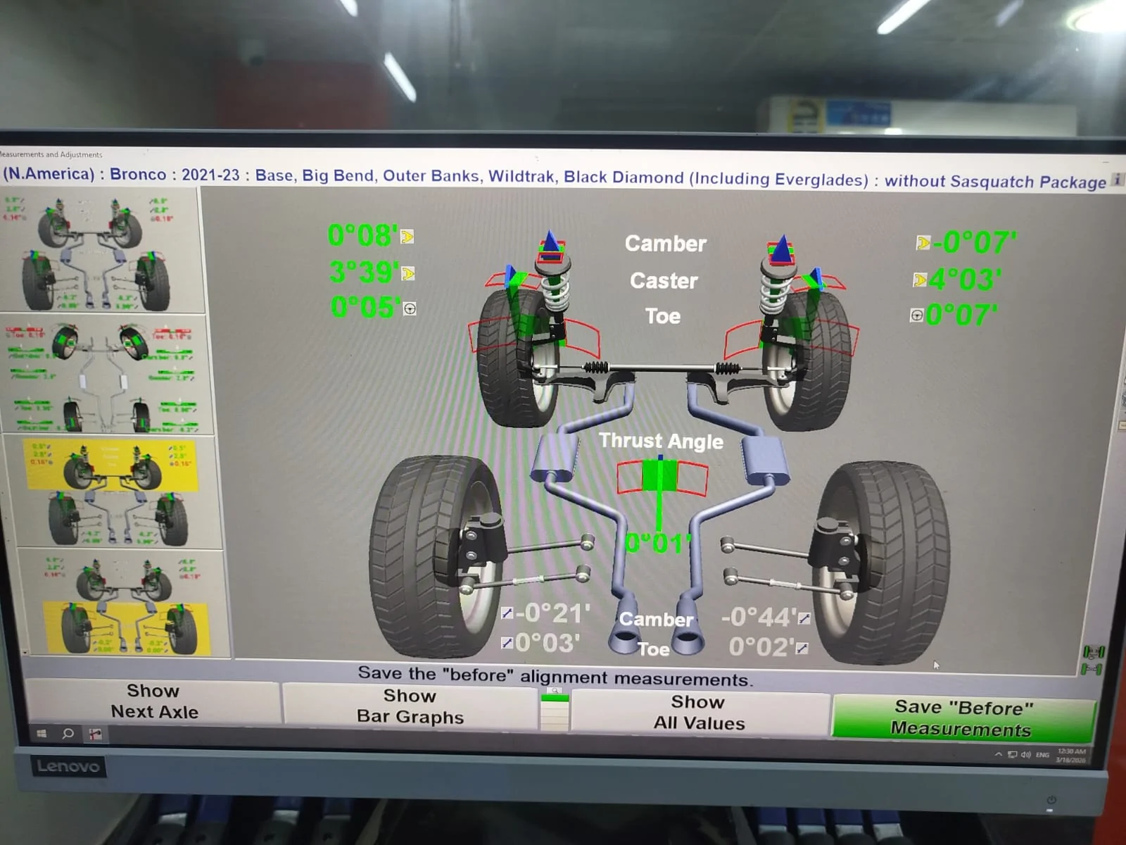

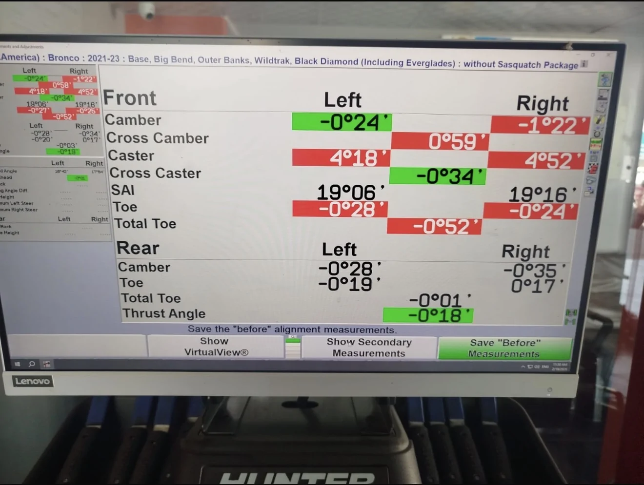

That's pretty much my best guess as well. But honestly fixing an axle housing with a cast iron Center section seems like a bit of a liability to me. Total replacement I feels like it makes the most sense.
As what i have understood from the guys the thrust Angle shows a very minimal bend and it doesnโ€™t affect anything except the tire wear of one of the tires.. we have a lot of shops here that work on this type of damage and even total bend differentialsโ€ฆ even re-building some parts of it, so im not worried a lot in regards of the damage ๐Ÿ˜‡ + I opened up the diff and checked all the parts to check for any damage that could cause the soundโ€ฆ did not find anything..
