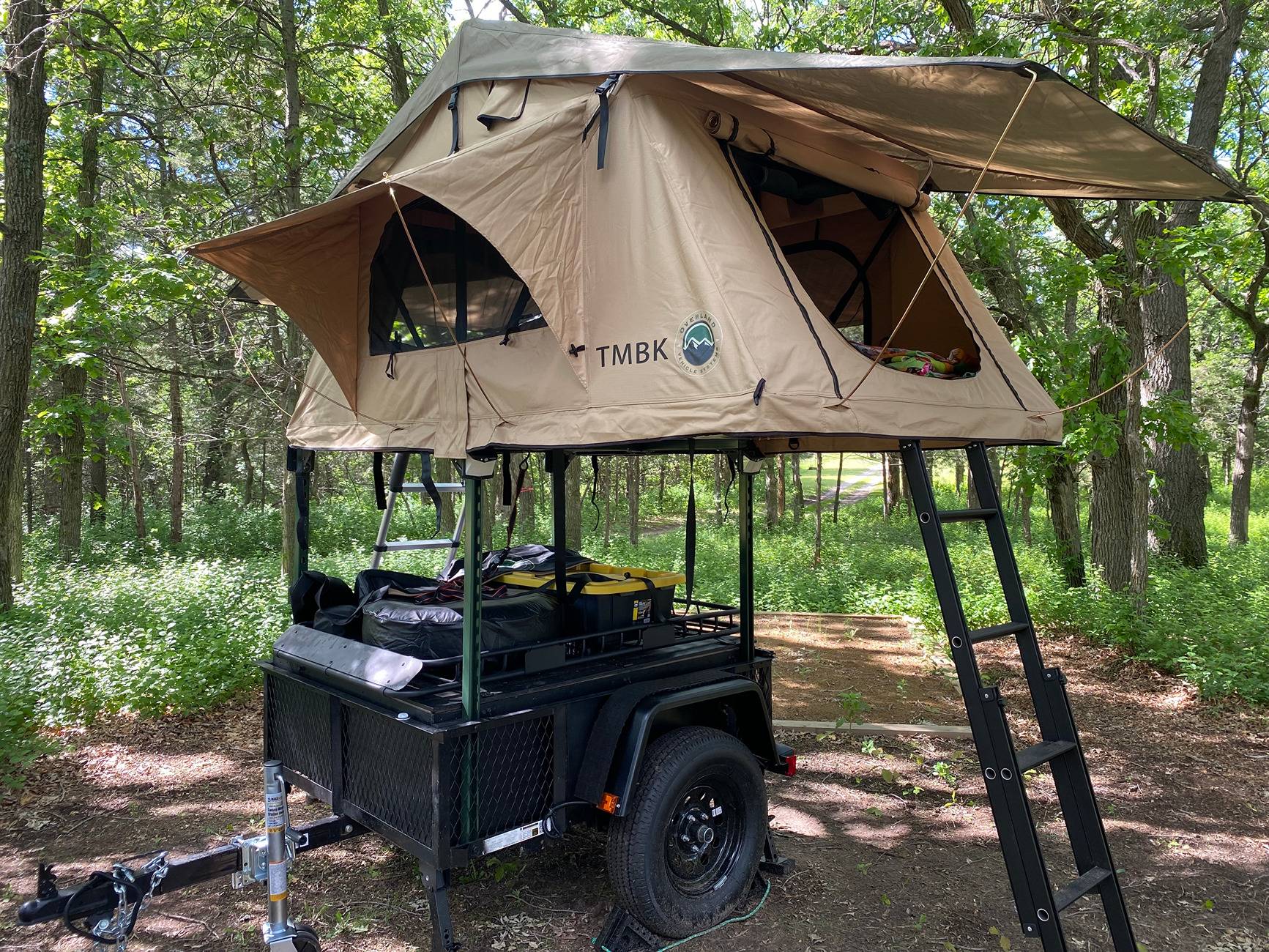

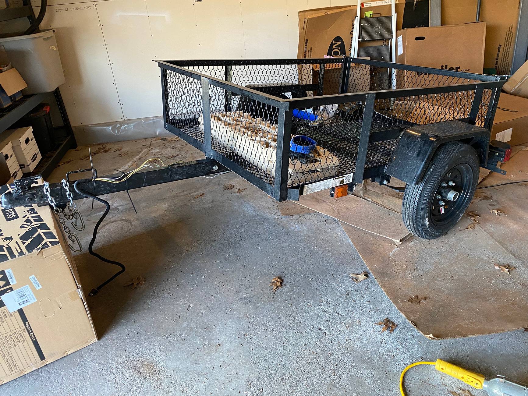

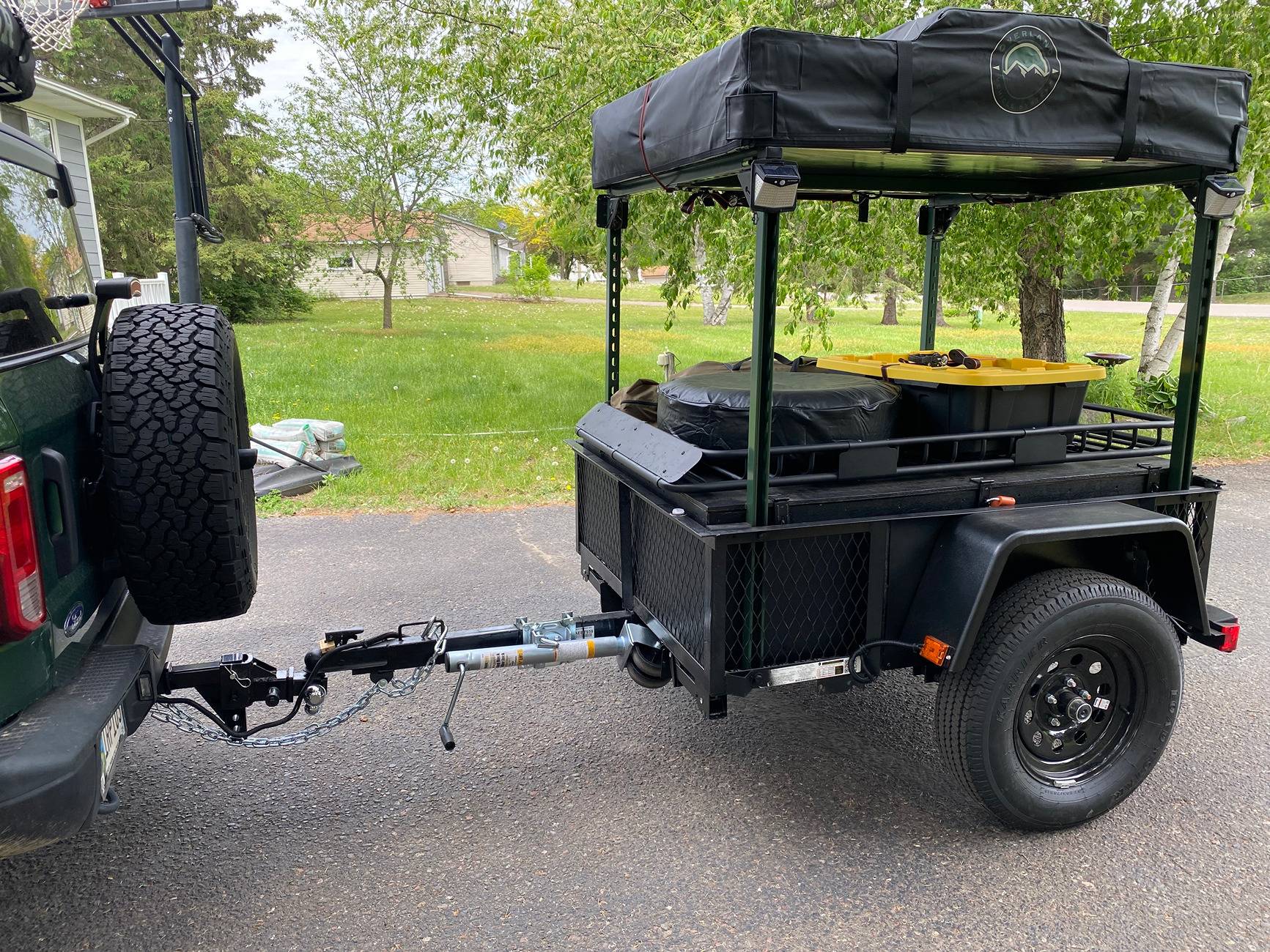

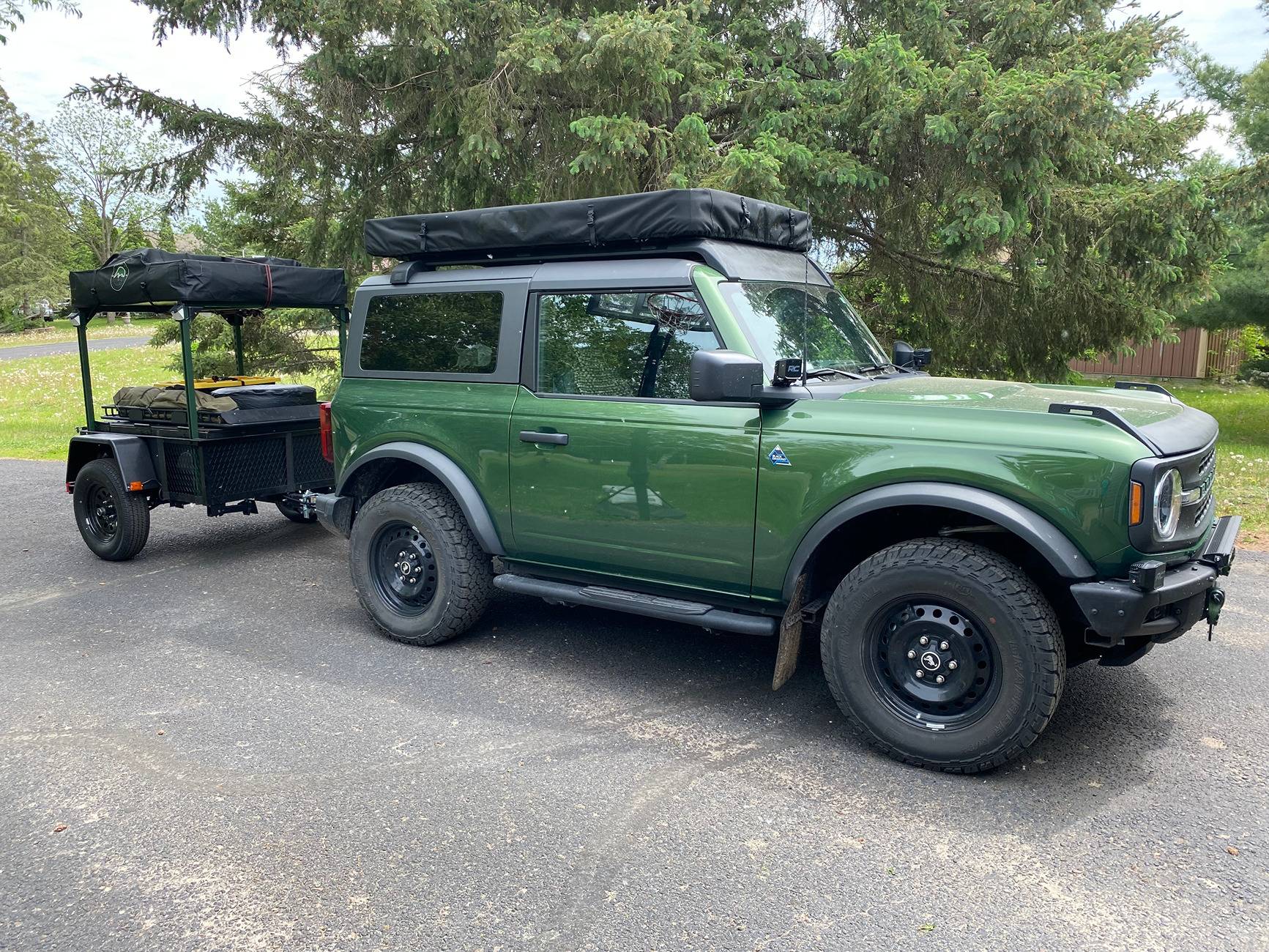

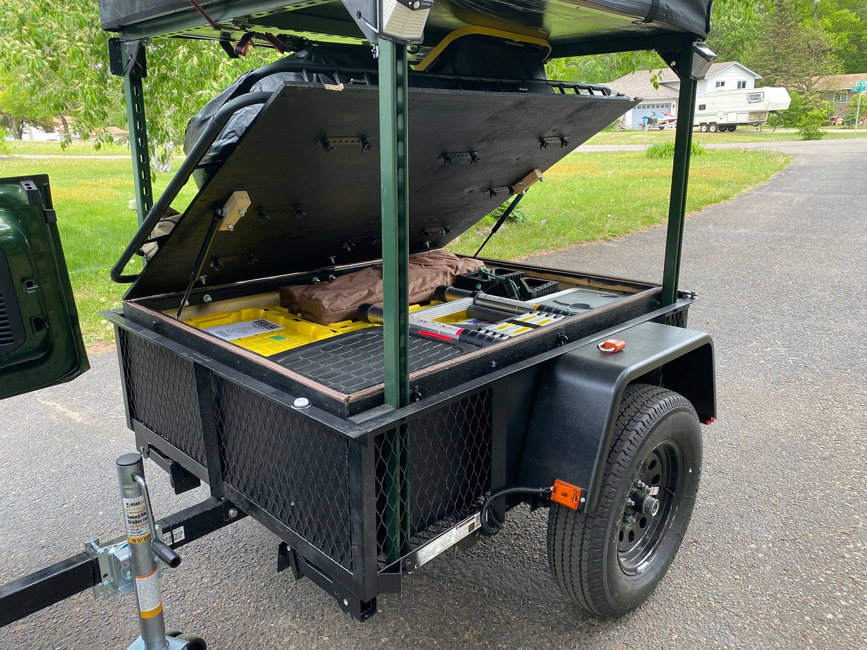

My DIY. Started off as a 4'x5' Carry-On trailer from Lowes.
Ford Bronco Overlanding Camping Trailers trailer1
Removed fenders and 12" wheels/tires. Upgraded fenders and 15" wheels/tires. Built 1/4"-1/2" plywood box. Added cargo basket. Channel strut frame to support the RTT. Added tongue jack and corner jacks for stability. Kind of it in a nutshell. Total cost put into the trailer including the RTT is about $3k ($1100 RTT, $800 trailer).
Ford Bronco Overlanding Camping Trailers campb
Ford Bronco Overlanding Camping Trailers campc
Ford Bronco Overlanding Camping Trailers campa
Ford Bronco Overlanding Camping Trailers camp5
Took it cross country MN-WY-AZ and back, about 4k miles. Total weight with gear was about 1100 lbs. Towed great. No off-roading, pretty much national/state parks. My 2 adult kids were comfortable in the RTT. Works for me and what I'm doing. Can't afford those overland trailers.
I recently relocated the trailer spare to the back of the trailer, freeing up more cargo basket space. Took 3 trips with it this summer.

Wow! Nicely done!!!👍👍👍

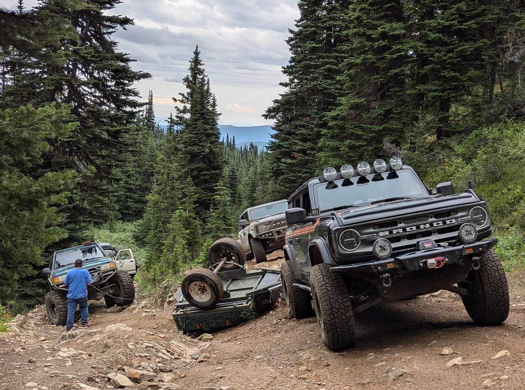

On the popo thing, he's not a troll, just bit a little by the "off roading with a trailer" (that didn't go well for them) which is apparently different than what you're proposing. But really similar sounding...
That response as the 1st post in the tread? C'mon man!
Especially since I was clear the trailer won't see any serious off-roading.
I want the trailer to be off-road capable but it won't really be heading down any serious trails. My plans would be to wheel to an area, set up base camp, wheel that area for the day then return to base camp for the night. Any serious off-roading would be done away from the base camp and the base camp would be setup in an easily accessible area.
I am all for goofing off but there is a time and a place..

Yeah, I get that. I got a couple too-serious replies when I made a joke about a v8 in my post the other day. Kinda gets it going in the wrong direction off the bat.
However, I think overlanding is a better term, or use base camp trailers in the title? It's less loaded than off roading. Hindsight and all, yeah dragging a trailer on a 4/10 or above would suck, as Popo found out. But I'm not sure it was that obvious if you skim the post (which I did, too :whistle: ). TLDR and all. I just looked at the ones you were referencing.
