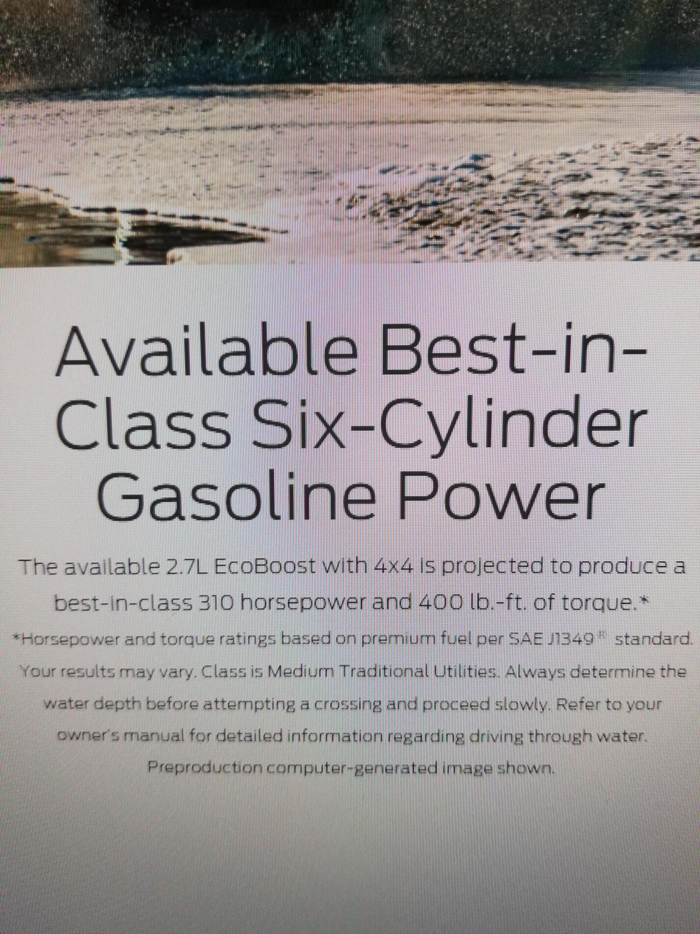

The hp and torque quoted by Ford is with premium fuel so a tune isn't going to require more than you would have already been fueling with. The V6 requires the auto, so factor that cost in as well if you're comparing the numbers.
Neither the 2.3 or 2.7 requires premium fuel "stock". Where did you find that Ford uses higher octane fuel in their engine ratings? Typically, with conservative factory tunes, higher octane does not deliver more power, but I may be missing something. I am assuming auto to auto comparison of cost (personally I want auto either way and if I go OBX, it comes with the trim level). I just looked at the Ranger tune and at 325HP already requires 91 octane. Again, for those that want a manual, I think the tune makes sense and will be a really fun, reliable and capable motor. If you are going auto, the 2.7 seems to make better sense, long term.
