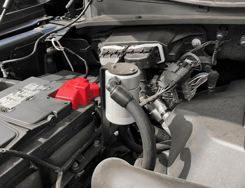

a catch can is tiny. It is smaller than a can of mini coke. Trust me .. there is room and it is an easy install. It will take you less than 10 mins to install it at least the one from JLT.
Going to take a pic of the one in my 2019 Raptor and show you .. brb
JLT Catch Can on 2019 Raptor. It comes with hoses and all the necessary fittings. It actually uses Ford OEM quick connect hoses so literally you twist and pull off. You don't need to cut any hoses as it comes with the correct size. I am sure they will make one for the Bronco in both engines:
That is awesome. I’m going all in on the manual so I’ll have the 2.3L and I’d like a clean install like that!

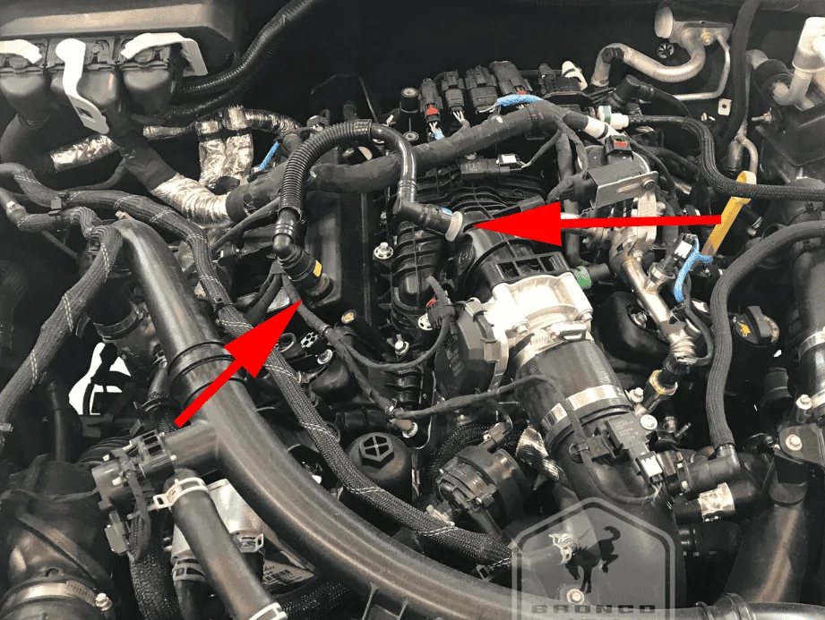

I just installed a catch can on my 2.3L Ranger this weekend. You do not want to ever touch this again. Yes, it was a 5 minute hose swap on the Mustang, but for the 2.3L you have to take off the driver's side wheel, unbolt an engine access panel, disconnect an electrical harness and unclip a bunch of hoses, contort yourself like some circus freak and route the new hoses up through the engine bay from the bottom of the engine / intake manifold. My husband and I are knuckleheads and it took us damn near 4 hours.
That said, a catch can couldn't affect warranty unless you failed to empty it. Only damage directly caused by an aftermarket swap could void a warranty and no serious mechanic could make a claim for something as trivial as a catch can.
I'm dreading it, but this is one of the first mods I will do on my Bronco...
[edit] Here's what you're dealing with. Unless you're an experienced mechanic it's not a 1.5hr job.
