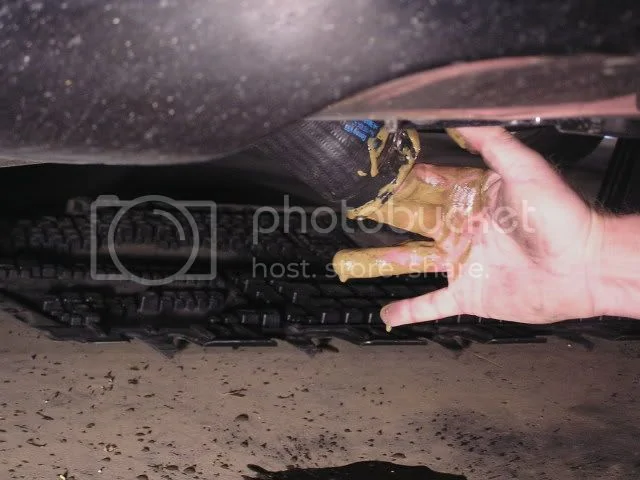

I don’t have a lot of experience with Fords, my last one was a 2000 F250 SD 7.3. You wouldn’t notice a shudder with that beast banging and clattering away.
I did experience the shudder with my 2010 VW Golf TDI. The intercooler would collect oil and moisture from the EGR valve until it filled and blocked the intake side. I’d jump in hit the start button wait while gauges did their sweep and glow plugs warmed up, foot on the brake, hit the button again, and...
instead of nice cold air it would suck up a gulp of sludge, motor would shake like a washing machine off balance, big cloud of steam and vapor out the exhaust. I’m not sure what it was doing to the engine internals but it didn’t feel good.
Ford Bronco Oil Catch Can?? 1616937830285
