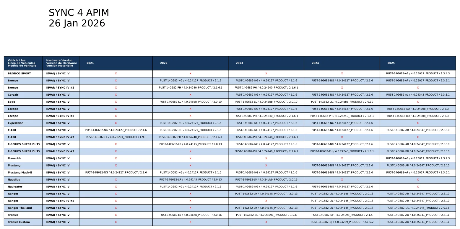

Ford says they cannot see any of my modules or when they last received update. My actual version from the about screen is 4.0.24240 which is current but she said I should be getting other updates My vin is 1FMDE5DH3PLB30648

The people that answer the phones when you call Ford read from a script and are clueless. They 100% can see what modules have pending updates, but they often do not know how to use the resources they have in front of them.
Unfortunately, due to some recent cybersecurity changes that Ford made, I am no longer able to check for pending updates. My PTS access was nerfed and I let my FDRS license expire since Ford is now banning accounts for running VINs through FDRS without being plugged into the vehicle. I think @flip is still able to check for pending updates in PTS. Maybe he will chime in or you can message him.
What I can tell you is that connectivity is working just fine in your truck. OTA history is stored for 180 days on the cloud, and it shows no updates have been sent to you in over 180 days. Also, according to this document from Ford, Sync 24240 is the latest available for your truck. I know this document is not 100% accurate (my F150 is on Sync 25094 and this says 24127 is the latest), but if you are on that Sync, you can't be too far behind. My Bronco Sport that I installed a Sync 4 APIM in is also on Sync 25094.
